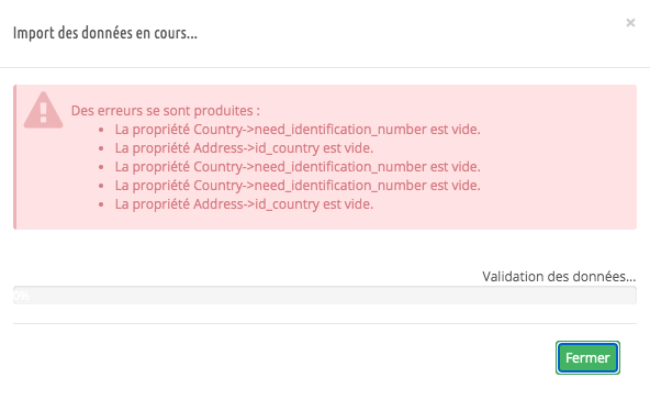

AlexLm Posted November 3, 2020 Author Share Posted November 3, 2020 I successfully uploaded my contacts on Prestashop. I already have the client IDs link to the addresses and orders. I am looking for a way to import my orders in Prestashop. It seems that you are well aware of this subject @Guest , can I do it with ftp ? I also have this issue when I try to import my addresses, do anyone know where it is from ? Link to comment Share on other sites More sharing options...
Guest Posted November 3, 2020 Share Posted November 3, 2020 After all, I wrote that it will not work like this and you will do it your way anyway. I wrote you to put the first line of the CSV file "header" here. If you have it in a language other than English, you have to translate it and then write it here. E.g. the first line is: id;lastname;firstname;email;street;city;country;vat_number;dni_number;phone;....................... Link to comment Share on other sites More sharing options...

AlexLm Posted November 3, 2020 Author Share Posted November 3, 2020 Here is the "header" of my address.csv : Address ID;Alias*;Active (0/1);Customer e-mail*;Customer ID;Manufacturer;Supplier;Company;Lastname*;Firstname*;Address 1*;Address 2;Zipcode*;City*;Country*;State;Other (notes);Phone;Mobile Phone;VAT number;DNI I followed the template of Prestashop. 8 minutes ago, Guest said: Also specify how many csv files you have to import. If you have multiple csv files, please specify what is in them. Are the csv files from another Prestashop? I have to import 2 more csv files : addresses and orders. For the orders csv file, this is my question what should be the headers of the csv file ? Thank you buddy Link to comment Share on other sites More sharing options...
