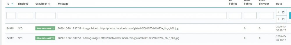

BDer Posted October 30, 2020 Share Posted October 30, 2020 $url = "http://photos.hotelbeds.com/giata/00/001075/001075a_hb_r_001.jpg"; $shops = Shop::getShops(true, null, true); $image = new Image(); $image->id_product = $product->id; $image->position = 1; $image->cover = true; // or false; $image->associateTo($shops); Logger::addLog(date('Y-m-d H:i:s') . ' - Adding Image : ' . $url ,1); if (($image->validateFields(false, true)) === true && ($image->validateFieldsLang(false, true)) === true && $image->add()) { if ($this->copyImg($product->id, $image->id, $url, "products", false)) { Logger::addLog(date('Y-m-d H:i:s') . ' - AdminImportController : ' . $url ,1); } else { Logger::addLog(date('Y-m-d H:i:s') . ' - AdminImportController Failed : ' . $url ,1); $image->delete(); } } Hello, I need your help, I created a module that uses an external API wich provide produts. I am using the following method to trigger my sync: public function hookActionCronJob () and I created a cron.php to trigger the hook (https://www.h-hennes.fr/blog/2017/12/01/prestashop-gestion-des-taches-cron/) My sync is working well and I am able to create the products. Lately I tried to add the images and it doesn't work. The method: $ this-> copyImg ($ product-> id, $ image-> id, $ url, "products", false) seems to crash and my sync stops there. Being in the module, I don't know how to report an error. I have a global try / catch but nothing goes back in the logs, we said that the sync hangs on it and remains blocked. I broke everything down a bit in the lower layers by outputting the methods for "debugging" them and I suspect this method does not work: imagecreatefromjpeg ($ filename); Could you help me by telling me how I can debug or where by telling me where the problem could come from, I'm a little lost ... Thanks in advance, Regards Link to comment Share on other sites More sharing options...

BDer Posted October 30, 2020 Author Share Posted October 30, 2020 Hello, Thank you for your reply. I have not posted the correct version of the above code. Here it is in the screenshot. In fact, the method that causes me problem is the following: AdminImportController :: copyImg I have organized my code as in the example provided and I have the same result. The last line in the logs is "Image Added" and then nothing ... Link to comment Share on other sites More sharing options...
BDer Posted October 30, 2020 Author Share Posted October 30, 2020 UPDATE : If I try this code : https://www.lije-creative.com/prestashop-creer-produit-php/ with this picture for all product : -->http://photos.hotelbeds.com/giata/00/001075/001075a_hb_r_001.jpg<-- It works ! Same code with this picture : -->https://lmbl.lu/mani/img/products/10036.jpg<-- doesn't work ... But if I try to add this picture to the product with the web interface, it works ... Link to comment Share on other sites More sharing options...
