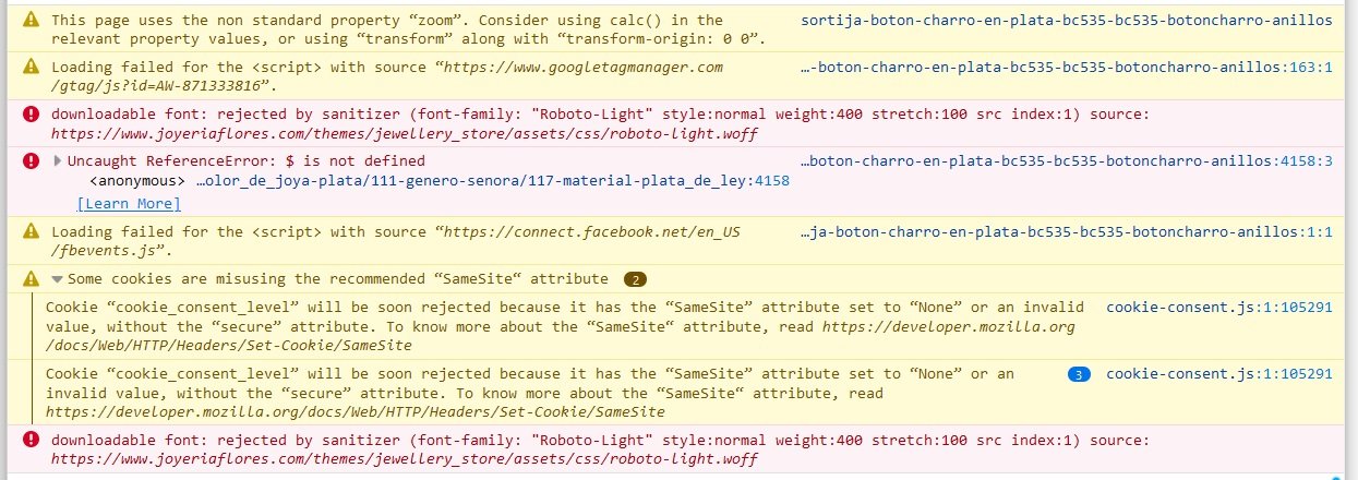

musicmaster Posted October 26, 2020 Share Posted October 26, 2020 Now - when changing the size - I see an error message mentioning line 65 of the file /override/controllers/front/ProductController.php. It looks like some module is giving the problem. The errormessage is "'Can not retrieve the id_product_attribute'". You also still have your javascript errors. See attached image: Link to comment Share on other sites More sharing options...

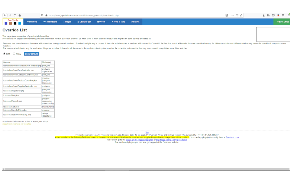

JOSSm Posted October 29, 2020 Author Share Posted October 29, 2020 Ok I have already managed to install Prestatools but I don't really know how it works. What I have to do? Many thanks @musicmaster Link to comment Share on other sites More sharing options...
musicmaster Posted October 29, 2020 Share Posted October 29, 2020 What do you mean with "I have already managed to install Prestatools"? It is hard to say how you should go further when I don't know where you. Did you follow the installation instructions (it is not a module)? Did you look at the video? Link to comment Share on other sites More sharing options...
JOSSm Posted October 29, 2020 Author Share Posted October 29, 2020 Well, I can access it but I don't know how to use it or what I have to do to solve my error Link to comment Share on other sites More sharing options...
musicmaster Posted October 29, 2020 Share Posted October 29, 2020 Under Tools&stats you have the option Override List. Use that Link to comment Share on other sites More sharing options...

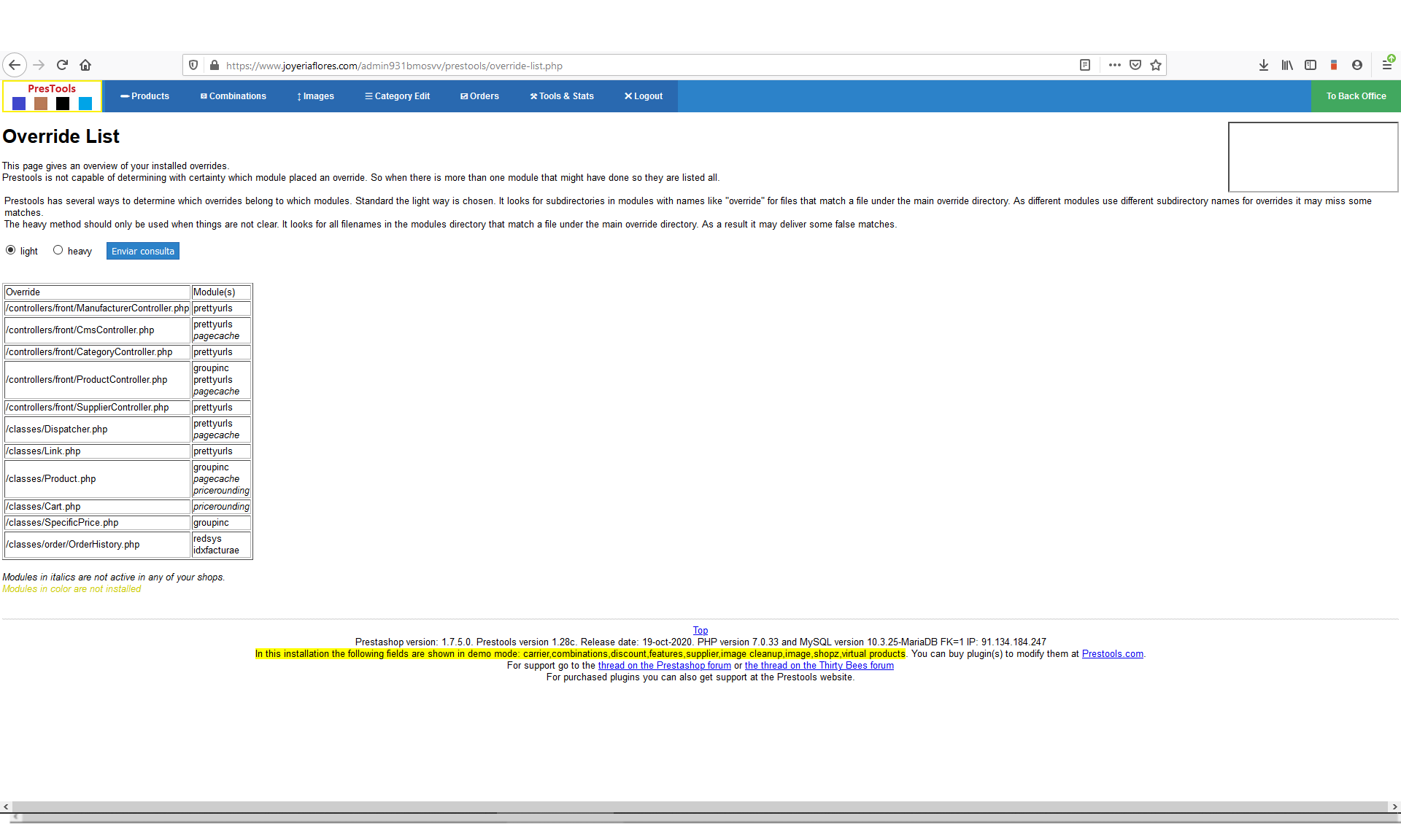

JOSSm Posted October 29, 2020 Author Share Posted October 29, 2020 This is what appears to me. Once again thank you very much @musicmaster I am very lost on this issue Link to comment Share on other sites More sharing options...
musicmaster Posted October 29, 2020 Share Posted October 29, 2020 Yyou made the image so much smaller that I cannot read it Link to comment Share on other sites More sharing options...
JOSSm Posted October 29, 2020 Author Share Posted October 29, 2020 Excuse me Link to comment Share on other sites More sharing options...
musicmaster Posted October 29, 2020 Share Posted October 29, 2020 Ok, so you have three modules that potentially have an override for the productController. That in itself is already potentially problematic as when you have more than one override for the same thing you are supposed to manually combine them. Anyway, try disabling those three modules one by one and then look whether your problem disappears. After each change you should first empty the cache. You might also check the size of the override and the productController.php files in the modules to see which one is present. Link to comment Share on other sites More sharing options...
