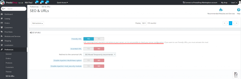

tanmalik786 Posted October 15, 2020 Share Posted October 15, 2020 (edited) Under the 'SEO & URL' section, trying to setup "Friently URL" for the domain - I see a message URL rewriting (mod_rewrite) is not active on your server, or it is not possible to check your server configuration. If you want to use Friendly URLs, you must activate this mod. I am using other domains [most of them using WordPress], so am sure that the mod_rewrite is enabled BUT somehow Prestashop [the only Prestashop install on this server]is not able to check it from the server. Expected behavior The settings on that page are used to recreate the .htaccess in the root folder, which is not being generated due to the problem as stated above. Note: I just checked my cPanel log and found this [15-Oct-2020 03:10:44 US/Eastern] PHP Warning: Use of undefined constant MCRYPT_RIJNDAEL_128 - assumed 'MCRYPT_RIJNDAEL_128' (this will throw an Error in a future version of PHP) in /home/nikpaul/public_html/nikshop/classes/Rijndael.php on line 124 in there, sharing it here as it may be pointing to something meaningful. Edited October 15, 2020 by Tanver (see edit history) Link to comment Share on other sites More sharing options...
musicmaster Posted October 15, 2020 Share Posted October 15, 2020 Running PS 1.6 with PHP 7 gives problems. Unfortunately Prestashop doesn't want to update that version. So you have two option if you want to run PHP 7: either you upgrade to PS 1.7 or you switch to Thirty Bees, a Prestashop clone that continues the 1.6 line and runs ok under PHP 7. Link to comment Share on other sites More sharing options...
Knowband Plugins Posted October 16, 2020 Share Posted October 16, 2020 Regarding the first error i.e. Quote URL rewriting (mod_rewrite) is not active on your server, or it is not possible to check your server configuration. If you want to use Friendly URLs, you must activate this mod. As error clearly says, mod_rewrite (Its a apache module) is not enabled to your server, You need to enable the same on the apache & then need to restart the apache (OR need contact hosting service provider). Quote [15-Oct-2020 03:10:44 US/Eastern] PHP Warning: Use of undefined constant MCRYPT_RIJNDAEL_128 - assumed 'MCRYPT_RIJNDAEL_128' (this will throw an Error in a future version of PHP) in /home/nikpaul/public_html/nikshop/classes/Rijndael.php on line 124 Its due to PHP version compatibility issue as mentioned by musicmaster. Link to comment Share on other sites More sharing options...
