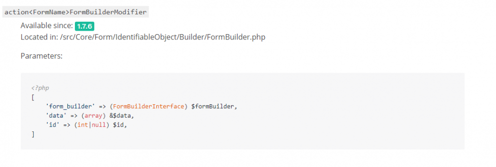

jef933 Posted October 8, 2020 Share Posted October 8, 2020 Hi everyone ! As you can see , I've difficulties to add a custom field into category admin page. More precisely, i found this hook : hookActionCategoryFormBuilderModifier but i can't register it , like it doesn't exist in prestashop. However i find it on presta documentation. on the other hand actionCustomerFormBuilderModifer works correctly Does anybody have already make this ? could you please help me ... Thanks for your help Link to comment Share on other sites More sharing options...
