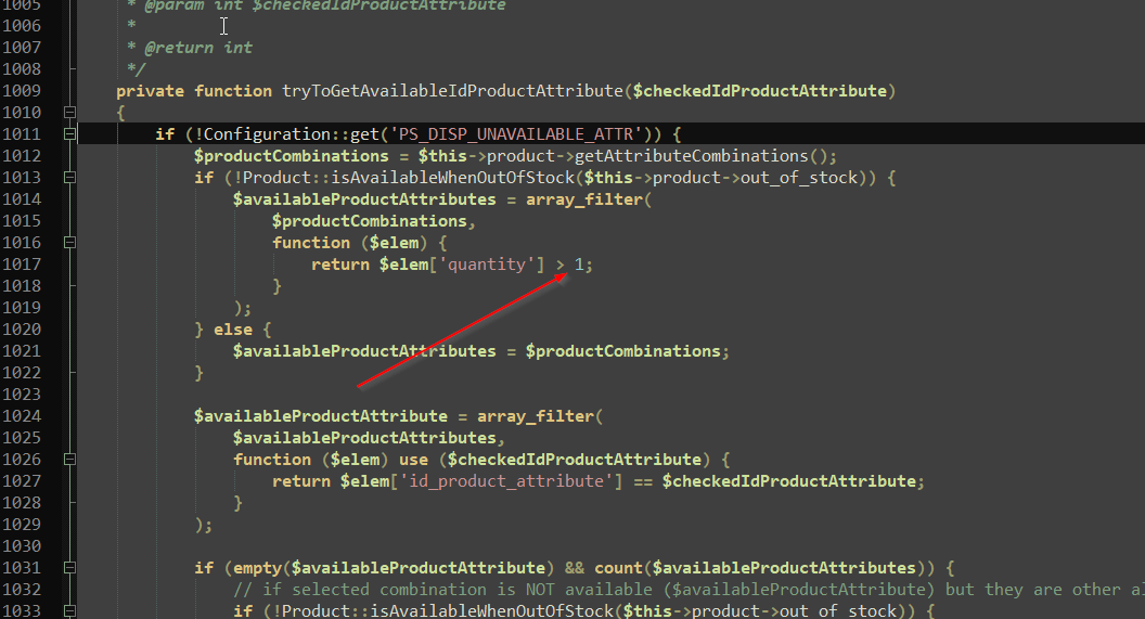

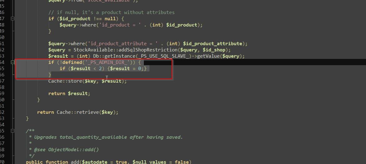

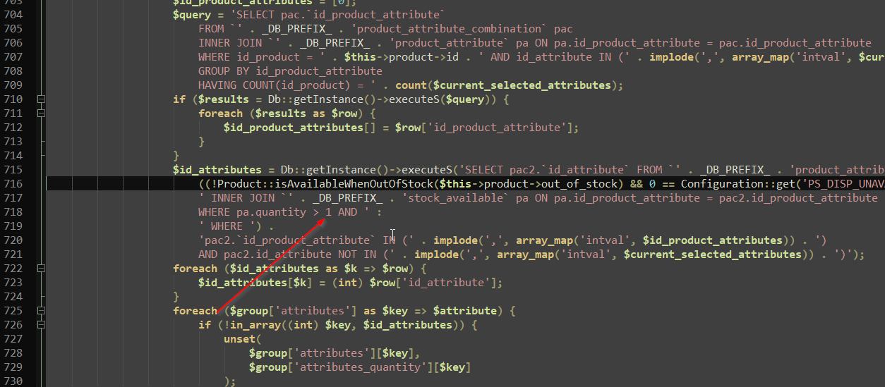

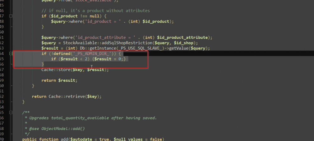

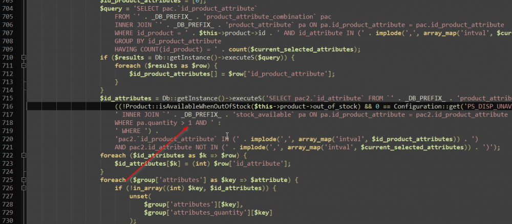

Marie59 Posted September 30, 2022 Share Posted September 30, 2022 Hello, I currently have the same issue. I have a lot of products with low stock and I have to refund my customers because they have been sold meanwhile. Is there a way to automatically disallow the order of low stock level products without disabling them ? I want them to still be visible on the website and to be automatically saleable when stock is > 3 for example. I don't think the plugin mentioned above disallow/allow the order of the products automatically. I can't test it, the demo is not working. Does anyone has a solution or knows a plugin who does that ? Thank you very much ! have a nice day ;) Link to comment Share on other sites More sharing options...
c64girl Posted July 3, 2024 Share Posted July 3, 2024 (edited) On 9/30/2022 at 9:44 AM, Marie59 said: Hello, I currently have the same issue. I have a lot of products with low stock and I have to refund my customers because they have been sold meanwhile. Is there a way to automatically disallow the order of low stock level products without disabling them ? I want them to still be visible on the website and to be automatically saleable when stock is > 3 for example. I don't think the plugin mentioned above disallow/allow the order of the products automatically. I can't test it, the demo is not working. Does anyone has a solution or knows a plugin who does that ? Thank you very much ! have a nice day I make changes that products lower than 2 will be autohide, you can use my fix. I use PS 1.7.8.x Changes: \controllers\front\ProductController.php Changes: \classes\stock\StockAvailable.php *line 454 Edited July 4, 2024 by c64girl (see edit history) Link to comment Share on other sites More sharing options...

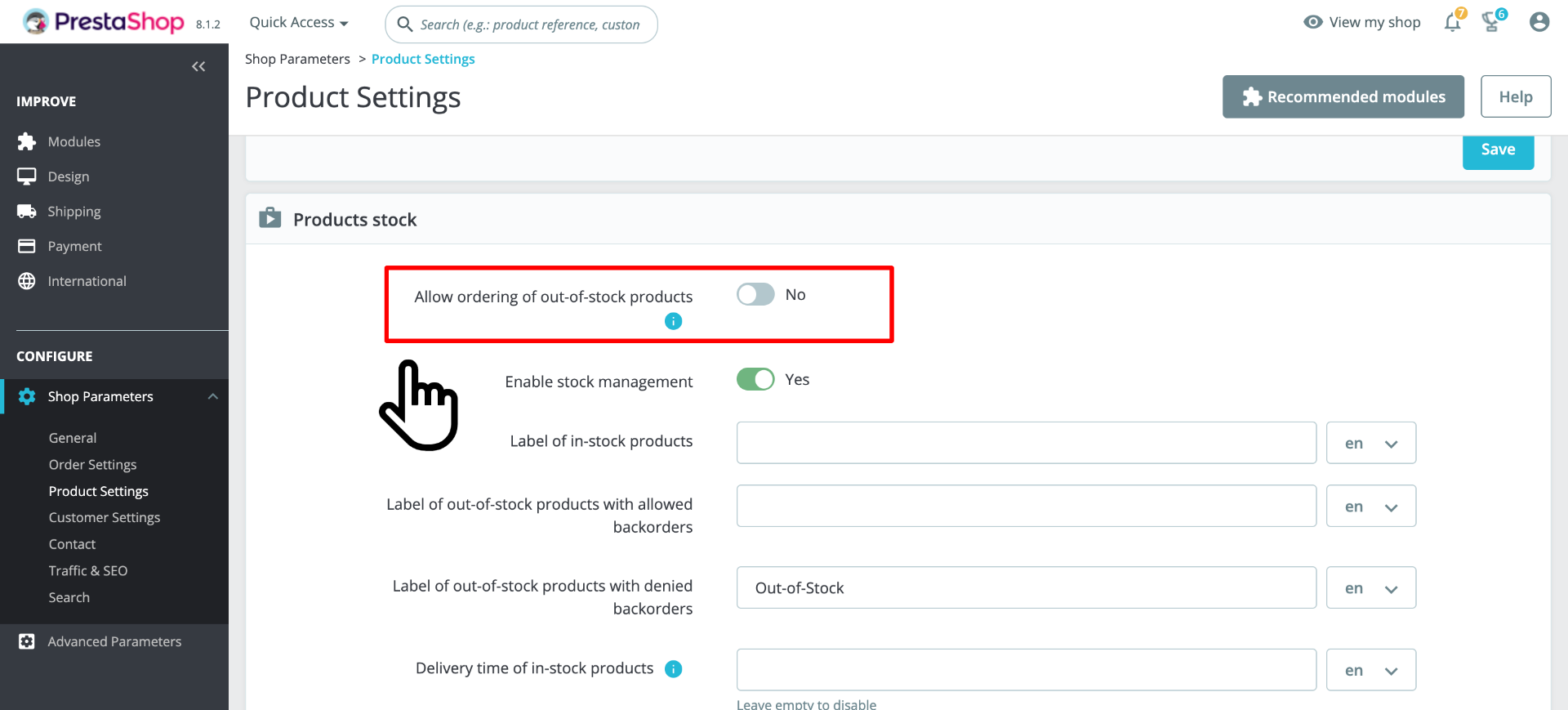

ZHSoft Posted July 3, 2024 Share Posted July 3, 2024 You can set the switch in the background. You can also deliberately write 5 less product quantity, so that when the inventory is 0, you can use the mechanism that comes with Prestashop without purchasing a third-party module. For example, the real inventory is 100, and the online inventory is set to 95. When the customer buys 95, you actually have 5 as a backup, but the customer has been prohibited from placing an order online. Link to comment Share on other sites More sharing options...
c64girl Posted July 3, 2024 Share Posted July 3, 2024 1 hour ago, ZHSoft said: You can set the switch in the background. You can also deliberately write 5 less product quantity, so that when the inventory is 0, you can use the mechanism that comes with Prestashop without purchasing a third-party module. For example, the real inventory is 100, and the online inventory is set to 95. When the customer buys 95, you actually have 5 as a backup, but the customer has been prohibited from placing an order online. Some have ERP linked to prestashop and the quantity are pulled automatically. So your solution may be correct but for people who have a small number of products and no connection to an external ERP. Link to comment Share on other sites More sharing options...
