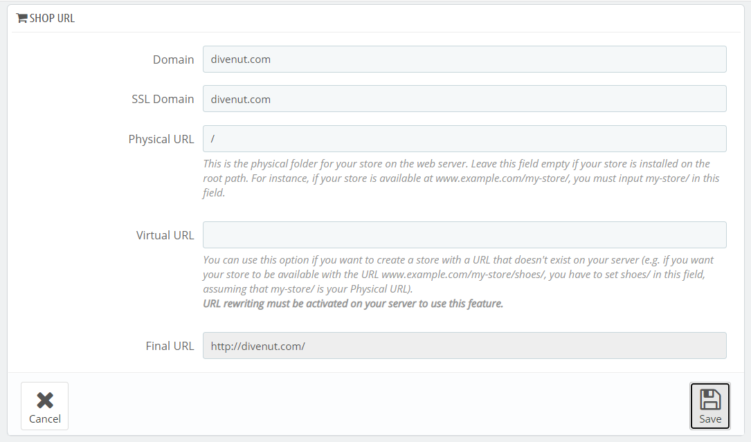

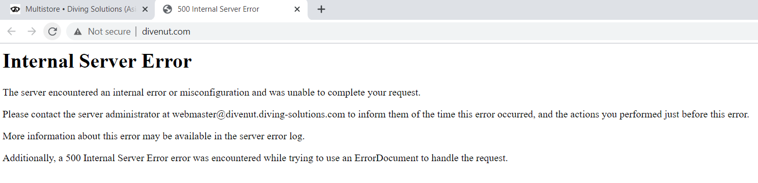

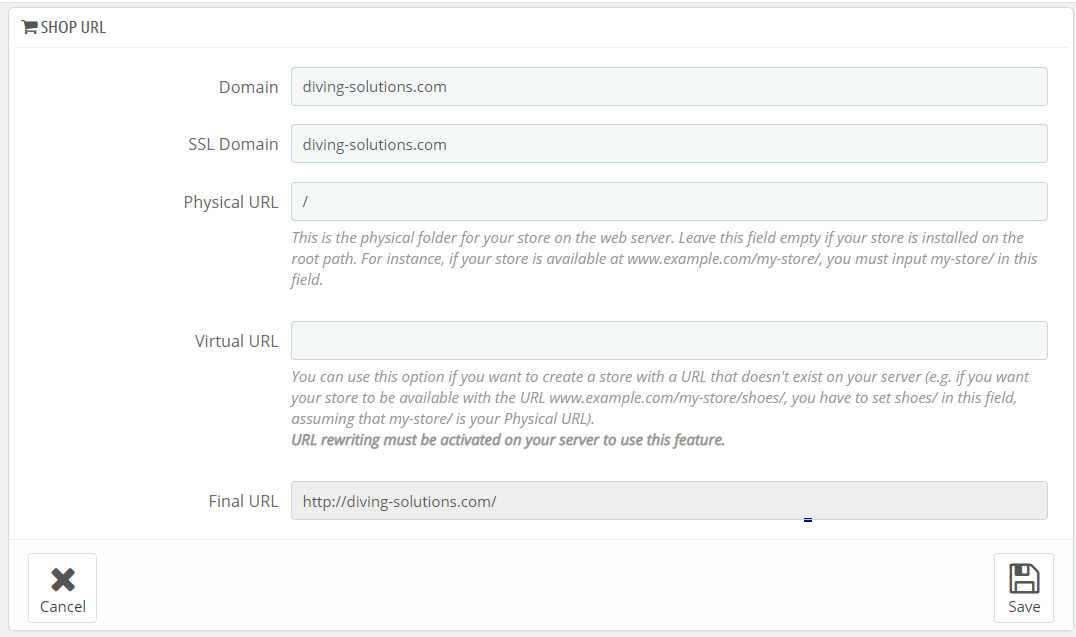

james_sgp Posted September 19, 2020 Share Posted September 19, 2020 I`m having a problem setting up an additional URL for a multistore. I already have 3 setup, and having no problems (diving-solutions.com - capture2.png) but when I try to add divenut.com (capture3.png) I get a 500 server error (capture4.png). Can someone advise what I`m doing wrong, as I`m following the same steps as I used for diving-solutions.com James Link to comment Share on other sites More sharing options...

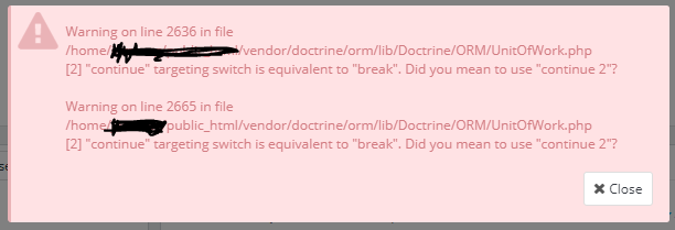

james_sgp Posted September 20, 2020 Author Share Posted September 20, 2020 Nothing in the error logs on the server, if I turn on Debug mode; when i get a warning (attached) in the backend. But I get this on all stores, even the working ones. Front end shows the same 500 error page. Any other suggestions? Link to comment Share on other sites More sharing options...
musicmaster Posted September 20, 2020 Share Posted September 20, 2020 Looks like you are using a newer version of PHP. Prestashop 1.7.6 shouldn't be run with a php version newer than 7.2 Link to comment Share on other sites More sharing options...
