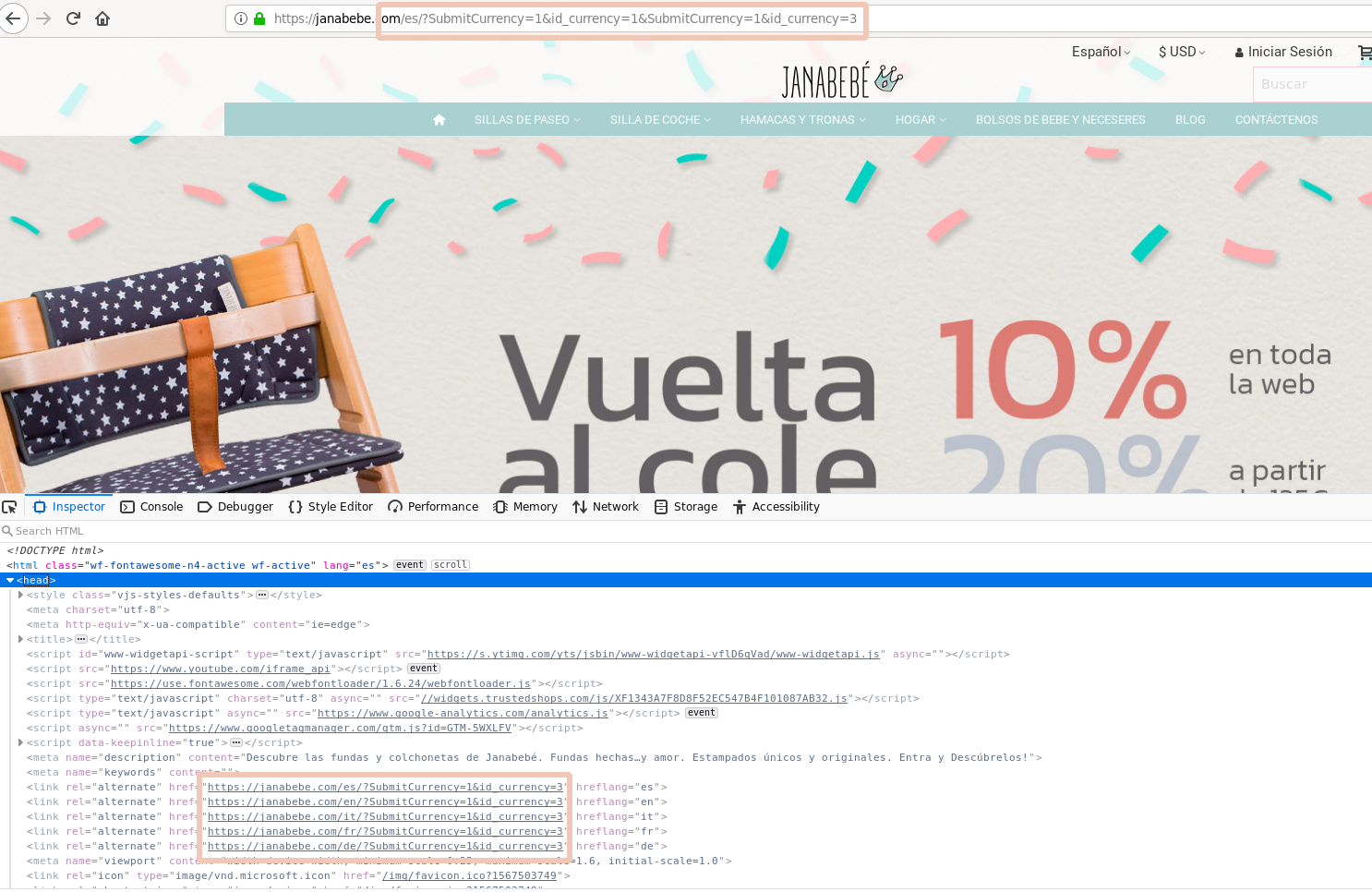

juanrojas Posted September 10, 2020 Share Posted September 10, 2020 hi guys I need help, what happens is the following: Our store sells in US dollars and euros, we have it like this because we are connected to google shopping and according to the documentation we can only campaign in the United States if our store works with dollars When doing the google ads campaign for the United States, the documentation says that we have to remove the currency ( Noindex: / *? id_currency= ) from our robots.txt, so our campaign works fine the problem is prestashop and its url that first when you activate this is not friendly at all. example and second and more serious is that the return link is lost for example in the source code of the page below, it is stated this is the Spanish version of the site "https://janabebe.com/es/?SubmitCurrency=1&id_currency=1" hreflang="es">: https://janabebe.com/es/?SubmitCurrency=1&id_currency=1 You also can see a link, that the English version of a website is located there: https://janabebe.com/en/?SubmitCurrency=1&id_currency=1 If we open the English version of a page and check the source code again, we'll see that the link to the Spanish version of a page this time leads to a different page than the first one: https://janabebe.com/es/?SubmitCurrency=1&%3Bid_currency=1 In the end we're having the discrepancy between 2 URLs: https://janabebe.com/es/?SubmitCurrency=1&id_currency=1 and https://janabebe.com/es/?SubmitCurrency=1&amp%3Bid_currency=1 Such an issue can happen due to poorly written parameters or errors in the source code. And this is why WebSite Auditor shows that you don't have a return link on this page. Is there any solution for this? How should it work with two currencies and that the url works well? Link to comment Share on other sites More sharing options...

juanrojas Posted September 10, 2020 Author Share Posted September 10, 2020 what you tell me is not possible I have entered another topic and they have the same problem, it seems that the problem is from prestashop https://prnt.sc/uesznk https://prnt.sc/uet00f https://prnt.sc/uet43p https://prnt.sc/uet4bc here rather I would say do you know any store that does not do this? Link to comment Share on other sites More sharing options...
_tech Posted September 10, 2020 Share Posted September 10, 2020 This is not "a problem", the SubmitCurrency parameter is send to ps_currencyselector to set the currency of the cookie. This is the native way of Prestashop. Without it, Prestashop is getting the currency from the cookie. No way to set it via "special" friendly url like "/fr/eur" of "/us/usd". Is it what are you searching for ? Anyway, links in your screenshots are generated by head.tpl of themes which use getAlternativeLangsUrl() from FrontController (and Link classes getLanguageLink). If your module override url link generation (it does), it can be tricky to change that. An easy and not very good option could be to set manually theses link in head.tpl but you can't add something in the url to set the currency except SubmitCurrency. Link to comment Share on other sites More sharing options...
juanrojas Posted September 10, 2020 Author Share Posted September 10, 2020 The url can stay like this, I already imagined that it could not be made friendly, the problem is that 2 different urls are being generated for the same currency, this should not be like that, or what is the sense of doing this? in the screenshots I send you can see clearly Link to comment Share on other sites More sharing options...
_tech Posted September 10, 2020 Share Posted September 10, 2020 Two urls for the same currency, not really because %3B is a semicolon, it's just & where (i don't known why), the semicolon is encoded. This %3B doesn't show up in my browser (Firefox / Chrome) in the source of the page But, I saw weird bug in your shop : Url parameters are added twice. (click on EUR, click on USD, click on EUR). (probably an other problem...) Like i said, the easy way is to edit head.tpl template and set urls or/and with a custom module. A good thing would be also to switch currency without changing url by using AJAX request (improve currency selector module). Link to comment Share on other sites More sharing options...

_tech Posted September 10, 2020 Share Posted September 10, 2020 (edited) 1 hour ago, juanrojas said: I have my doubts this has been reported 2 years ago and it seems that they have planned for 1.7.7 For the issue with doublon in url it's very easy to fix, just copy and replace ps_currencyselector.php in the module directory with the one in github : https://raw.githubusercontent.com/jolelievre/ps_currencyselector/1b2422a1ec3e1708778695436d63e89917bbc9e2/ps_currencyselector.php Planned for 1.7.7 but you can already fix it if you want. I tested in a test shop it's working. Edited September 10, 2020 by _tech (see edit history) Link to comment Share on other sites More sharing options...
juanrojas Posted September 14, 2020 Author Share Posted September 14, 2020 I've tried it and it doesn't work, it still works the same Link to comment Share on other sites More sharing options...
_tech Posted September 14, 2020 Share Posted September 14, 2020 1 hour ago, juanrojas said: I've tried it and it doesn't work, it still works the same For the "doublon bug", It works but it's not for the "duplicates" urls. Link to comment Share on other sites More sharing options...
