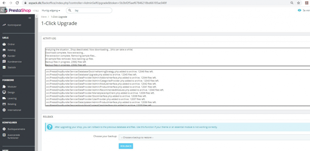

Espack Posted September 7, 2020 Share Posted September 7, 2020 (edited) Hej Jeg prøver at opdatere min webshop.Jeg har prøvet mange gange, så det stopper her. "Analyzing the situation...Shop deactivated. Now downloading... (this can take a while)" hvordan kan jeg løse dette problem? Mvh Serkan Kara Edited September 9, 2020 by Espack (see edit history) Link to comment Share on other sites More sharing options...
Guest Posted September 7, 2020 Share Posted September 7, 2020 Den er jo kommet videre end du skriver.. Den er igang med at tage backup af filer. Hvis den går i stå der, så lav en manuel backup af filer og database, og spring backup over i upgrade processen. Link to comment Share on other sites More sharing options...
