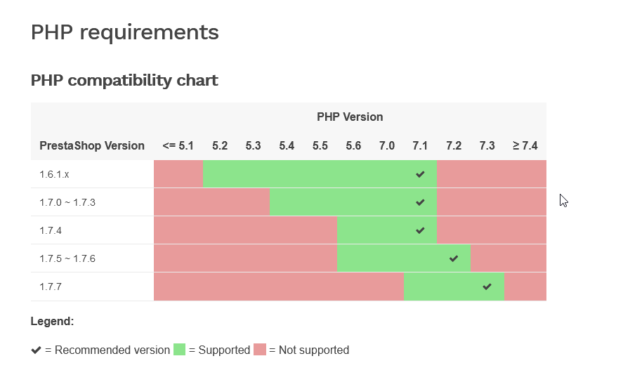

JBW Posted August 27, 2020 Share Posted August 27, 2020 https://devdocs.prestashop.com/1.7/basics/installation/system-requirements/ 1 Link to comment Share on other sites More sharing options...
jemm971 Posted August 28, 2020 Author Share Posted August 28, 2020 Thanks for your help idnovate and JBW. JBW you're right it was a compatibility issue : I went back to php 7.3.21 and I installed Prestashop 1.7.7.0 Now it works ! But after some hours configuring my shop, I got an Error 500 on the backoffice. Noway to access it (but the shop was still working). Finally I was able to access backoffice but only in debug mode (changing PS_MOD_DEV to "true" in config/defines.inc.php files) I googled about that, and finally found a solution : no need to stay in debug mode (which is NOT recommanded) , just delete the /var/cache directoy. I made it, and the backoffice works again ! Hope this can help other users ;)) Link to comment Share on other sites More sharing options...
