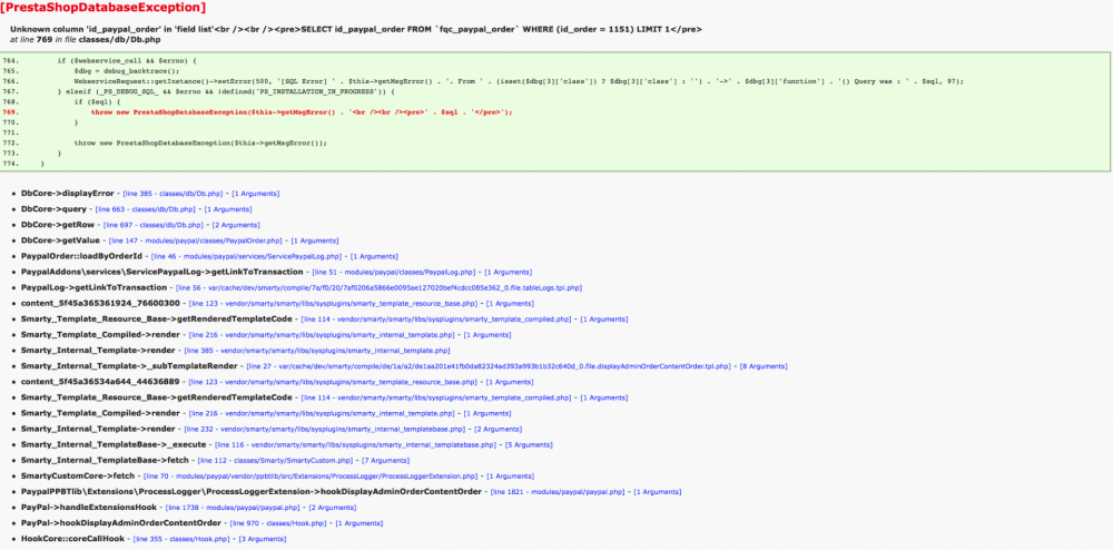

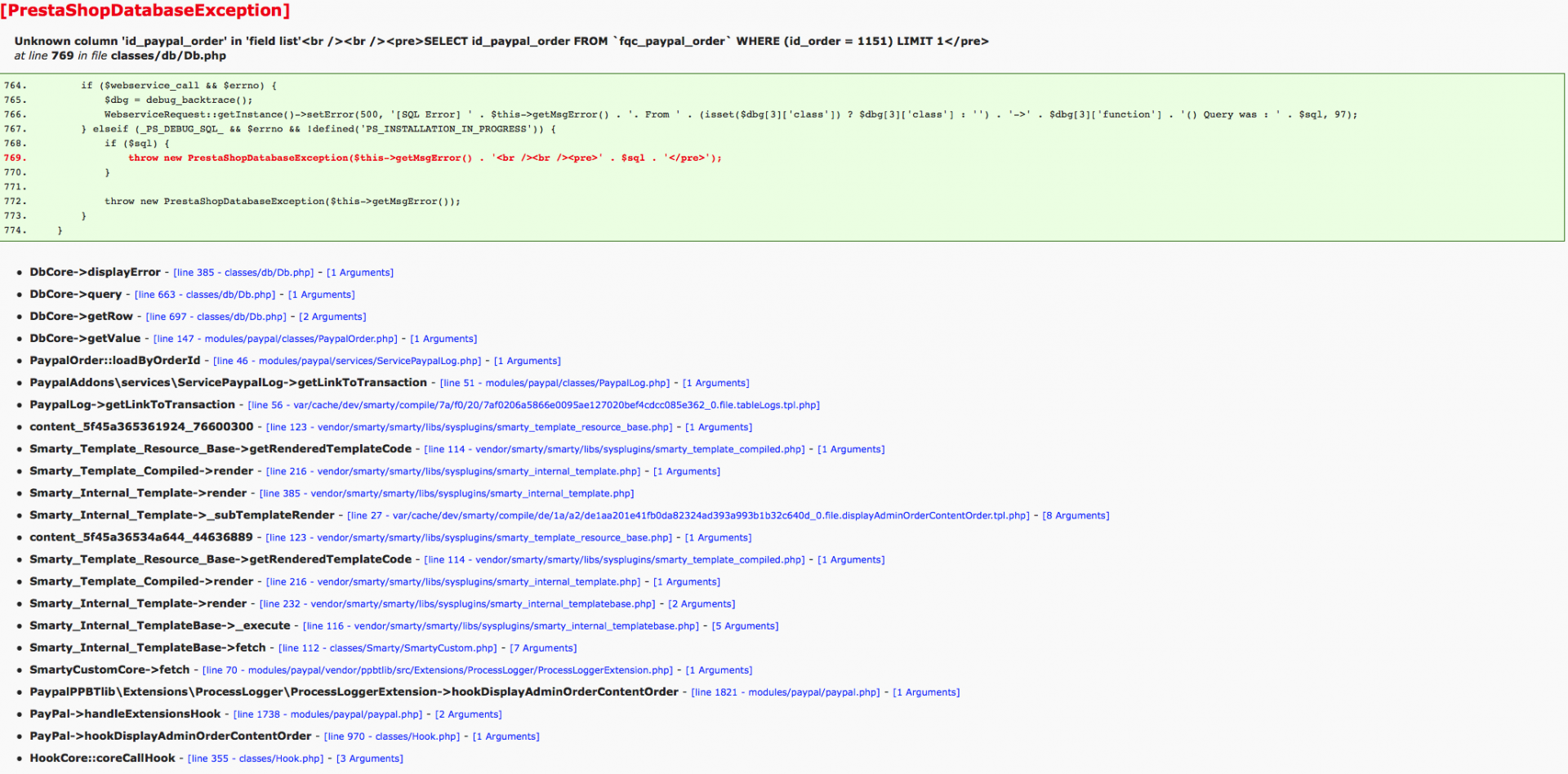

When I enable debugging on the shop I get the following error whenever I do anything with an order or order status:
Unknown column 'id_paypal_order' in 'field list'SELECT id_paypal_order FROM `fqc_paypal_order` WHERE (id_order = 1151) LIMIT 1
at line 769 in file classes/db/Db.php
I posted this issue previously but at that time did not know what it was impacting since when you disable debugging the error does not reappear - so could this be an access/rights issue to the table?  It seems to be something relating to that as the above error is the same regardless as whether the order in the query exists or not - in the above order no 1151 is not in the table however if I try access a record I know exists I get the same error.
Anyone have any pointers on what right/permissions could be possibly missing to cause this?
I have attached a full screen capture of the full error output.
Thanks
