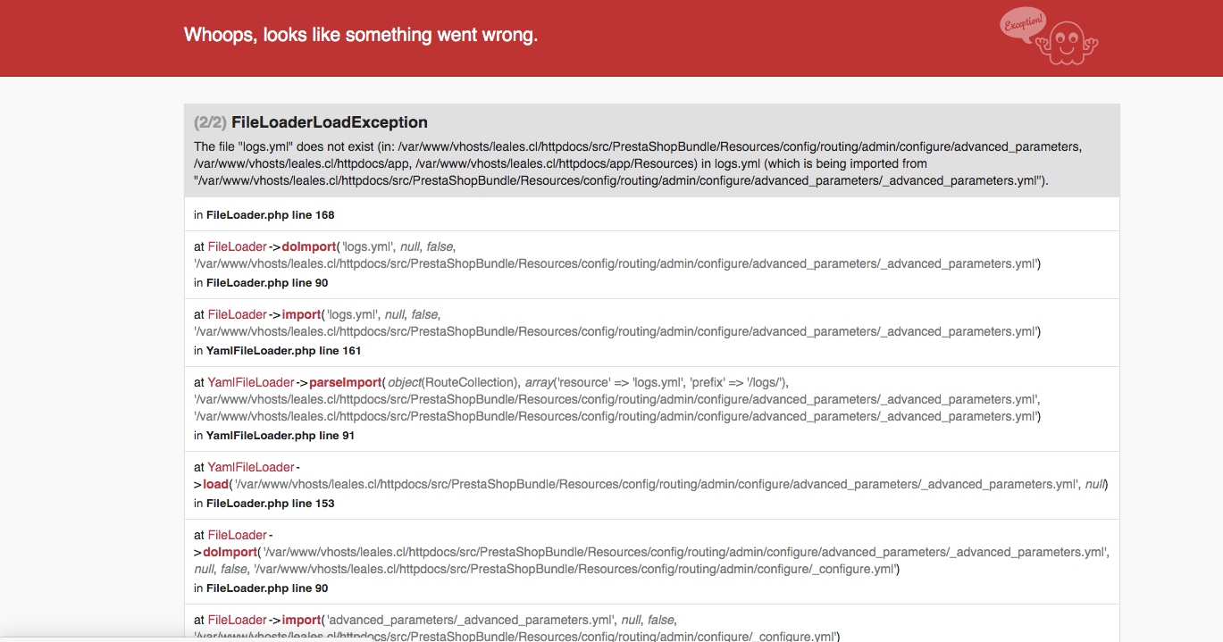

carlalealrojas Posted August 17, 2020 Author Share Posted August 17, 2020 thanks musicmaster! I deleted var/cache directory but now I have this issue in my backoffice page (2/2) FileLoaderLoadException The file "logs.yml" does not exist (in: /var/www/vhosts/leales.cl/httpdocs/src/PrestaShopBundle/Resources/config/routing/admin/configure/advanced_parameters, /var/www/vhosts/leales.cl/httpdocs/app, /var/www/vhosts/leales.cl/httpdocs/app/Resources) in logs.yml (which is being imported from "/var/www/vhosts/leales.cl/httpdocs/src/PrestaShopBundle/Resources/config/routing/admin/configure/advanced_parameters/_advanced_parameters.yml"). in FileLoader.php line 168 at FileLoader->doImport('logs.yml', null, false, '/var/www/vhosts/leales.cl/httpdocs/src/PrestaShopBundle/Resources/config/routing/admin/configure/advanced_parameters/_advanced_parameters.yml')in FileLoader.php line 90 at FileLoader->import('logs.yml', null, false, '/var/www/vhosts/leales.cl/httpdocs/src/PrestaShopBundle/Resources/config/routing/admin/configure/advanced_parameters/_advanced_parameters.yml')in YamlFileLoader.php line 161 at YamlFileLoader->parseImport(object(RouteCollection), array('resource' => 'logs.yml', 'prefix' => '/logs/'), '/var/www/vhosts/leales.cl/httpdocs/src/PrestaShopBundle/Resources/config/routing/admin/configure/advanced_parameters/_advanced_parameters.yml', '/var/www/vhosts/leales.cl/httpdocs/src/PrestaShopBundle/Resources/config/routing/admin/configure/advanced_parameters/_advanced_parameters.yml')in YamlFileLoader.php line 91 at YamlFileLoader->load('/var/www/vhosts/leales.cl/httpdocs/src/PrestaShopBundle/Resources/config/routing/admin/configure/advanced_parameters/_advanced_parameters.yml', null)in FileLoader.php line 153 at FileLoader->doImport('/var/www/vhosts/leales.cl/httpdocs/src/PrestaShopBundle/Resources/config/routing/admin/configure/advanced_parameters/_advanced_parameters.yml', null, false, '/var/www/vhosts/leales.cl/httpdocs/src/PrestaShopBundle/Resources/config/routing/admin/configure/_configure.yml')in FileLoader.php line 90 at FileLoader->import('advanced_parameters/_advanced_parameters.yml', null, false, '/var/www/vhosts/leales.cl/httpdocs/src/PrestaShopBundle/Resources/config/routing/admin/configure/_configure.yml')in YamlFileLoader.php line 161 at YamlFileLoader->parseImport(object(RouteCollection), array('resource' => 'advanced_parameters/_advanced_parameters.yml', 'prefix' => '/advanced/'), '/var/www/vhosts/leales.cl/httpdocs/src/PrestaShopBundle/Resources/config/routing/admin/configure/_configure.yml', '/var/www/vhosts/leales.cl/httpdocs/src/PrestaShopBundle/Resources/config/routing/admin/configure/_configure.yml')in YamlFileLoader.php line 91 at YamlFileLoader->load('/var/www/vhosts/leales.cl/httpdocs/src/PrestaShopBundle/Resources/config/routing/admin/configure/_configure.yml', null)in FileLoader.php line 153 at FileLoader->doImport('/var/www/vhosts/leales.cl/httpdocs/src/PrestaShopBundle/Resources/config/routing/admin/configure/_configure.yml', null, false, '/var/www/vhosts/leales.cl/httpdocs/src/PrestaShopBundle/Resources/config/routing/admin.yml')in FileLoader.php line 90 at FileLoader->import('admin/configure/_configure.yml', null, false, '/var/www/vhosts/leales.cl/httpdocs/src/PrestaShopBundle/Resources/config/routing/admin.yml')in YamlFileLoader.php line 161 at YamlFileLoader->parseImport(object(RouteCollection), array('resource' => 'admin/configure/_configure.yml', 'prefix' => '/configure'), '/var/www/vhosts/leales.cl/httpdocs/src/PrestaShopBundle/Resources/config/routing/admin.yml', '/var/www/vhosts/leales.cl/httpdocs/src/PrestaShopBundle/Resources/config/routing/admin.yml')in YamlFileLoader.php line 91 at YamlFileLoader->load('/var/www/vhosts/leales.cl/httpdocs/src/PrestaShopBundle/Resources/config/routing/admin.yml', null)in FileLoader.php line 153 at FileLoader->doImport('/var/www/vhosts/leales.cl/httpdocs/src/PrestaShopBundle/Resources/config/routing/admin.yml', null, false, '/var/www/vhosts/leales.cl/httpdocs/src/PrestaShopBundle/Resources/config/routing.yml')in FileLoader.php line 90 at FileLoader->import('@PrestaShopBundle/Resources/config/routing/admin.yml', null, false, '/var/www/vhosts/leales.cl/httpdocs/src/PrestaShopBundle/Resources/config/routing.yml')in YamlFileLoader.php line 161 at YamlFileLoader->parseImport(object(RouteCollection), array('resource' => '@PrestaShopBundle/Resources/config/routing/admin.yml'), '/var/www/vhosts/leales.cl/httpdocs/src/PrestaShopBundle/Resources/config/routing.yml', '/var/www/vhosts/leales.cl/httpdocs/src/PrestaShopBundle/Resources/config/routing.yml')in YamlFileLoader.php line 91 at YamlFileLoader->load('/var/www/vhosts/leales.cl/httpdocs/src/PrestaShopBundle/Resources/config/routing.yml', null)in FileLoader.php line 153 at FileLoader->doImport('/var/www/vhosts/leales.cl/httpdocs/src/PrestaShopBundle/Resources/config/routing.yml', null, false, '/var/www/vhosts/leales.cl/httpdocs/app/config/routing.yml')in FileLoader.php line 90 at FileLoader->import('@PrestaShopBundle/Resources/config/routing.yml', null, false, '/var/www/vhosts/leales.cl/httpdocs/app/config/routing.yml')in YamlFileLoader.php line 161 at YamlFileLoader->parseImport(object(RouteCollection), array('resource' => '@PrestaShopBundle/Resources/config/routing.yml'), '/var/www/vhosts/leales.cl/httpdocs/app/config/routing.yml', '/var/www/vhosts/leales.cl/httpdocs/app/config/routing.yml')in YamlFileLoader.php line 91 at YamlFileLoader->load('/var/www/vhosts/leales.cl/httpdocs/app/config/routing.yml', null)in FileLoader.php line 153 at FileLoader->doImport('/var/www/vhosts/leales.cl/httpdocs/app/config/routing.yml', null, false, '/var/www/vhosts/leales.cl/httpdocs/app/config/routing_dev.yml')in FileLoader.php line 90 at FileLoader->import('routing.yml', null, false, '/var/www/vhosts/leales.cl/httpdocs/app/config/routing_dev.yml')in YamlFileLoader.php line 161 at YamlFileLoader->parseImport(object(RouteCollection), array('resource' => 'routing.yml'), '/var/www/vhosts/leales.cl/httpdocs/app/config/routing_dev.yml', '/var/www/vhosts/leales.cl/httpdocs/app/config/routing_dev.yml')in YamlFileLoader.php line 91 at YamlFileLoader->load('/var/www/vhosts/leales.cl/httpdocs/app/config/routing_dev.yml', null)in DelegatingLoader.php line 40 at DelegatingLoader->load('/var/www/vhosts/leales.cl/httpdocs/app/config/routing_dev.yml', null)in DelegatingLoader.php line 70 at DelegatingLoader->load('/var/www/vhosts/leales.cl/httpdocs/app/config/routing_dev.yml', null)in Router.php line 56 at Router->getRouteCollection()in Router.php line 371 at Router->getMatcherDumperInstance()in Router.php line 289 at Router->Symfony\Component\Routing\{closure}(object(ResourceCheckerConfigCache))in ResourceCheckerConfigCacheFactory.php line 43 at ResourceCheckerConfigCacheFactory->cache('/var/www/vhosts/leales.cl/httpdocs/var/cache/dev/appDevDebugProjectContainerUrlMatcher.php', object(Closure))in Router.php line 302 at Router->getMatcher()in Router.php line 248 at Router->match('/admin564xegmko/index.php')in LegacyUrlConverter.php line 243 at LegacyUrlConverter->checkAlreadyMatchingRoute('/admin564xegmko/index.php?controller=AdminLogin&token=4a8c0a262ce55530c6f674c4c7aa198a&redirect=AdminTranslations')in LegacyUrlConverter.php line 134 at LegacyUrlConverter->convertByRequest(object(Request))in LegacyUrlListener.php line 62 at LegacyUrlListener->onKernelRequest(object(GetResponseEvent), 'kernel.request', object(TraceableEventDispatcher))in WrappedListener.php line 115 at WrappedListener->__invoke(object(GetResponseEvent), 'kernel.request', object(TraceableEventDispatcher))in EventDispatcher.php line 212 at EventDispatcher->doDispatch(array(object(WrappedListener), object(WrappedListener), object(WrappedListener), object(WrappedListener), object(WrappedListener), object(WrappedListener), object(WrappedListener), object(WrappedListener), object(WrappedListener), object(WrappedListener), object(WrappedListener), object(WrappedListener), object(WrappedListener), object(WrappedListener)), 'kernel.request', object(GetResponseEvent))in EventDispatcher.php line 44 at EventDispatcher->dispatch('kernel.request', object(GetResponseEvent))in TraceableEventDispatcher.php line 143 at TraceableEventDispatcher->dispatch('kernel.request', object(GetResponseEvent))in HttpKernel.php line 127 at HttpKernel->handleRaw(object(Request), 1)in HttpKernel.php line 68 at HttpKernel->handle(object(Request), 1, false)in Kernel.php line 200 at Kernel->handle(object(Request), 1, false)in index.php line 86 (1/2) FileLocatorFileNotFoundException The file "logs.yml" does not exist (in: /var/www/vhosts/leales.cl/httpdocs/src/PrestaShopBundle/Resources/config/routing/admin/configure/advanced_parameters, /var/www/vhosts/leales.cl/httpdocs/app, /var/www/vhosts/leales.cl/httpdocs/app/Resources). in FileLocator.php line 71 at FileLocator->locate('logs.yml', '/var/www/vhosts/leales.cl/httpdocs/src/PrestaShopBundle/Resources/config/routing/admin/configure/advanced_parameters', false)in FileLocator.php line 52 at FileLocator->locate('logs.yml', '/var/www/vhosts/leales.cl/httpdocs/src/PrestaShopBundle/Resources/config/routing/admin/configure/advanced_parameters', false)in FileLoader.php line 136 at FileLoader->doImport('logs.yml', null, false, '/var/www/vhosts/leales.cl/httpdocs/src/PrestaShopBundle/Resources/config/routing/admin/configure/advanced_parameters/_advanced_parameters.yml')in FileLoader.php line 90 at FileLoader->import('logs.yml', null, false, '/var/www/vhosts/leales.cl/httpdocs/src/PrestaShopBundle/Resources/config/routing/admin/configure/advanced_parameters/_advanced_parameters.yml')in YamlFileLoader.php line 161 at YamlFileLoader->parseImport(object(RouteCollection), array('resource' => 'logs.yml', 'prefix' => '/logs/'), '/var/www/vhosts/leales.cl/httpdocs/src/PrestaShopBundle/Resources/config/routing/admin/configure/advanced_parameters/_advanced_parameters.yml', '/var/www/vhosts/leales.cl/httpdocs/src/PrestaShopBundle/Resources/config/routing/admin/configure/advanced_parameters/_advanced_parameters.yml')in YamlFileLoader.php line 91 at YamlFileLoader->load('/var/www/vhosts/leales.cl/httpdocs/src/PrestaShopBundle/Resources/config/routing/admin/configure/advanced_parameters/_advanced_parameters.yml', null)in FileLoader.php line 153 at FileLoader->doImport('/var/www/vhosts/leales.cl/httpdocs/src/PrestaShopBundle/Resources/config/routing/admin/configure/advanced_parameters/_advanced_parameters.yml', null, false, '/var/www/vhosts/leales.cl/httpdocs/src/PrestaShopBundle/Resources/config/routing/admin/configure/_configure.yml')in FileLoader.php line 90 at FileLoader->import('advanced_parameters/_advanced_parameters.yml', null, false, '/var/www/vhosts/leales.cl/httpdocs/src/PrestaShopBundle/Resources/config/routing/admin/configure/_configure.yml')in YamlFileLoader.php line 161 at YamlFileLoader->parseImport(object(RouteCollection), array('resource' => 'advanced_parameters/_advanced_parameters.yml', 'prefix' => '/advanced/'), '/var/www/vhosts/leales.cl/httpdocs/src/PrestaShopBundle/Resources/config/routing/admin/configure/_configure.yml', '/var/www/vhosts/leales.cl/httpdocs/src/PrestaShopBundle/Resources/config/routing/admin/configure/_configure.yml')in YamlFileLoader.php line 91 at YamlFileLoader->load('/var/www/vhosts/leales.cl/httpdocs/src/PrestaShopBundle/Resources/config/routing/admin/configure/_configure.yml', null)in FileLoader.php line 153 at FileLoader->doImport('/var/www/vhosts/leales.cl/httpdocs/src/PrestaShopBundle/Resources/config/routing/admin/configure/_configure.yml', null, false, '/var/www/vhosts/leales.cl/httpdocs/src/PrestaShopBundle/Resources/config/routing/admin.yml')in FileLoader.php line 90 at FileLoader->import('admin/configure/_configure.yml', null, false, '/var/www/vhosts/leales.cl/httpdocs/src/PrestaShopBundle/Resources/config/routing/admin.yml')in YamlFileLoader.php line 161 at YamlFileLoader->parseImport(object(RouteCollection), array('resource' => 'admin/configure/_configure.yml', 'prefix' => '/configure'), '/var/www/vhosts/leales.cl/httpdocs/src/PrestaShopBundle/Resources/config/routing/admin.yml', '/var/www/vhosts/leales.cl/httpdocs/src/PrestaShopBundle/Resources/config/routing/admin.yml')in YamlFileLoader.php line 91 at YamlFileLoader->load('/var/www/vhosts/leales.cl/httpdocs/src/PrestaShopBundle/Resources/config/routing/admin.yml', null)in FileLoader.php line 153 at FileLoader->doImport('/var/www/vhosts/leales.cl/httpdocs/src/PrestaShopBundle/Resources/config/routing/admin.yml', null, false, '/var/www/vhosts/leales.cl/httpdocs/src/PrestaShopBundle/Resources/config/routing.yml')in FileLoader.php line 90 at FileLoader->import('@PrestaShopBundle/Resources/config/routing/admin.yml', null, false, '/var/www/vhosts/leales.cl/httpdocs/src/PrestaShopBundle/Resources/config/routing.yml')in YamlFileLoader.php line 161 at YamlFileLoader->parseImport(object(RouteCollection), array('resource' => '@PrestaShopBundle/Resources/config/routing/admin.yml'), '/var/www/vhosts/leales.cl/httpdocs/src/PrestaShopBundle/Resources/config/routing.yml', '/var/www/vhosts/leales.cl/httpdocs/src/PrestaShopBundle/Resources/config/routing.yml')in YamlFileLoader.php line 91 at YamlFileLoader->load('/var/www/vhosts/leales.cl/httpdocs/src/PrestaShopBundle/Resources/config/routing.yml', null)in FileLoader.php line 153 at FileLoader->doImport('/var/www/vhosts/leales.cl/httpdocs/src/PrestaShopBundle/Resources/config/routing.yml', null, false, '/var/www/vhosts/leales.cl/httpdocs/app/config/routing.yml')in FileLoader.php line 90 at FileLoader->import('@PrestaShopBundle/Resources/config/routing.yml', null, false, '/var/www/vhosts/leales.cl/httpdocs/app/config/routing.yml')in YamlFileLoader.php line 161 at YamlFileLoader->parseImport(object(RouteCollection), array('resource' => '@PrestaShopBundle/Resources/config/routing.yml'), '/var/www/vhosts/leales.cl/httpdocs/app/config/routing.yml', '/var/www/vhosts/leales.cl/httpdocs/app/config/routing.yml')in YamlFileLoader.php line 91 at YamlFileLoader->load('/var/www/vhosts/leales.cl/httpdocs/app/config/routing.yml', null)in FileLoader.php line 153 at FileLoader->doImport('/var/www/vhosts/leales.cl/httpdocs/app/config/routing.yml', null, false, '/var/www/vhosts/leales.cl/httpdocs/app/config/routing_dev.yml')in FileLoader.php line 90 at FileLoader->import('routing.yml', null, false, '/var/www/vhosts/leales.cl/httpdocs/app/config/routing_dev.yml')in YamlFileLoader.php line 161 at YamlFileLoader->parseImport(object(RouteCollection), array('resource' => 'routing.yml'), '/var/www/vhosts/leales.cl/httpdocs/app/config/routing_dev.yml', '/var/www/vhosts/leales.cl/httpdocs/app/config/routing_dev.yml')in YamlFileLoader.php line 91 at YamlFileLoader->load('/var/www/vhosts/leales.cl/httpdocs/app/config/routing_dev.yml', null)in DelegatingLoader.php line 40 at DelegatingLoader->load('/var/www/vhosts/leales.cl/httpdocs/app/config/routing_dev.yml', null)in DelegatingLoader.php line 70 at DelegatingLoader->load('/var/www/vhosts/leales.cl/httpdocs/app/config/routing_dev.yml', null)in Router.php line 56 at Router->getRouteCollection()in Router.php line 371 at Router->getMatcherDumperInstance()in Router.php line 289 at Router->Symfony\Component\Routing\{closure}(object(ResourceCheckerConfigCache))in ResourceCheckerConfigCacheFactory.php line 43 at ResourceCheckerConfigCacheFactory->cache('/var/www/vhosts/leales.cl/httpdocs/var/cache/dev/appDevDebugProjectContainerUrlMatcher.php', object(Closure))in Router.php line 302 at Router->getMatcher()in Router.php line 248 at Router->match('/admin564xegmko/index.php')in LegacyUrlConverter.php line 243 at LegacyUrlConverter->checkAlreadyMatchingRoute('/admin564xegmko/index.php?controller=AdminLogin&token=4a8c0a262ce55530c6f674c4c7aa198a&redirect=AdminTranslations')in LegacyUrlConverter.php line 134 at LegacyUrlConverter->convertByRequest(object(Request))in LegacyUrlListener.php line 62 at LegacyUrlListener->onKernelRequest(object(GetResponseEvent), 'kernel.request', object(TraceableEventDispatcher))in WrappedListener.php line 115 at WrappedListener->__invoke(object(GetResponseEvent), 'kernel.request', object(TraceableEventDispatcher))in EventDispatcher.php line 212 at EventDispatcher->doDispatch(array(object(WrappedListener), object(WrappedListener), object(WrappedListener), object(WrappedListener), object(WrappedListener), object(WrappedListener), object(WrappedListener), object(WrappedListener), object(WrappedListener), object(WrappedListener), object(WrappedListener), object(WrappedListener), object(WrappedListener), object(WrappedListener)), 'kernel.request', object(GetResponseEvent))in EventDispatcher.php line 44 at EventDispatcher->dispatch('kernel.request', object(GetResponseEvent))in TraceableEventDispatcher.php line 143 at TraceableEventDispatcher->dispatch('kernel.request', object(GetResponseEvent))in HttpKernel.php line 127 at HttpKernel->handleRaw(object(Request), 1)in HttpKernel.php line 68 at HttpKernel->handle(object(Request), 1, false)in Kernel.php line 200 at Kernel->handle(object(Request), 1, false)in index.php line 86 Link to comment Share on other sites More sharing options...
carlalealrojas Posted August 17, 2020 Author Share Posted August 17, 2020 On 8/16/2020 at 4:50 AM, musicmaster said: Delete the var/cache directory thanks musicmaster! I deleted var/cache directory but now I have this issue in my backoffice page (2/2) FileLoaderLoadException The file "logs.yml" does not exist (in: /var/www/vhosts/leales.cl/httpdocs/src/PrestaShopBundle/Resources/config/routing/admin/configure/advanced_parameters, /var/www/vhosts/leales.cl/httpdocs/app, /var/www/vhosts/leales.cl/httpdocs/app/Resources) in logs.yml (which is being imported from "/var/www/vhosts/leales.cl/httpdocs/src/PrestaShopBundle/Resources/config/routing/admin/configure/advanced_parameters/_advanced_parameters.yml"). in FileLoader.php line 168 at FileLoader->doImport('logs.yml', null, false, '/var/www/vhosts/leales.cl/httpdocs/src/PrestaShopBundle/Resources/config/routing/admin/configure/advanced_parameters/_advanced_parameters.yml')in FileLoader.php line 90 at FileLoader->import('logs.yml', null, false, '/var/www/vhosts/leales.cl/httpdocs/src/PrestaShopBundle/Resources/config/routing/admin/configure/advanced_parameters/_advanced_parameters.yml')in YamlFileLoader.php line 161 at YamlFileLoader->parseImport(object(RouteCollection), array('resource' => 'logs.yml', 'prefix' => '/logs/'), '/var/www/vhosts/leales.cl/httpdocs/src/PrestaShopBundle/Resources/config/routing/admin/configure/advanced_parameters/_advanced_parameters.yml', '/var/www/vhosts/leales.cl/httpdocs/src/PrestaShopBundle/Resources/config/routing/admin/configure/advanced_parameters/_advanced_parameters.yml')in YamlFileLoader.php line 91 at YamlFileLoader->load('/var/www/vhosts/leales.cl/httpdocs/src/PrestaShopBundle/Resources/config/routing/admin/configure/advanced_parameters/_advanced_parameters.yml', null)in FileLoader.php line 153 at FileLoader->doImport('/var/www/vhosts/leales.cl/httpdocs/src/PrestaShopBundle/Resources/config/routing/admin/configure/advanced_parameters/_advanced_parameters.yml', null, false, '/var/www/vhosts/leales.cl/httpdocs/src/PrestaShopBundle/Resources/config/routing/admin/configure/_configure.yml')in FileLoader.php line 90 at FileLoader->import('advanced_parameters/_advanced_parameters.yml', null, false, '/var/www/vhosts/leales.cl/httpdocs/src/PrestaShopBundle/Resources/config/routing/admin/configure/_configure.yml')in YamlFileLoader.php line 161 at YamlFileLoader->parseImport(object(RouteCollection), array('resource' => 'advanced_parameters/_advanced_parameters.yml', 'prefix' => '/advanced/'), '/var/www/vhosts/leales.cl/httpdocs/src/PrestaShopBundle/Resources/config/routing/admin/configure/_configure.yml', '/var/www/vhosts/leales.cl/httpdocs/src/PrestaShopBundle/Resources/config/routing/admin/configure/_configure.yml')in YamlFileLoader.php line 91 at YamlFileLoader->load('/var/www/vhosts/leales.cl/httpdocs/src/PrestaShopBundle/Resources/config/routing/admin/configure/_configure.yml', null)in FileLoader.php line 153 at FileLoader->doImport('/var/www/vhosts/leales.cl/httpdocs/src/PrestaShopBundle/Resources/config/routing/admin/configure/_configure.yml', null, false, '/var/www/vhosts/leales.cl/httpdocs/src/PrestaShopBundle/Resources/config/routing/admin.yml')in FileLoader.php line 90 at FileLoader->import('admin/configure/_configure.yml', null, false, '/var/www/vhosts/leales.cl/httpdocs/src/PrestaShopBundle/Resources/config/routing/admin.yml')in YamlFileLoader.php line 161 at YamlFileLoader->parseImport(object(RouteCollection), array('resource' => 'admin/configure/_configure.yml', 'prefix' => '/configure'), '/var/www/vhosts/leales.cl/httpdocs/src/PrestaShopBundle/Resources/config/routing/admin.yml', '/var/www/vhosts/leales.cl/httpdocs/src/PrestaShopBundle/Resources/config/routing/admin.yml')in YamlFileLoader.php line 91 at YamlFileLoader->load('/var/www/vhosts/leales.cl/httpdocs/src/PrestaShopBundle/Resources/config/routing/admin.yml', null)in FileLoader.php line 153 at FileLoader->doImport('/var/www/vhosts/leales.cl/httpdocs/src/PrestaShopBundle/Resources/config/routing/admin.yml', null, false, '/var/www/vhosts/leales.cl/httpdocs/src/PrestaShopBundle/Resources/config/routing.yml')in FileLoader.php line 90 at FileLoader->import('@PrestaShopBundle/Resources/config/routing/admin.yml', null, false, '/var/www/vhosts/leales.cl/httpdocs/src/PrestaShopBundle/Resources/config/routing.yml')in YamlFileLoader.php line 161 at YamlFileLoader->parseImport(object(RouteCollection), array('resource' => '@PrestaShopBundle/Resources/config/routing/admin.yml'), '/var/www/vhosts/leales.cl/httpdocs/src/PrestaShopBundle/Resources/config/routing.yml', '/var/www/vhosts/leales.cl/httpdocs/src/PrestaShopBundle/Resources/config/routing.yml')in YamlFileLoader.php line 91 at YamlFileLoader->load('/var/www/vhosts/leales.cl/httpdocs/src/PrestaShopBundle/Resources/config/routing.yml', null)in FileLoader.php line 153 at FileLoader->doImport('/var/www/vhosts/leales.cl/httpdocs/src/PrestaShopBundle/Resources/config/routing.yml', null, false, '/var/www/vhosts/leales.cl/httpdocs/app/config/routing.yml')in FileLoader.php line 90 at FileLoader->import('@PrestaShopBundle/Resources/config/routing.yml', null, false, '/var/www/vhosts/leales.cl/httpdocs/app/config/routing.yml')in YamlFileLoader.php line 161 at YamlFileLoader->parseImport(object(RouteCollection), array('resource' => '@PrestaShopBundle/Resources/config/routing.yml'), '/var/www/vhosts/leales.cl/httpdocs/app/config/routing.yml', '/var/www/vhosts/leales.cl/httpdocs/app/config/routing.yml')in YamlFileLoader.php line 91 at YamlFileLoader->load('/var/www/vhosts/leales.cl/httpdocs/app/config/routing.yml', null)in FileLoader.php line 153 at FileLoader->doImport('/var/www/vhosts/leales.cl/httpdocs/app/config/routing.yml', null, false, '/var/www/vhosts/leales.cl/httpdocs/app/config/routing_dev.yml')in FileLoader.php line 90 at FileLoader->import('routing.yml', null, false, '/var/www/vhosts/leales.cl/httpdocs/app/config/routing_dev.yml')in YamlFileLoader.php line 161 at YamlFileLoader->parseImport(object(RouteCollection), array('resource' => 'routing.yml'), '/var/www/vhosts/leales.cl/httpdocs/app/config/routing_dev.yml', '/var/www/vhosts/leales.cl/httpdocs/app/config/routing_dev.yml')in YamlFileLoader.php line 91 at YamlFileLoader->load('/var/www/vhosts/leales.cl/httpdocs/app/config/routing_dev.yml', null)in DelegatingLoader.php line 40 at DelegatingLoader->load('/var/www/vhosts/leales.cl/httpdocs/app/config/routing_dev.yml', null)in DelegatingLoader.php line 70 at DelegatingLoader->load('/var/www/vhosts/leales.cl/httpdocs/app/config/routing_dev.yml', null)in Router.php line 56 at Router->getRouteCollection()in Router.php line 371 at Router->getMatcherDumperInstance()in Router.php line 289 at Router->Symfony\Component\Routing\{closure}(object(ResourceCheckerConfigCache))in ResourceCheckerConfigCacheFactory.php line 43 at ResourceCheckerConfigCacheFactory->cache('/var/www/vhosts/leales.cl/httpdocs/var/cache/dev/appDevDebugProjectContainerUrlMatcher.php', object(Closure))in Router.php line 302 at Router->getMatcher()in Router.php line 248 at Router->match('/admin564xegmko/index.php')in LegacyUrlConverter.php line 243 at LegacyUrlConverter->checkAlreadyMatchingRoute('/admin564xegmko/index.php?controller=AdminLogin&token=4a8c0a262ce55530c6f674c4c7aa198a&redirect=AdminTranslations')in LegacyUrlConverter.php line 134 at LegacyUrlConverter->convertByRequest(object(Request))in LegacyUrlListener.php line 62 at LegacyUrlListener->onKernelRequest(object(GetResponseEvent), 'kernel.request', object(TraceableEventDispatcher))in WrappedListener.php line 115 at WrappedListener->__invoke(object(GetResponseEvent), 'kernel.request', object(TraceableEventDispatcher))in EventDispatcher.php line 212 at EventDispatcher->doDispatch(array(object(WrappedListener), object(WrappedListener), object(WrappedListener), object(WrappedListener), object(WrappedListener), object(WrappedListener), object(WrappedListener), object(WrappedListener), object(WrappedListener), object(WrappedListener), object(WrappedListener), object(WrappedListener), object(WrappedListener), object(WrappedListener)), 'kernel.request', object(GetResponseEvent))in EventDispatcher.php line 44 at EventDispatcher->dispatch('kernel.request', object(GetResponseEvent))in TraceableEventDispatcher.php line 143 at TraceableEventDispatcher->dispatch('kernel.request', object(GetResponseEvent))in HttpKernel.php line 127 at HttpKernel->handleRaw(object(Request), 1)in HttpKernel.php line 68 at HttpKernel->handle(object(Request), 1, false)in Kernel.php line 200 at Kernel->handle(object(Request), 1, false)in index.php line 86 (1/2) FileLocatorFileNotFoundException The file "logs.yml" does not exist (in: /var/www/vhosts/leales.cl/httpdocs/src/PrestaShopBundle/Resources/config/routing/admin/configure/advanced_parameters, /var/www/vhosts/leales.cl/httpdocs/app, /var/www/vhosts/leales.cl/httpdocs/app/Resources). in FileLocator.php line 71 at FileLocator->locate('logs.yml', '/var/www/vhosts/leales.cl/httpdocs/src/PrestaShopBundle/Resources/config/routing/admin/configure/advanced_parameters', false)in FileLocator.php line 52 at FileLocator->locate('logs.yml', '/var/www/vhosts/leales.cl/httpdocs/src/PrestaShopBundle/Resources/config/routing/admin/configure/advanced_parameters', false)in FileLoader.php line 136 at FileLoader->doImport('logs.yml', null, false, '/var/www/vhosts/leales.cl/httpdocs/src/PrestaShopBundle/Resources/config/routing/admin/configure/advanced_parameters/_advanced_parameters.yml')in FileLoader.php line 90 at FileLoader->import('logs.yml', null, false, '/var/www/vhosts/leales.cl/httpdocs/src/PrestaShopBundle/Resources/config/routing/admin/configure/advanced_parameters/_advanced_parameters.yml')in YamlFileLoader.php line 161 at YamlFileLoader->parseImport(object(RouteCollection), array('resource' => 'logs.yml', 'prefix' => '/logs/'), '/var/www/vhosts/leales.cl/httpdocs/src/PrestaShopBundle/Resources/config/routing/admin/configure/advanced_parameters/_advanced_parameters.yml', '/var/www/vhosts/leales.cl/httpdocs/src/PrestaShopBundle/Resources/config/routing/admin/configure/advanced_parameters/_advanced_parameters.yml')in YamlFileLoader.php line 91 at YamlFileLoader->load('/var/www/vhosts/leales.cl/httpdocs/src/PrestaShopBundle/Resources/config/routing/admin/configure/advanced_parameters/_advanced_parameters.yml', null)in FileLoader.php line 153 at FileLoader->doImport('/var/www/vhosts/leales.cl/httpdocs/src/PrestaShopBundle/Resources/config/routing/admin/configure/advanced_parameters/_advanced_parameters.yml', null, false, '/var/www/vhosts/leales.cl/httpdocs/src/PrestaShopBundle/Resources/config/routing/admin/configure/_configure.yml')in FileLoader.php line 90 at FileLoader->import('advanced_parameters/_advanced_parameters.yml', null, false, '/var/www/vhosts/leales.cl/httpdocs/src/PrestaShopBundle/Resources/config/routing/admin/configure/_configure.yml')in YamlFileLoader.php line 161 at YamlFileLoader->parseImport(object(RouteCollection), array('resource' => 'advanced_parameters/_advanced_parameters.yml', 'prefix' => '/advanced/'), '/var/www/vhosts/leales.cl/httpdocs/src/PrestaShopBundle/Resources/config/routing/admin/configure/_configure.yml', '/var/www/vhosts/leales.cl/httpdocs/src/PrestaShopBundle/Resources/config/routing/admin/configure/_configure.yml')in YamlFileLoader.php line 91 at YamlFileLoader->load('/var/www/vhosts/leales.cl/httpdocs/src/PrestaShopBundle/Resources/config/routing/admin/configure/_configure.yml', null)in FileLoader.php line 153 at FileLoader->doImport('/var/www/vhosts/leales.cl/httpdocs/src/PrestaShopBundle/Resources/config/routing/admin/configure/_configure.yml', null, false, '/var/www/vhosts/leales.cl/httpdocs/src/PrestaShopBundle/Resources/config/routing/admin.yml')in FileLoader.php line 90 at FileLoader->import('admin/configure/_configure.yml', null, false, '/var/www/vhosts/leales.cl/httpdocs/src/PrestaShopBundle/Resources/config/routing/admin.yml')in YamlFileLoader.php line 161 at YamlFileLoader->parseImport(object(RouteCollection), array('resource' => 'admin/configure/_configure.yml', 'prefix' => '/configure'), '/var/www/vhosts/leales.cl/httpdocs/src/PrestaShopBundle/Resources/config/routing/admin.yml', '/var/www/vhosts/leales.cl/httpdocs/src/PrestaShopBundle/Resources/config/routing/admin.yml')in YamlFileLoader.php line 91 at YamlFileLoader->load('/var/www/vhosts/leales.cl/httpdocs/src/PrestaShopBundle/Resources/config/routing/admin.yml', null)in FileLoader.php line 153 at FileLoader->doImport('/var/www/vhosts/leales.cl/httpdocs/src/PrestaShopBundle/Resources/config/routing/admin.yml', null, false, '/var/www/vhosts/leales.cl/httpdocs/src/PrestaShopBundle/Resources/config/routing.yml')in FileLoader.php line 90 at FileLoader->import('@PrestaShopBundle/Resources/config/routing/admin.yml', null, false, '/var/www/vhosts/leales.cl/httpdocs/src/PrestaShopBundle/Resources/config/routing.yml')in YamlFileLoader.php line 161 at YamlFileLoader->parseImport(object(RouteCollection), array('resource' => '@PrestaShopBundle/Resources/config/routing/admin.yml'), '/var/www/vhosts/leales.cl/httpdocs/src/PrestaShopBundle/Resources/config/routing.yml', '/var/www/vhosts/leales.cl/httpdocs/src/PrestaShopBundle/Resources/config/routing.yml')in YamlFileLoader.php line 91 at YamlFileLoader->load('/var/www/vhosts/leales.cl/httpdocs/src/PrestaShopBundle/Resources/config/routing.yml', null)in FileLoader.php line 153 at FileLoader->doImport('/var/www/vhosts/leales.cl/httpdocs/src/PrestaShopBundle/Resources/config/routing.yml', null, false, '/var/www/vhosts/leales.cl/httpdocs/app/config/routing.yml')in FileLoader.php line 90 at FileLoader->import('@PrestaShopBundle/Resources/config/routing.yml', null, false, '/var/www/vhosts/leales.cl/httpdocs/app/config/routing.yml')in YamlFileLoader.php line 161 at YamlFileLoader->parseImport(object(RouteCollection), array('resource' => '@PrestaShopBundle/Resources/config/routing.yml'), '/var/www/vhosts/leales.cl/httpdocs/app/config/routing.yml', '/var/www/vhosts/leales.cl/httpdocs/app/config/routing.yml')in YamlFileLoader.php line 91 at YamlFileLoader->load('/var/www/vhosts/leales.cl/httpdocs/app/config/routing.yml', null)in FileLoader.php line 153 at FileLoader->doImport('/var/www/vhosts/leales.cl/httpdocs/app/config/routing.yml', null, false, '/var/www/vhosts/leales.cl/httpdocs/app/config/routing_dev.yml')in FileLoader.php line 90 at FileLoader->import('routing.yml', null, false, '/var/www/vhosts/leales.cl/httpdocs/app/config/routing_dev.yml')in YamlFileLoader.php line 161 at YamlFileLoader->parseImport(object(RouteCollection), array('resource' => 'routing.yml'), '/var/www/vhosts/leales.cl/httpdocs/app/config/routing_dev.yml', '/var/www/vhosts/leales.cl/httpdocs/app/config/routing_dev.yml')in YamlFileLoader.php line 91 at YamlFileLoader->load('/var/www/vhosts/leales.cl/httpdocs/app/config/routing_dev.yml', null)in DelegatingLoader.php line 40 at DelegatingLoader->load('/var/www/vhosts/leales.cl/httpdocs/app/config/routing_dev.yml', null)in DelegatingLoader.php line 70 at DelegatingLoader->load('/var/www/vhosts/leales.cl/httpdocs/app/config/routing_dev.yml', null)in Router.php line 56 at Router->getRouteCollection()in Router.php line 371 at Router->getMatcherDumperInstance()in Router.php line 289 at Router->Symfony\Component\Routing\{closure}(object(ResourceCheckerConfigCache))in ResourceCheckerConfigCacheFactory.php line 43 at ResourceCheckerConfigCacheFactory->cache('/var/www/vhosts/leales.cl/httpdocs/var/cache/dev/appDevDebugProjectContainerUrlMatcher.php', object(Closure))in Router.php line 302 at Router->getMatcher()in Router.php line 248 at Router->match('/admin564xegmko/index.php')in LegacyUrlConverter.php line 243 at LegacyUrlConverter->checkAlreadyMatchingRoute('/admin564xegmko/index.php?controller=AdminLogin&token=4a8c0a262ce55530c6f674c4c7aa198a&redirect=AdminTranslations')in LegacyUrlConverter.php line 134 at LegacyUrlConverter->convertByRequest(object(Request))in LegacyUrlListener.php line 62 at LegacyUrlListener->onKernelRequest(object(GetResponseEvent), 'kernel.request', object(TraceableEventDispatcher))in WrappedListener.php line 115 at WrappedListener->__invoke(object(GetResponseEvent), 'kernel.request', object(TraceableEventDispatcher))in EventDispatcher.php line 212 at EventDispatcher->doDispatch(array(object(WrappedListener), object(WrappedListener), object(WrappedListener), object(WrappedListener), object(WrappedListener), object(WrappedListener), object(WrappedListener), object(WrappedListener), object(WrappedListener), object(WrappedListener), object(WrappedListener), object(WrappedListener), object(WrappedListener), object(WrappedListener)), 'kernel.request', object(GetResponseEvent))in EventDispatcher.php line 44 at EventDispatcher->dispatch('kernel.request', object(GetResponseEvent))in TraceableEventDispatcher.php line 143 at TraceableEventDispatcher->dispatch('kernel.request', object(GetResponseEvent))in HttpKernel.php line 127 at HttpKernel->handleRaw(object(Request), 1)in HttpKernel.php line 68 at HttpKernel->handle(object(Request), 1, false)in Kernel.php line 200 at Kernel->handle(object(Request), 1, false)in index.php line 86 Link to comment Share on other sites More sharing options...
musicmaster Posted August 18, 2020 Share Posted August 18, 2020 I am not a Symfony expert and I hope for you that one comes along. My approach in this kind of case would be to install a fresh copy of the same PS version and to copy directories from it to the shop. In this case the src directory would be an obvious candidate. Of course I might have a look first for differences and I might keep the old version as backup by just renaming the directory. Link to comment Share on other sites More sharing options...
