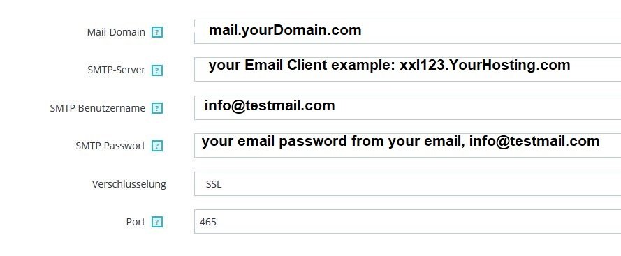

passicool Posted December 14, 2020 Share Posted December 14, 2020 Hello, A solution, create a new mail work, use SSL, port 465. I try on 2 web site and it finaly works. Link to comment Share on other sites More sharing options...

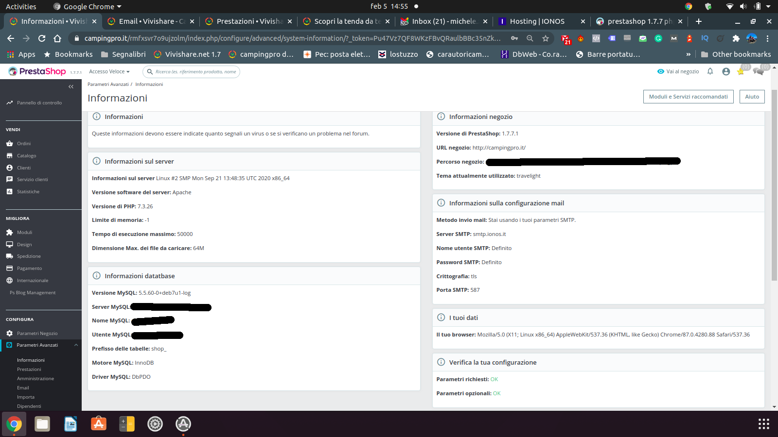

mikirimiki Posted February 5, 2021 Share Posted February 5, 2021 (edited) Hello, After upgrading Prestashop to 1.7.7.1 the email system doesn't work to me as well. I tried with suggestion reached in this topic. My host is IONOS on a shared server. I tried with SMTP parameters: (I have this parameter in my IONOS ACCOUNT) smtp.ionos.it TLS 587 In Prestashop TEST mail it works. The test email is sent to the email address I choose, but if I replay to a Customer in Customer Service it doesn't work. I think SMTP paramters in prestashop should be work as another email client. I tried already with SSL PORT 465 or no protected conncection with PORT 25. Always the TEST email was sent, but never from customer service. ________________________________________________________________________ UPDATE: I found the emails go to spam folder. So the problem is not Prestashop, but my hosting provider. Any idea? Here my Prestashop configuration (attached): Do you have an idea? Edited February 5, 2021 by mikirimiki (see edit history) Link to comment Share on other sites More sharing options...
mikirimiki Posted February 5, 2021 Share Posted February 5, 2021 Link to comment Share on other sites More sharing options...

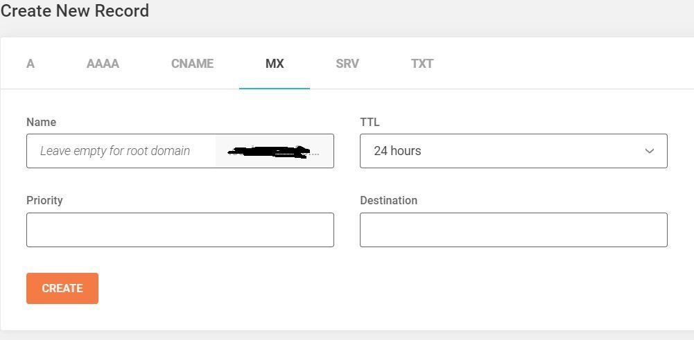

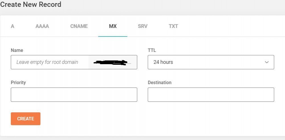

mikirimiki Posted March 19, 2021 Share Posted March 19, 2021 To fix It you should add a record in DNS section, and wait 24h. Now I can't see, what I added. This afternoon I can see. Link to comment Share on other sites More sharing options...

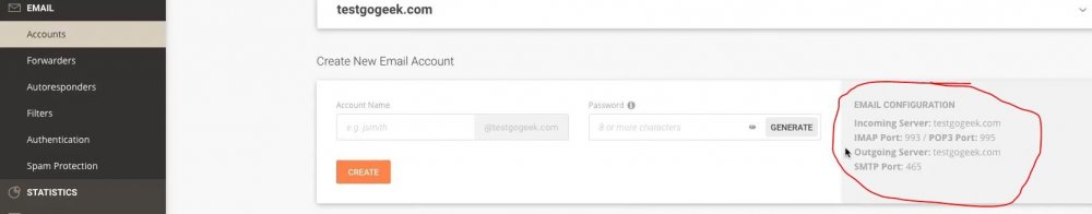

cassandra8 Posted October 27, 2021 Share Posted October 27, 2021 this is what I set at siteground that finally worked for us. Prestashop admin panel: settings under email: smtp server : xxxxxx.com username: xxxxx.com or xxxx@xxxx.com password: xxxxxx encyption: ssl port 465 settings under Traffic and Seo at bottom: shop domain: www.xxxxx.com ssl domain : www.xxxx.com base url: / Server side: email: xxxxx.com or xxxxxx@.com incoming server: xxxxx.com imap port 993 pop3 port 995 outgoing srver: xxxxxx.com smtp port 465 if this does not work check that the domain zone editor settitngs are correct under mx we could never get working with php under siteground. 1 Link to comment Share on other sites More sharing options...
Gereon Posted November 22, 2021 Share Posted November 22, 2021 Hi Cassandra8, I have hosting with siteground and facing the same "email" problem. I have used setting same as you have mentioned above. Now I have the following message in prestashop: Error: Please check your configuration. You have also mentioned to check the domain zone editor settings are correct under mx. I can see only these settings under mx: mx30.mailspamprotection.com. with priority 30 mx20.mailspamprotection.com. with priority 20 mx10.mailspamprotection.com. with priority 10 Should I create new record? Could you please advise me how to set it up correctly? Please see attached image below from my siteground account. Thank you in advance. Link to comment Share on other sites More sharing options...

cassandra8 Posted November 22, 2021 Share Posted November 22, 2021 go to mx and fill out mx to your siteground name ttl is 60 seconds, priority 10 destination as above. That was all I did. On prestashop everything is the the way I described above. This is what worked for me. My .com name is an alias of the master google account. You may want to check that in google email. 1 Link to comment Share on other sites More sharing options...
Gereon Posted November 22, 2021 Share Posted November 22, 2021 Cassandra8, thank you once again. Finally I got this work using gmail account. In my case I used the following settings: SMTP server: smtp.gmail.com SMTP username: emailname@gmail.com SMTP password: you have to use 16-digit passcode. First you have to set 2 step verification for your google account, then you can generate this 16 digit passcode for app. Encryption: SSL Port: 465 settings under Traffic and Seo at bottom: shop domain: www.xxxxx.com ssl domain : www.xxxx.com base url: / Then I sent test mail and it all worked. I didn´t set anything in domain zone editor. Thank you once again. This thread might be also usefull: Link to comment Share on other sites More sharing options...

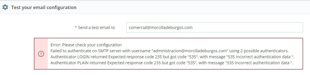

AlbertoCasado Posted January 27, 2022 Share Posted January 27, 2022 Hello, It also fails me, and if I use the html protocol the following error appears: the login configuration is correct. What I can do? The error jumped me when updating prestashop to version 1.7.8.2 Link to comment Share on other sites More sharing options...
Avengers Posted January 30, 2022 Share Posted January 30, 2022 On 1/27/2022 at 2:42 PM, AlbertoCasado said: Hello, It also fails me, and if I use the html protocol the following error appears: the login configuration is correct. What I can do? The error jumped me when updating prestashop to version 1.7.8.2 Expand The smpt username and password not correct. i suggest change password and try again.... Link to comment Share on other sites More sharing options...
AlbertoCasado Posted January 31, 2022 Share Posted January 31, 2022 On 1/30/2022 at 11:03 AM, Avengers said: The smpt username and password not correct. i suggest change password and try again.... Expand I did it but it keeps crashing Link to comment Share on other sites More sharing options...
Avengers Posted January 31, 2022 Share Posted January 31, 2022 On 1/31/2022 at 7:37 AM, AlbertoCasado said: I did it but it keeps crashing Expand Can you give the login access for admin and cpanel so i can check it some time server configuration issue. Link to comment Share on other sites More sharing options...
AlbertoCasado Posted February 3, 2022 Share Posted February 3, 2022 On 1/31/2022 at 12:53 PM, Avengers said: Can you give the login access for admin and cpanel so i can check it some time server configuration issue. Expand I don't quite understand your answer. But the mail works fine. Link to comment Share on other sites More sharing options...

stefano813 Posted January 26, 2023 Share Posted January 26, 2023 I've just solved this problem (on a IONOS.it shared plan) by: -removing the special characters from my email password AND -by using the same password for the email and the PS back office (every time I saved the email configuration, the email password in the database would change to the back-office password). And -by using port 25 (instead of 465 as indicated on the Ionos website to configure an email client). Link to comment Share on other sites More sharing options...
Nickz Posted January 26, 2023 Share Posted January 26, 2023 On 1/26/2023 at 4:06 PM, stefano813 said: -by using port 25 Expand I believe that port 25 holds some security issues Link to comment Share on other sites More sharing options...
