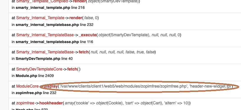

DamianS20171 Posted August 6, 2020 Share Posted August 6, 2020 Hello, recently noticed that I have a blank page when I login to shop just like a client. Login to admin panel is ok, everything works. What it can be caused by? Link to comment Share on other sites More sharing options...
musicmaster Posted August 6, 2020 Share Posted August 6, 2020 That means that some php error happened. Enable debug mode to see which. Link to comment Share on other sites More sharing options...
DamianS20171 Posted August 7, 2020 Author Share Posted August 7, 2020 Ok, I enabled debug mode and that's what I got. Any advices? O Link to comment Share on other sites More sharing options...
musicmaster Posted August 7, 2020 Share Posted August 7, 2020 The problem seems related to the Zopimfree module. Try to disable that and contact its author. Link to comment Share on other sites More sharing options...
DamianS20171 Posted August 7, 2020 Author Share Posted August 7, 2020 Ok I disabled that module and then I get next thing. See below. I disabled the przelewy24 module and now everything works but it is really strange thing that this module causes such problem. On others shops this module works fine. Do you know what it can be caused by? This module in important because it is payment module. Link to comment Share on other sites More sharing options...
musicmaster Posted August 8, 2020 Share Posted August 8, 2020 I don't know the relationship between Zopimfree and przelewy24. This is module specific knowledge. That is why you better ask the makers. The error that you get know looks like a typical follow-up error: you removed one part of a system. If it works in other shops you might want to have a look at the module itself. The error was related to some template file of the module. Maybe you changed it... Try re-installing the module or replacing its files with those from a working shop (watch out for configuration files). Link to comment Share on other sites More sharing options...
