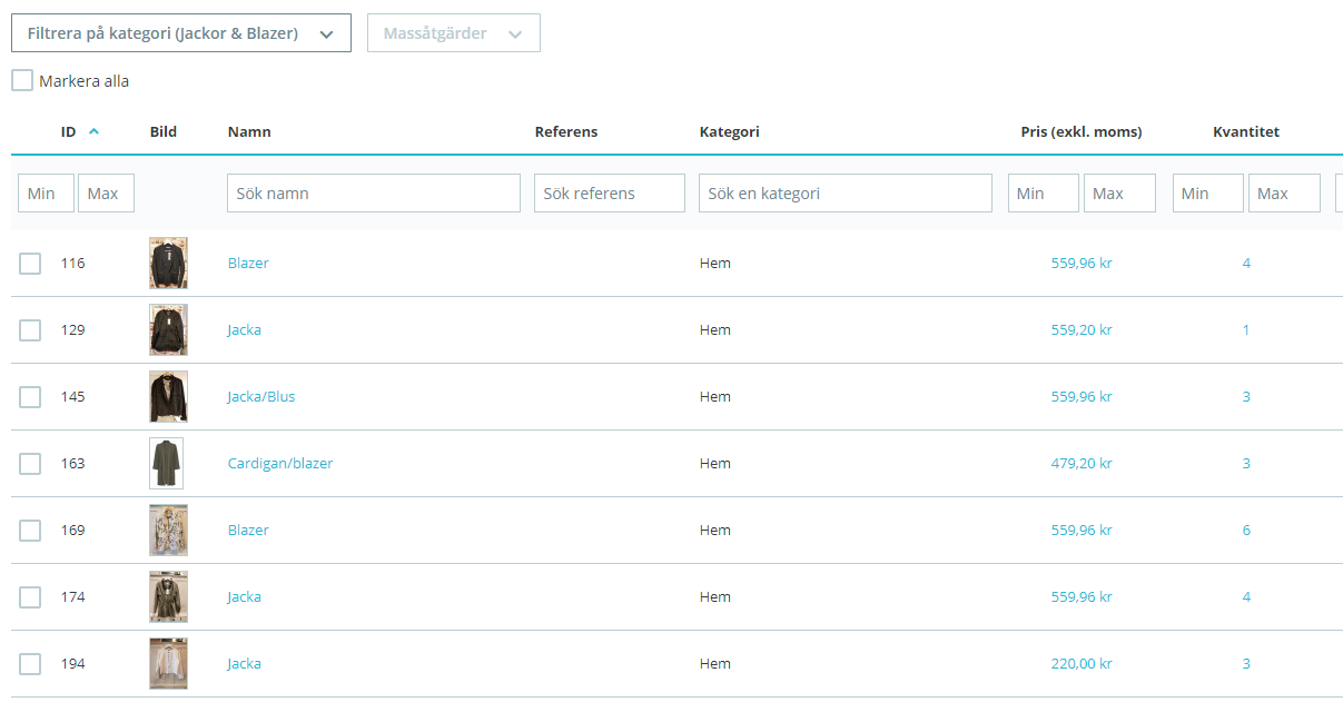

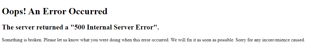

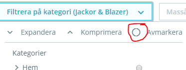

SettleR Posted August 6, 2020 Share Posted August 6, 2020 I have a problem with my website crashing. This problem occour when i have use the filter on the product page. When i try do deselect my filter again (see picture 2) the website crash (see picture 3). How to i solve this? Before i did this filter on the product page, everything worked fine. After i did this filter most of my actions lead to a error message (picture 3). Is there any way to go back or reset the filter in some way? Or is this a mysql problem? Thanks in advance Link to comment Share on other sites More sharing options...

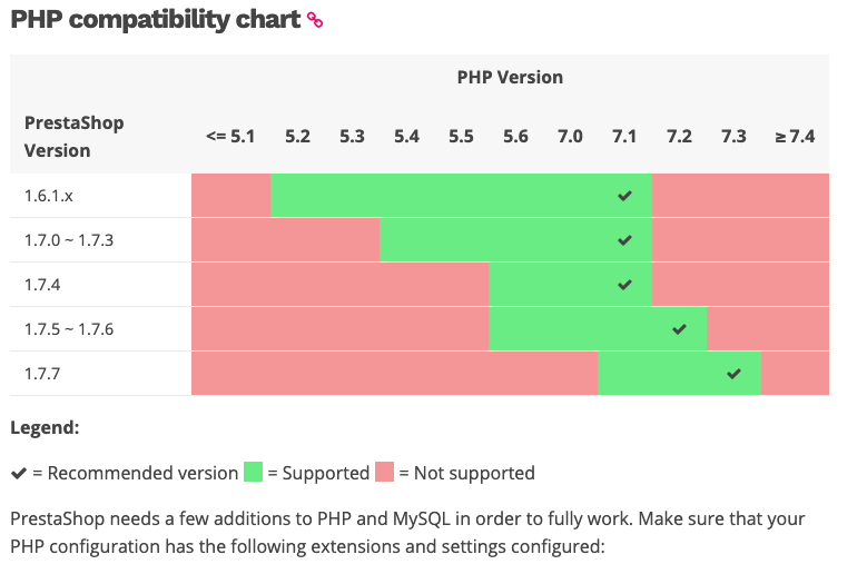

PrestaServicePro Posted August 6, 2020 Share Posted August 6, 2020 Check the image please, and set right PHP version depending on your PS. And try again to access shop. Link to comment Share on other sites More sharing options...

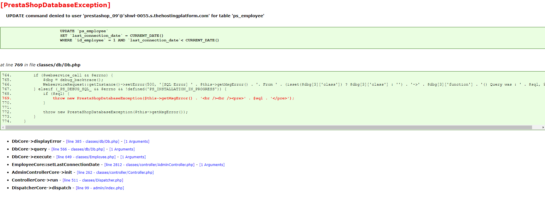

SettleR Posted August 6, 2020 Author Share Posted August 6, 2020 7 minutes ago, PrestaServicePro said: Check the image please, and set right PHP version depending on your PS. And try again to access shop. I changed the php version to 7.2. Got the same error when trying to edit something (505 internal...) .. i changed config again to "true", got this message now, [PrestaShopDatabaseException] UPDATE command denied to user 'prestashop_09'@'shwl-0055.s.thehostingplatform.com' for table 'ps_employee' UPDATE `ps_employee` SET `last_connection_date` = CURRENT_DATE() WHERE `id_employee` = 1 AND `last_connection_date`< CURRENT_DATE() at line 769 in file classes/db/Db.php 764. if ($webservice_call && $errno) { 765. $dbg = debug_backtrace(); 766. WebserviceRequest::getInstance()->setError(500, ' ' . $this->getMsgError() . '. From ' . (isset($dbg[3]['class']) ? $dbg[3]['class'] : '') . '->' . $dbg[3]['function'] . '() Query was : ' . $sql, 97); 767. } elseif (_PS_DEBUG_SQL_ && $errno && !defined('PS_INSTALLATION_IN_PROGRESS')) { 768. if ($sql) { 769. throw new PrestaShopDatabaseException($this->getMsgError() . '<br /><br /><pre>' . $sql . '</pre>'); 770. } 771. 772. throw new PrestaShopDatabaseException($this->getMsgError()); 773. } 774. } DbCore->displayError - [line 385 - classes/db/Db.php] - [1 Arguments] DbCore->query - [line 566 - classes/db/Db.php] - [1 Arguments] DbCore->execute - [line 649 - classes/Employee.php] - [1 Arguments] EmployeeCore::setLastConnectionDate - [line 2812 - classes/controller/AdminController.php] - [1 Arguments] AdminControllerCore->init - [line 262 - classes/controller/Controller.php] ControllerCore->run - [line 511 - classes/Dispatcher.php] DispatcherCore->dispatch - [line 99 - admin/index.php] Link to comment Share on other sites More sharing options...
PrestaServicePro Posted August 6, 2020 Share Posted August 6, 2020 Hmm, it seems, there is now "Privileges problem on MySQL User Account". Contact host provider (or do it by yourself) set all grant accesses to current user, then check again. 1 Link to comment Share on other sites More sharing options...
