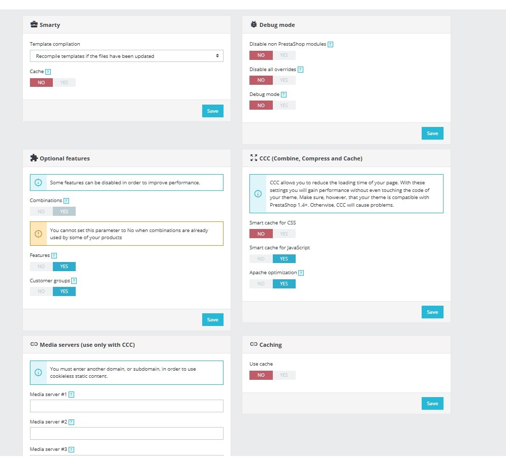

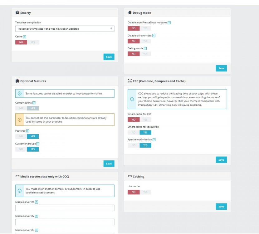

Symphony Posted July 30, 2020 Author Share Posted July 30, 2020 I've just gone to try what you suggest, and it seems that we don't have memcache enabled. In fact, I can't find any referent to memcache at all. The only cache that is current enabled is Litespeed, which is handled via a separate module and then on the server. Link to comment Share on other sites More sharing options...
