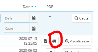

I use Prestashop 1.7.6.5 and by external link i mean a link to a php script outside of backend on the same domain.
Something like this:
The backend address for orders page is https://site.com/presta/admin/index.php?controller=AdminOrders&token=<token>
The link to which i need the button to point to is https://site.com/presta/courier/courier.php?order_id=<id of order for which the button was clicked>
