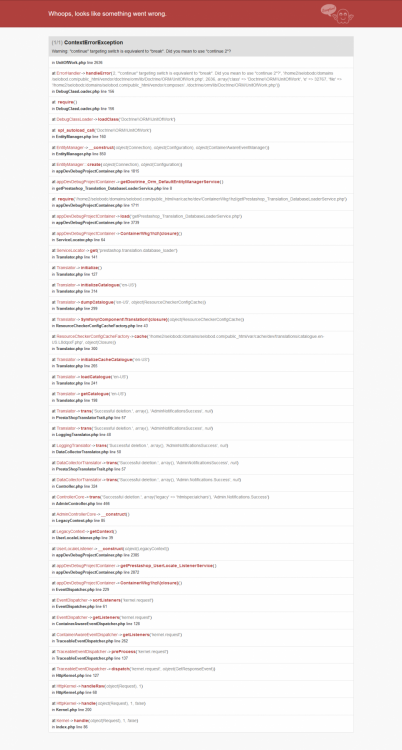

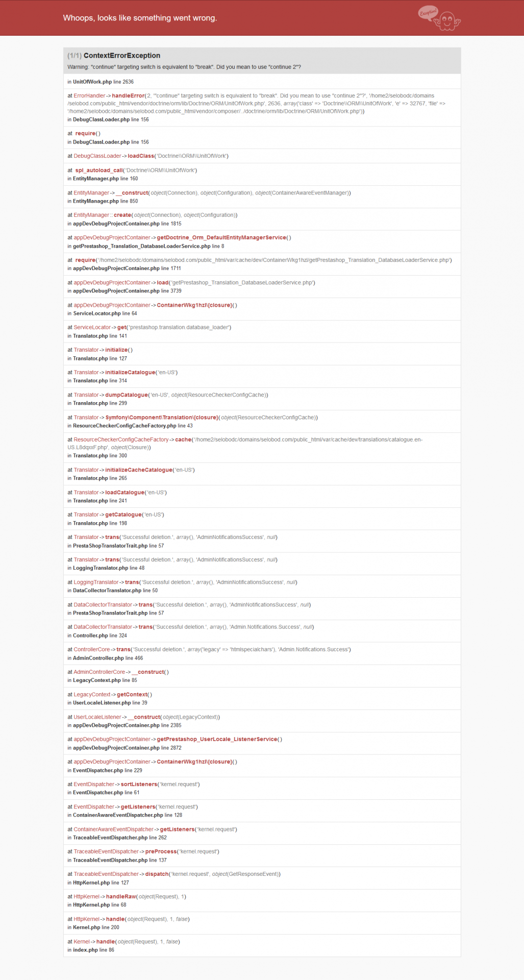

Jafar Muhammed Posted July 11, 2020 Author Share Posted July 11, 2020 Hi @Guest, I have attached the dev.log dev.log Link to comment Share on other sites More sharing options...
Guest Posted July 11, 2020 Share Posted July 11, 2020 PHP min 5.6 max 7.2 Link to comment Share on other sites More sharing options...
Guest Posted July 11, 2020 Share Posted July 11, 2020 If it's still a problem, it's better to hire someone to work and debug. It is not possible to repeat indefinitely what has already been solved and how to eliminate the errors. Several steps are written, such as manually renaming the dev and prod folders in the ./var/cache folder to FTP. Also turn off override rewriting, turn off non-original Prestashop modules ....... Link to comment Share on other sites More sharing options...
Jafar Muhammed Posted July 11, 2020 Author Share Posted July 11, 2020 Hi @Guest, I have changed PHP to 7.2. Now I can access both front and back without errors with Debug mode enabled. When I disable the debug mode, same HTTP 500. Link to comment Share on other sites More sharing options...
Guest Posted July 11, 2020 Share Posted July 11, 2020 Rename dev and prod folders in ./var/cache folder. Delete renamed folders dev and prod. Clear cache. https://presta.site/blog/en/how-to-clear-prestashop-cache/ Link to comment Share on other sites More sharing options...
