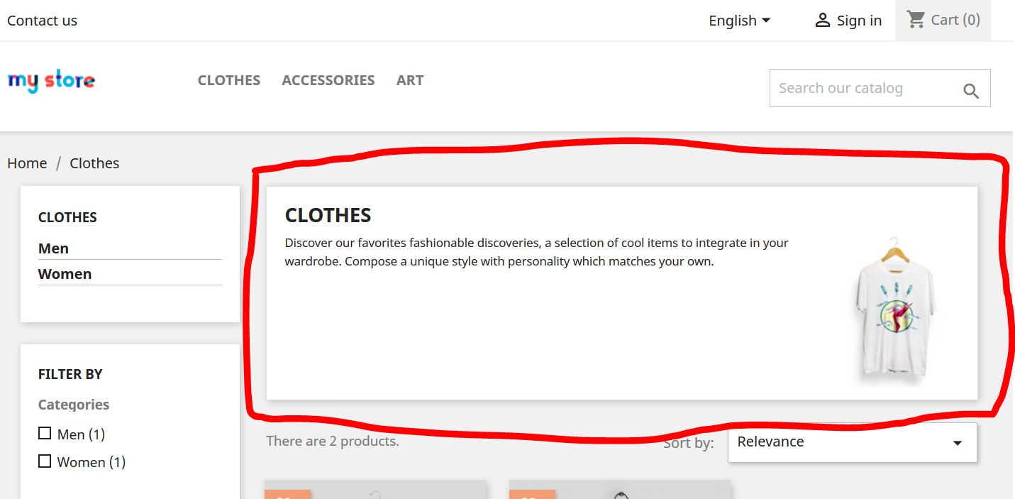

regn Posted June 15, 2020 Share Posted June 15, 2020 Hello! I am trying to remove the category descriptive box. Due to limited knowledge with code I am trying to use the modules and hooks to address the issue but I can not find it. I can locate the window under theme/pages configuration but after that it stops. I have looked for solutions on the forum. But, I have not found one that I could apply to my issue at hand. As seen in the attached picture, how can I remove the red box? I wish to remove this box for every category group including sub-categories. Thank you in advance! Link to comment Share on other sites More sharing options...
musicmaster Posted June 15, 2020 Share Posted June 15, 2020 You can better modify the theme. This concerns the file /themes/classic/templates/catalog/_partials/category-header.tpl Link to comment Share on other sites More sharing options...
