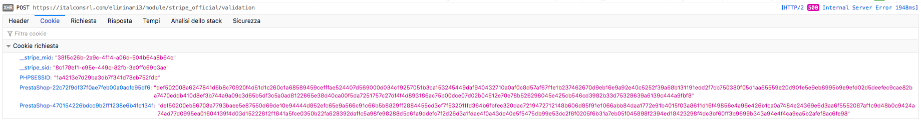

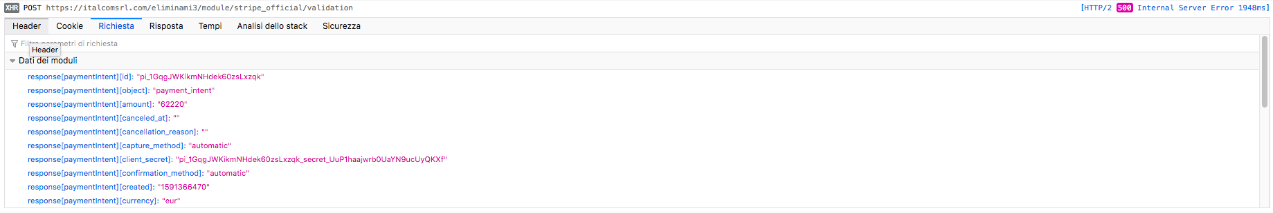

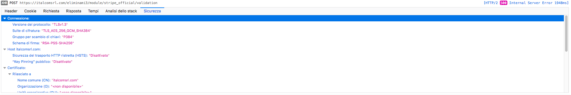

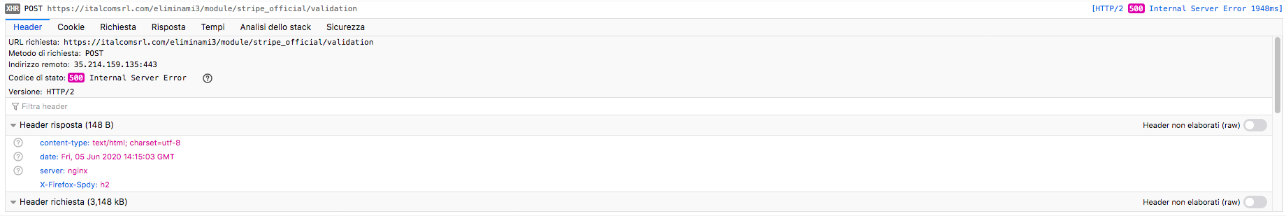

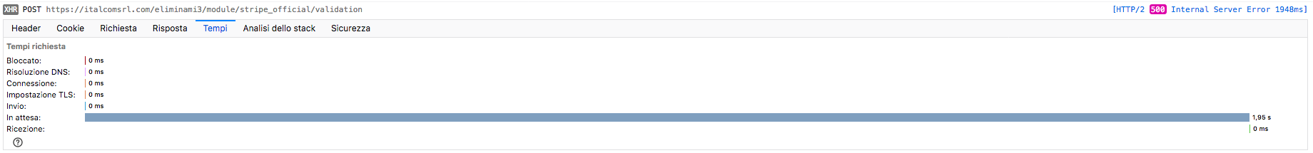

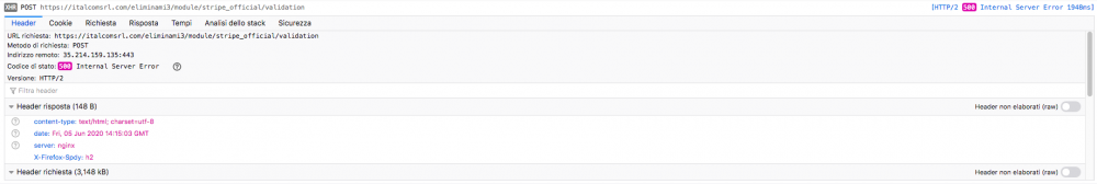

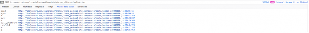

kitfoxster Posted June 5, 2020 Share Posted June 5, 2020 Hi! Please help me, I swear to god I'm going crazy!! My client has a prestashop 1.7.5.2 installation and would like to receive payments via credit card with the base (free) stripe plugin. I've tried everything, it doesn't work. Or rather, it actually charges the money from the credit card and deposits it on my client's stripe account, but the checkout page stays frozen and doesn't refresh to the "order complete" page, and also doesn't create the order in backend. It just stays there with the "processing payment" grayed out button. The problem is related to a 500 error that appears in the console (while processing the payment). It's able to correctly send the request, but receives nothing (due to the 500 error). Here's what I did so far: - live website in prestashop 1.7.5.2 on the domain root, with stripe free plugin v2.0.8 -> doesn't work - duplicate of live site in subfolder, with all modules disabled except stripe -> doesn't work - duplicate of live site in subfolder, with all modules disabled except stripe AND base theme (even though the other theme wasn't phisically deleted) -> doesn't work - duplicate of live site in subfolder, with all modules disabled except stripe AND base theme (even though the other theme wasn't phisically deleted) AND updated to last prestashop version -> doesn't work - fresh prestashop 1.7.5.2 install in subfolder, with stripe free plugin v2.0.8 -> WORKS PERFECTLY (therefore it isn't a server or php problem, but should be a module conflict or theme issue) Here's some info: - the site is multilingual - my client want's to show prices only to registered users (and changes prices based on manually assigned groups) - therefore a customer has to create an account, wait for manual approval and group assignment, and only then can he/she buy - the client simply logs into the site and sees prices and add to c art functionality Everything works fine except for the 500 error that occurs on the stripe RETURN. Can you please help me? Here's some technical info: PrestaShop: 1.7.5.2 http://italcomsrl.com/eliminami3/ (exact duplicate of live site) Theme: theme_pedona5-italcom server Linux #1 SMP Tue Oct 9 18:14:47 EEST 2018 x86_64 software del server: Apache PHP: 7.3.16 Memory limit: 768M max execution time: 120 Max file size: 128M Version MySQL: 5.6.40-84.0-log Motor MySQL: InnoDB Driver MySQL: DbPDO At the moment stripe is set on test mode, so you can test by going to the website https://italcomsrl.com/eliminami3 Login in to the account usr: asd@asd.com pse: prestashop Add any product to the cart and go to the checkout page, therefore pay with stripe with this test-card info: Card number: 4242424242424242 Any 3 digits as the CVC Any future date as the expiry Any 5 digits for the CAP And you'll get the 500 error. The same error on test mode and on live, even though in live stripe actually does successfully charge the credit card. Attached to this post are the screenshots of the firefox console error. Please help guys, I really don't know what else to try ç___ç - Joseph Link to comment Share on other sites More sharing options...
razaro Posted June 5, 2020 Share Posted June 5, 2020 Have you tried to enable debug note and check those requests in console ? They should give you some clue why that 500 error appears.. Also checking hosting error logs could help. Link to comment Share on other sites More sharing options...

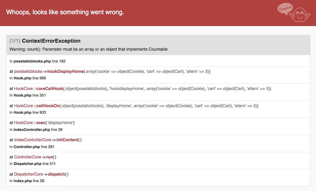

kitfoxster Posted June 5, 2020 Author Share Posted June 5, 2020 Hi! If I activate the debug mode I get errors in home page and in complete honesty I wasn’t able to understand much of it, tomorrow I’ll try activating it again and grab some screenshots. thanks for the quick reply!! Link to comment Share on other sites More sharing options...

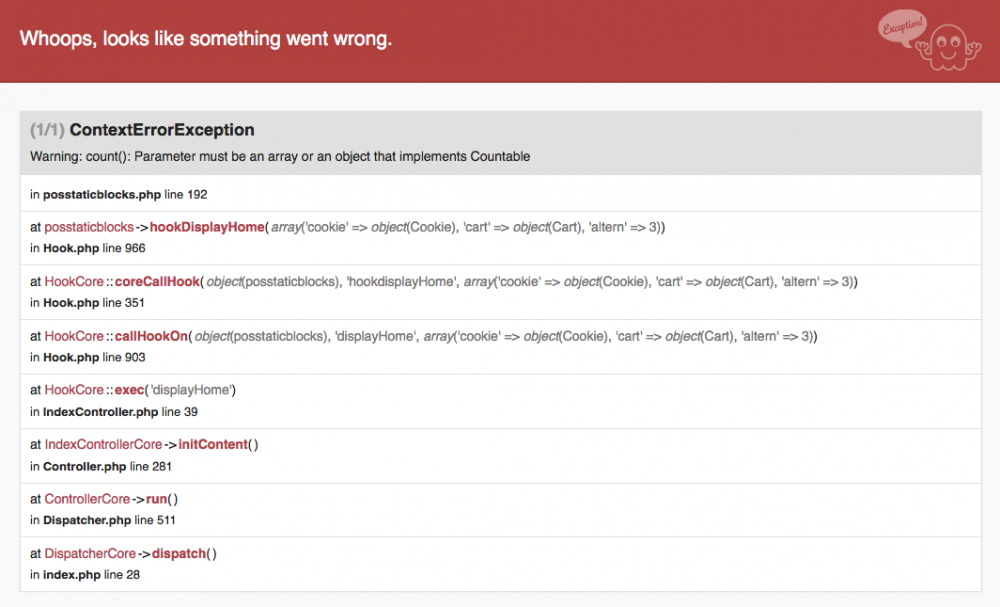

kitfoxster Posted June 6, 2020 Author Share Posted June 6, 2020 Hi! Here I am again! Here's a screenshot of the home page with the debug mode on. I just tried another test payment and it didn't work, and in the php_errorlog in prestashop root folder there's this line: Quote [06-Jun-2020 08:54:23 Europe/Rome] PHP Fatal error: Uncaught --> Smarty: Unable to load template 'file:helpers/list/list_header.tpl' <-- thrown in /home/italcom9/public_html/eliminami3/vendor/smarty/smarty/libs/sysplugins/smarty_internal_template.php on line 195 Expand Could it be part of the problem? Link to comment Share on other sites More sharing options...
kitfoxster Posted June 8, 2020 Author Share Posted June 8, 2020 Hi! Any ideas? Link to comment Share on other sites More sharing options...
razaro Posted June 8, 2020 Share Posted June 8, 2020 That error does not seams yet connected to Stripe, but module, maybe part of theme, posstaticblocks. And it have to do with PHP version you have, it may work with 7.1 but that is already deprecated so it would be best to contact theme developer and ask for fix it for 7.2/7.3 version of PHP. Should not be big change. But that is just a warning so should not be main issue, but should be fixed so you can check checkout and Stripe. Other error message I think is for back office but cant say more. Link to comment Share on other sites More sharing options...

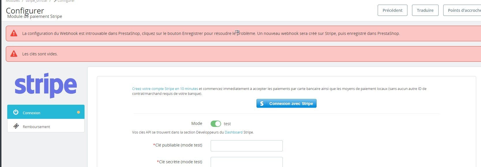

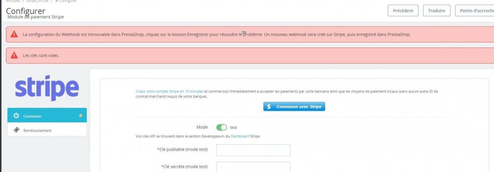

StephanePro Posted February 12, 2023 Share Posted February 12, 2023 Hi dear, Please can you help me for this bug in the stripe addons for Prestashop 8.0 La configuration du Webhook est introuvable dans PrestaShop, cliquez sur le bouton Enregistrer pour résoudre le problème. Un nouveau webhook sera créé sur Stripe, puis enregistré dans PrestaShop. Thks Link to comment Share on other sites More sharing options...
nick_developer Posted February 13, 2023 Share Posted February 13, 2023 Hi Stephane, I'm not using Prestashop 8 at the moment. Have a try disinstalling Stripe, cleaning the cache and then re-install. best regards Nick Link to comment Share on other sites More sharing options...
