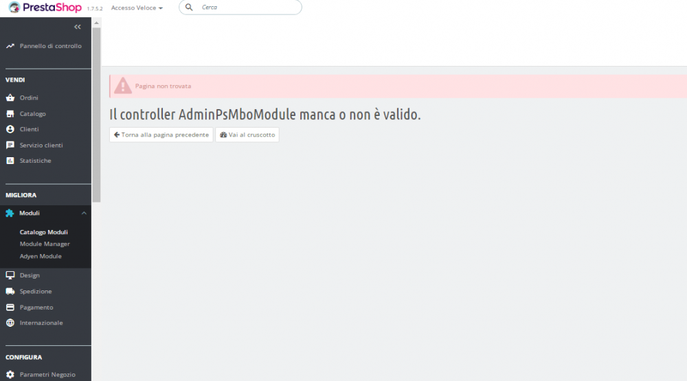

Angela Di Romualdo Posted April 5, 2022 Share Posted April 5, 2022 On 5/28/2020 at 9:59 PM, Matt75 said: Hi, I'm sorry to know that you encountered an issue with this module. You can find a fix here: https://github.com/PrestaShopCorp/ps_mbo/pull/96/files This problem seems to occur when the server cache did not update according to my tests. Good night Hi Matt, Thank you for your help. I have a similar problem. I cannot access to Module Manager page as it's blank. I started having this issue when I tried to install a module for credit card payments but it never completed the process. So, after few hours it was still running, I closed it. When I reopened it the Module Manager page was blank and I started having issues to install any module. I asked the server provider and they told me the problem is linked to the module "ps_mbo". Then someone advised me to clear the cache and rename it into "ps_mbo.bak". I tried but Module Manager is still blank. I cleared the cache and renamed the folder into "ps_mbo.bak" I also checked the section Modules and this is what comes out. "The controller AdminPsMboModule is missing or is not valid" I feel lost. Link to comment Share on other sites More sharing options...
