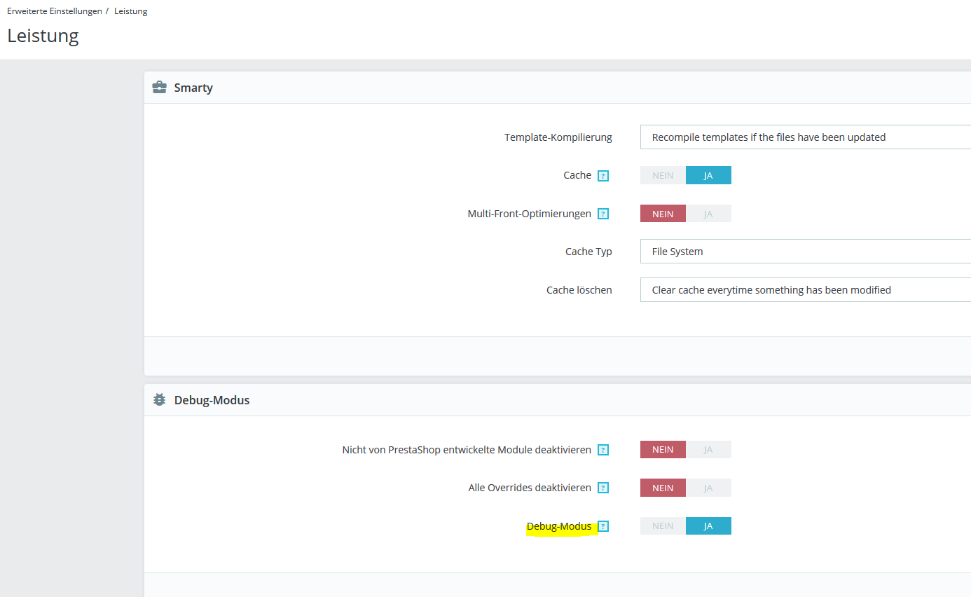

JBW Posted May 27, 2020 Share Posted May 27, 2020 On 5/24/2020 at 6:44 PM, Luca1987 said: wo aktiviere ich das error reporting? Erweiterte Einstellungen->Leistung->Debug Modus Link to comment Share on other sites More sharing options...
