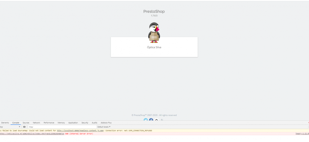

vctp10 Posted May 23, 2020 Share Posted May 23, 2020 Hi, In my new instalation of prestashop 1.7 everything is ok, except where I try login stay a page with pinguin and with no form like the attachment. Any can help me? Link to comment Share on other sites More sharing options...

vctp10 Posted May 23, 2020 Author Share Posted May 23, 2020 26 minutes ago, PrestaServicePro said: Hi, Enter folder list of ps > config > defines.inch.php you will see define('_PS_MODE_DEV_', false); Change false to TRUE and try to refresh the page again. On screen or inspect you must see the error. Have a nice weekend thanks for the reply, but i had already done that. At inspect I see an error in jquery-1.11.0.js on line 4 but I don't know how to solve it. It had happened to me in another project and I ended up doing it, I don't remember how I thought it was something in the php configuration but you can see that everything is ok here https://opticasilva.pt/phppsinfo.php Link to comment Share on other sites More sharing options...
