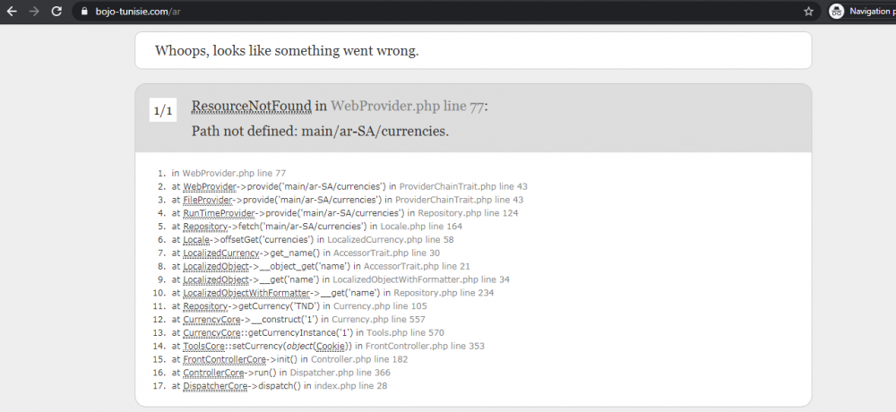

midoo1992 Posted May 19, 2020 Share Posted May 19, 2020 Hello, I have a problem with translation to arabic in prestashop 1.7.0.0 I added arabic on my backoffice then i started to create translations for sentences. When i change to arabic on the frontoffice, i got error 500. I have activated debug mode, i got this error in the print screen. Can anyone help me ! Link to comment Share on other sites More sharing options...

midoo1992 Posted May 27, 2020 Author Share Posted May 27, 2020 Hi ndiaga, I want that the currencies don't change. I should be the same for the two languages. How can I do that ? Link to comment Share on other sites More sharing options...
midoo1992 Posted May 27, 2020 Author Share Posted May 27, 2020 2 hours ago, ndiaga said: Hi, Activate only the one you need. Hi, That's what i did. The problem is how to link the language to the only currency as you said. Link to comment Share on other sites More sharing options...
