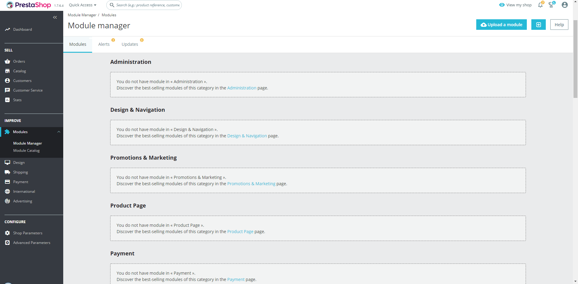

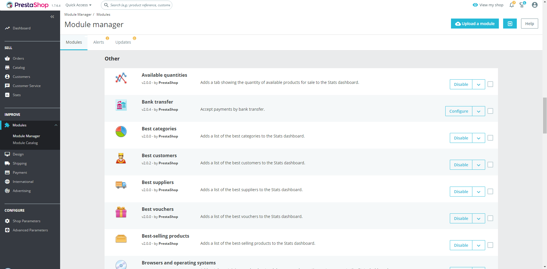

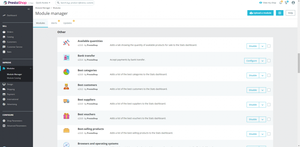

NeilT Posted May 14, 2020 Share Posted May 14, 2020 Hi, I had to re-install Prestashop but this time almost all modules are listed as "Other". The only other section in the Modules Manager with anything listed is "Theme Modules", all others are empty. It looks like the modules are there but not in the correct section. I am concerned that this may cause an issue if I continue especially as this will be a multistore site. I have deleted/re-installed three times with the same issue. I have another, clean, install that does not have this issue and this is a re-install where the first install did not have this problem. The same install files were used in all cases and downloaded from Prestashop. Any guidance appreciated. Thanks Neil (screen shots attached) Link to comment Share on other sites More sharing options...
JBW Posted May 20, 2020 Share Posted May 20, 2020 Looks like the bug reported here: https://github.com/PrestaShop/PrestaShop/issues/18909 Try to disconned from addon strore to get it sorted again Link to comment Share on other sites More sharing options...
NeilT Posted May 20, 2020 Author Share Posted May 20, 2020 Hey JBW, Thanks for that. Yeah looks exactly the issue I had. It's odd because it's just the one domain it happens on. I've actually abandoned that now and have set it all up on another domain and things appear to be working as normal. Many thanks again for the reply. At least I know I now actually going mad. Cheers Neil Link to comment Share on other sites More sharing options...
dragon_sa Posted June 30, 2021 Share Posted June 30, 2021 Thanks for that info I had been struggling with this for weeks, I disconnected from addon store and it did indeed fix things immediately, I cant abandon the domain so is there a fix so I can reconnect to the store again and remain in the same state? I am using 1.7.6.5 Link to comment Share on other sites More sharing options...
