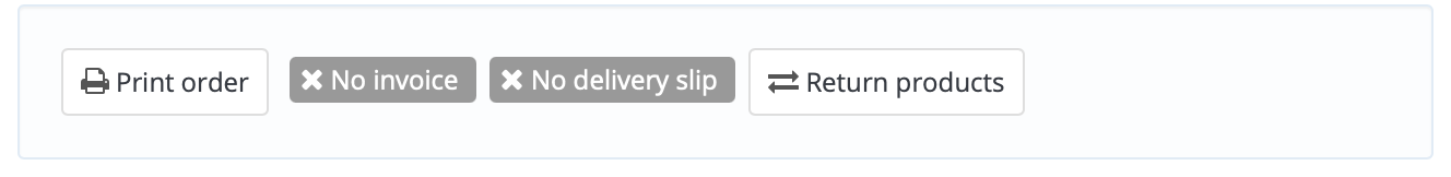

HaCos Posted May 31, 2021 Share Posted May 31, 2021 Which is the button for partial refund? On top of order management i have access to "Return products" button (attached images) If i update order status to refunded - then paypal returns the whole amount. I need to have partia refund without paypal api being called. Link to comment Share on other sites More sharing options...
