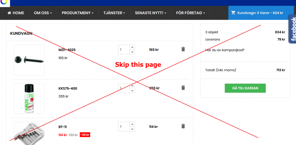

roboy Posted May 14, 2020 Author Share Posted May 14, 2020 12 hours ago, ndiaga said: Hi, You can even use the CartController.php there the shopping cart step is : cart?action=show so you can do this : if(Tools::getValue('action') === 'show') { Tools::redirect('cart?action=checkout'); } Ndiaga, I have searched through CartController.php, both using text search and manually scrolling through the file, but I can't find the above text strings. I'm currently running PS 1.7.6.2. Is it PS 1.7 you are referring to? Could you then please provide me with a line number? Verlonimo, sorry for confusing you! Can we agree that when you press 'Proceed to checkout' in the ajax cart (usually top right corner of the shop, in the header area) you are not directed straight to the checkout page, but instead to a separate cart summary page where you can see the products that are put in the cart? What I want is to skip that page and instead go straight to checkout. I have attached a screenshot of the page I want to skip. Link to comment Share on other sites More sharing options...
Verlonimo Posted May 14, 2020 Share Posted May 14, 2020 Hi, @roboy So you should use my solution provided. If you using default shopping cart module then check for overridesnin theme... also dont forget to clear cache after changes. @ndiaga for such simple task where he want just to change link, controller override would be overkill here. Thanks Link to comment Share on other sites More sharing options...
roboy Posted May 14, 2020 Author Share Posted May 14, 2020 Ok @ndiaga, now I got it (obvious newbie 😄). Finally I went with your solution @Verlonimo and it's working great. I'm sure the other solution would have worked equally great and I believe it's good having alternative solutions at hand in case a future version renders one of them impossible or difficult to implement. Tons of thanks to both of you for taking your time and for having such patience! 2 Link to comment Share on other sites More sharing options...
