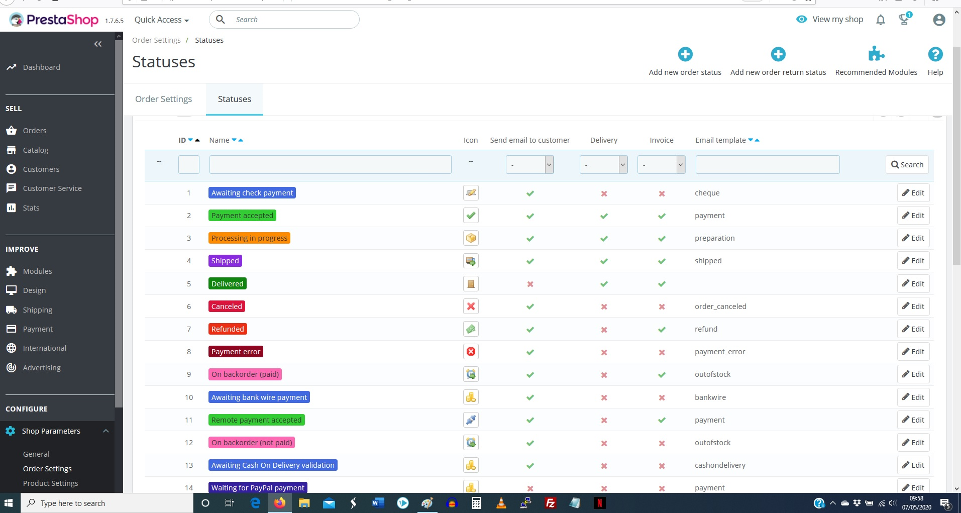

Guest Posted May 7, 2020 Share Posted May 7, 2020 Go to Admin -> Shop parameters -> Order settings -> Statuses Check or uncheck "Send email to customer". Link to comment Share on other sites More sharing options...
waheed Posted May 7, 2020 Author Share Posted May 7, 2020 11 minutes ago, Guest said: Go to Admin -> Shop parameters -> Order settings -> Statuses Check or uncheck "Send email to customer". Thankyou for your reply, iv just check that as well just now and the payment accepted is already down to send email to customer Link to comment Share on other sites More sharing options...

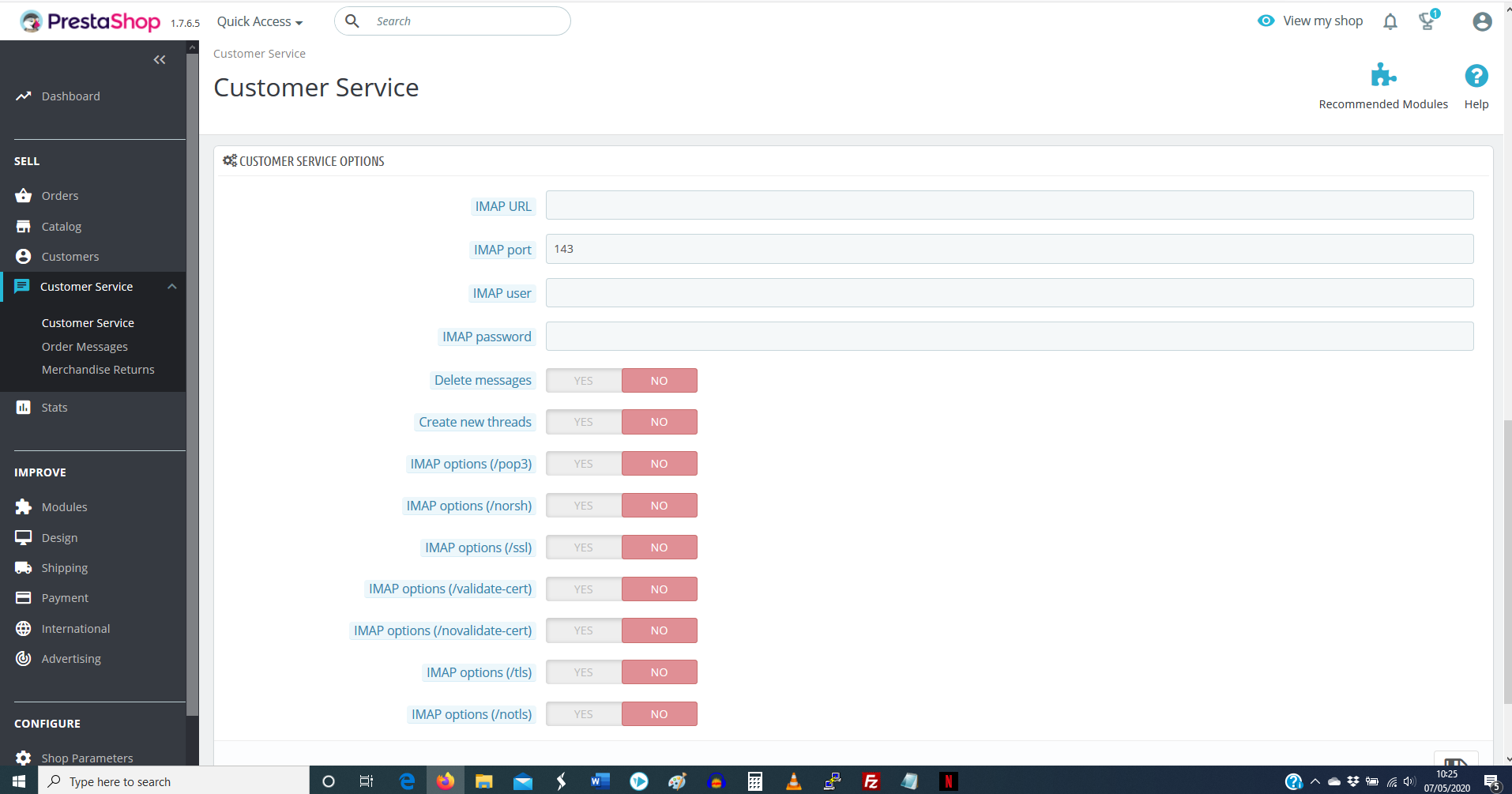

waheed Posted May 7, 2020 Author Share Posted May 7, 2020 Does prestashop use IMAP settings to order status emails? i noticed the message on the top of the screen which say IMAP is not configured, but i am using Advanced Parameters --> E-mail --> Use PHP's mail() function (recommended; works in most cases) I have just sent a test email from the contact Us page that messages are coming through to the customer services on backoffice. thast working fine Link to comment Share on other sites More sharing options...

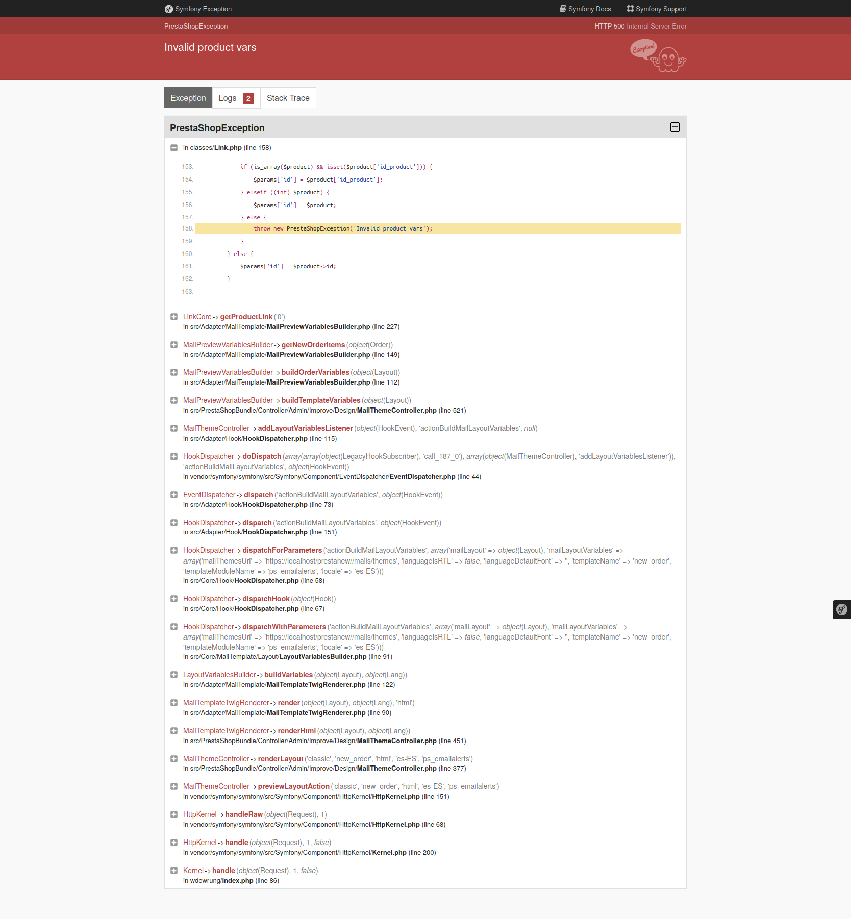

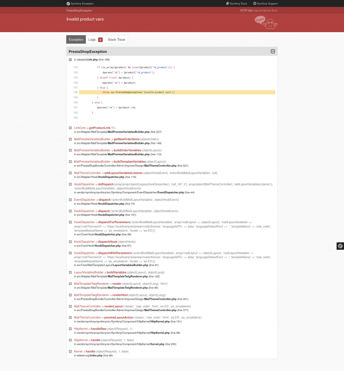

Sergi Posted May 14, 2020 Share Posted May 14, 2020 (edited) Hello @waheed and others... I'll bring my own... I have a similar problem after updating the shop to version 1.7.6.5 (source of 1.7.2.5) Apparently everything went well except the mailings to customers and, in my case, the order confirmations either. I think that using the php or smtp function is not relevant, because in my case I had the smtp well configured. I couldn't trust the test email either, since I received it without problems while the others didn't work. I also have only one language, so I ruled out problems with translations... Finally, the emails to the customers work well, having reconfigured the smtp with the option SSL and IMAP options (validate-cert) to achieve that the emails do not end up in the SPAM folder. My provider talked about rejecting mailings without SSL, (Provider? ummmm, unreliable factor, don't consider this 😄). Urging in the files of the new installation, I could see that prestashop has changed the system of sending, using twig templates to be able to personalize the mails from the administration panel. And that's what throws me an error with one mail: new_order (Attachment capture). I think there is some bug with the emailalerts module or prestashop 1.7.6.5... I hope to find the solution to my case (working on it now) and that it can help you or future users to find the solution. Working on local, php7.2.3, no caché... Greetings! Translated with www.DeepL.com/Translator (a little help 🙂) Edited May 14, 2020 by Sergi (see edit history) Link to comment Share on other sites More sharing options...
