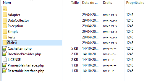

LeSchtroumpf Posted May 5, 2020 Author Share Posted May 5, 2020 (edited) I did, but all seems good : Edited May 5, 2020 by LeSchtroumpf (see edit history) Link to comment Share on other sites More sharing options...
JBW Posted May 5, 2020 Share Posted May 5, 2020 Guess these are not the affected directories. More likley the translation or cache directories. Try to rename /var/cache to /var/cache_old so that it will be regenerated autmatically with next page call. You can also run this script, it will check permissions as well: https://github.com/PrestaShop/php-ps-info 2 3 Link to comment Share on other sites More sharing options...
LeSchtroumpf Posted May 5, 2020 Author Share Posted May 5, 2020 Oh god, renaming works. Thanks a lot ! Link to comment Share on other sites More sharing options...

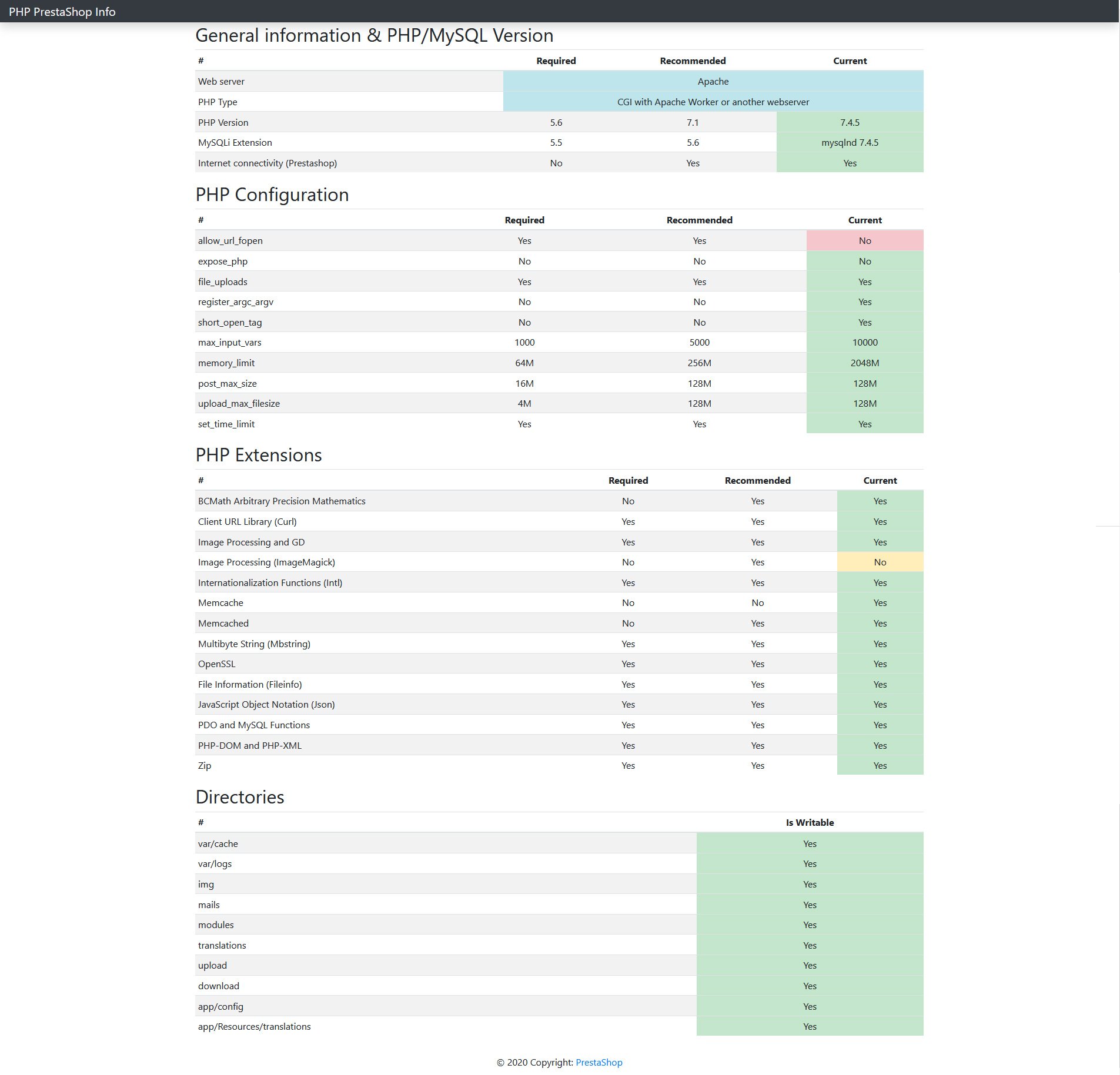

White Lion Posted May 10, 2020 Share Posted May 10, 2020 @JBW I've upload phppsinfo.php Link to comment Share on other sites More sharing options...

JBW Posted May 11, 2020 Share Posted May 11, 2020 You are running PHP 7.4 -> Prestashop is only compatible until PHP 7.2. - you need to downgrade and allow fopen (php.ini setting or in your webhosting panel or ask your webhoster) Link to comment Share on other sites More sharing options...
White Lion Posted May 12, 2020 Share Posted May 12, 2020 Dear JBW. We've changed PHP version to 7.1 and "allow_url_fopen" on. But same result. This topic mark as solved and I started a new topic. Link to comment Share on other sites More sharing options...
