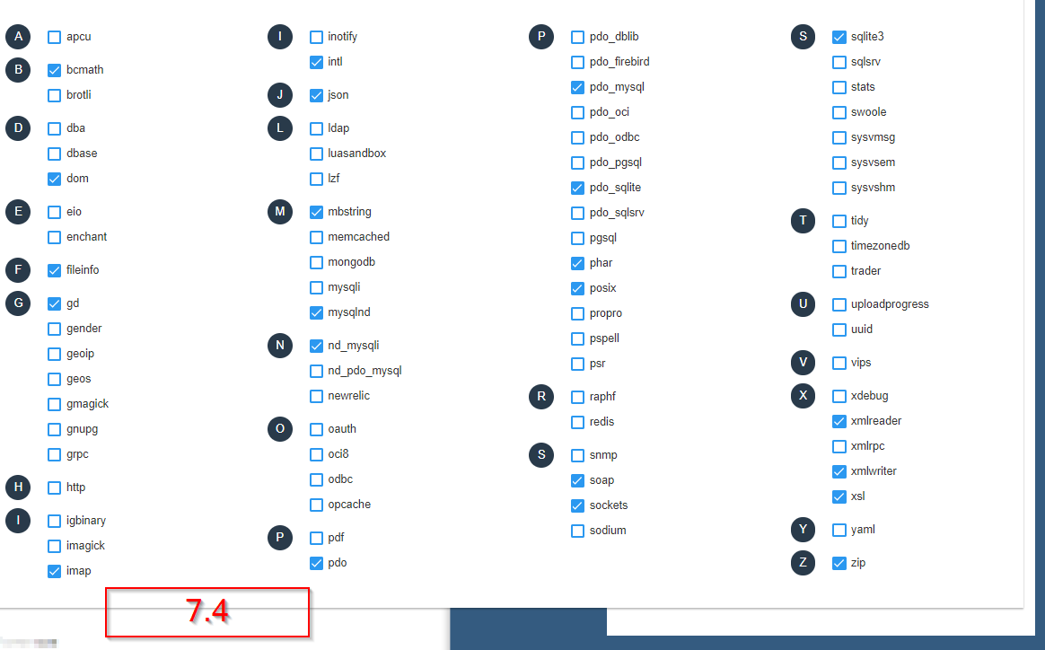

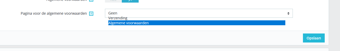

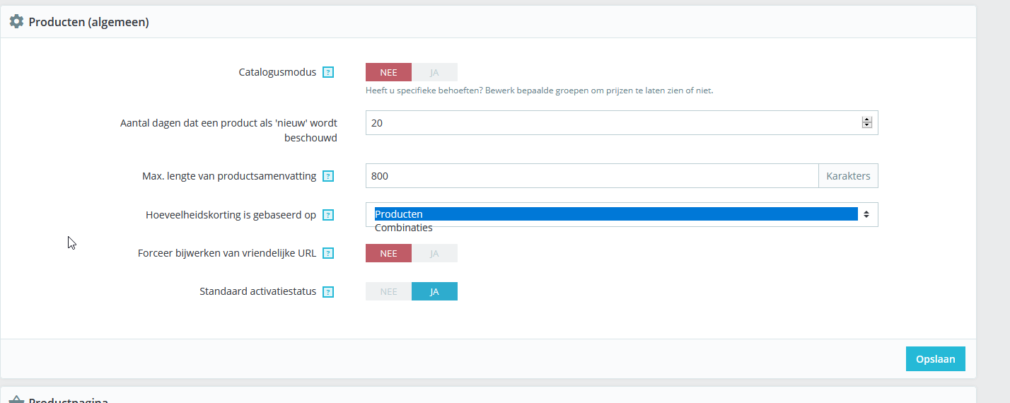

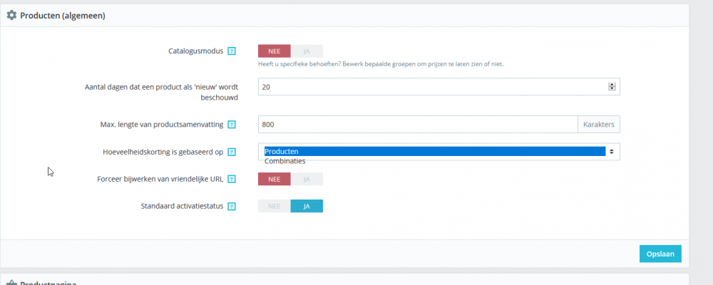

Steve-Bunker Posted May 4, 2020 Share Posted May 4, 2020 (edited) So I updated my version of Prestashop from 1.7.6.4 to 1.7.6.5. With only the default theme activated and some minor changes to it. Now after the update, the buttons dropdown menus in the settings dont seem to be working anymore: This goes for all the dropdown menu's. What should I do? Revert? I used the 1-Click upgrade module to upgrade (provided by Prestashop) All prerequisists where green. Edited May 4, 2020 by Steve-Bunker (see edit history) Link to comment Share on other sites More sharing options...
NPO Posted May 4, 2020 Share Posted May 4, 2020 Looks like the php prob. Which version (php) are you running? Link to comment Share on other sites More sharing options...

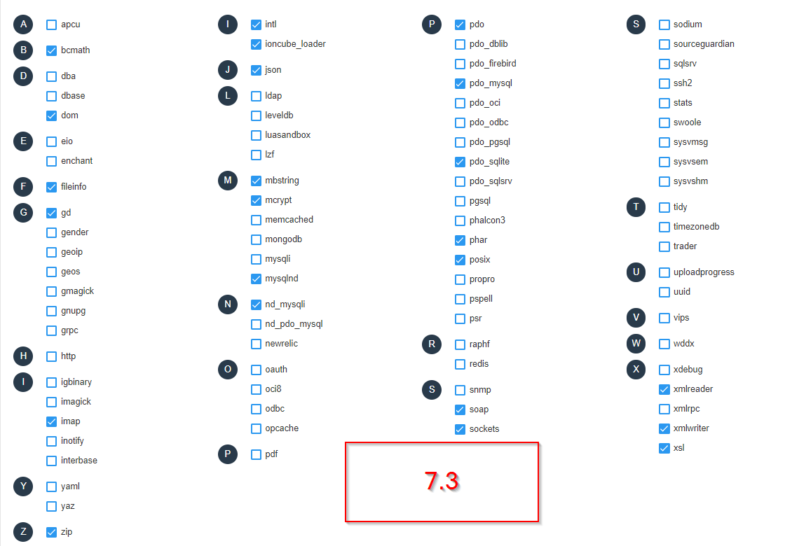

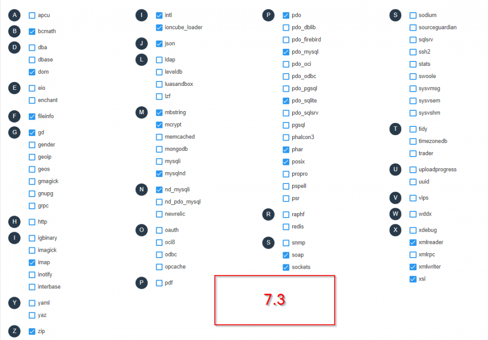

Steve-Bunker Posted May 4, 2020 Author Share Posted May 4, 2020 (edited) 46 minutes ago, NPO said: Looks like the php prob. Which version (php) are you running? You are absolutly right. Ive changed 7.4.4 back to 7.3.16 This doesnt seem to fix some of the issues I encounter so as for now I've reverted to 7.0. I will create a test version on 7.3, re install presta on their and rebuild the shop properly on the latest version. Without changing PHP versions (I only did so, because the upgrade module told me to). But on 7.3, the backend is okay but the store it self seems to have some issues. Which I do not know how to solve other than reverting to older PHP. Thread may be closed, Ive got some stuff to fix first. Thanks again! Edited May 4, 2020 by Steve-Bunker (see edit history) Link to comment Share on other sites More sharing options...

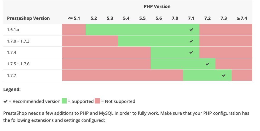

NPO Posted May 4, 2020 Share Posted May 4, 2020 Hi, even 7.3 is too high - support is up to 7.2 anything above can cause problems. Link to comment Share on other sites More sharing options...
Steve-Bunker Posted May 4, 2020 Author Share Posted May 4, 2020 Thanks for the clarification. After some tweaks, Ive got it fully functional on 7.2. I misread the version number and availablity before hence I thought 7.4 was supported. My apolgies. It was not. If I update my Prestashop from 1.7.6.4 to 1.7.6.5 it now gives me some weird other errors (like the customer assurance module beeing duplicate all over my page). I will try and replicate this on my test site and will see If I am able to fix this. Again thank yoy for the advice! The thread may be closed by a mod. Link to comment Share on other sites More sharing options...
