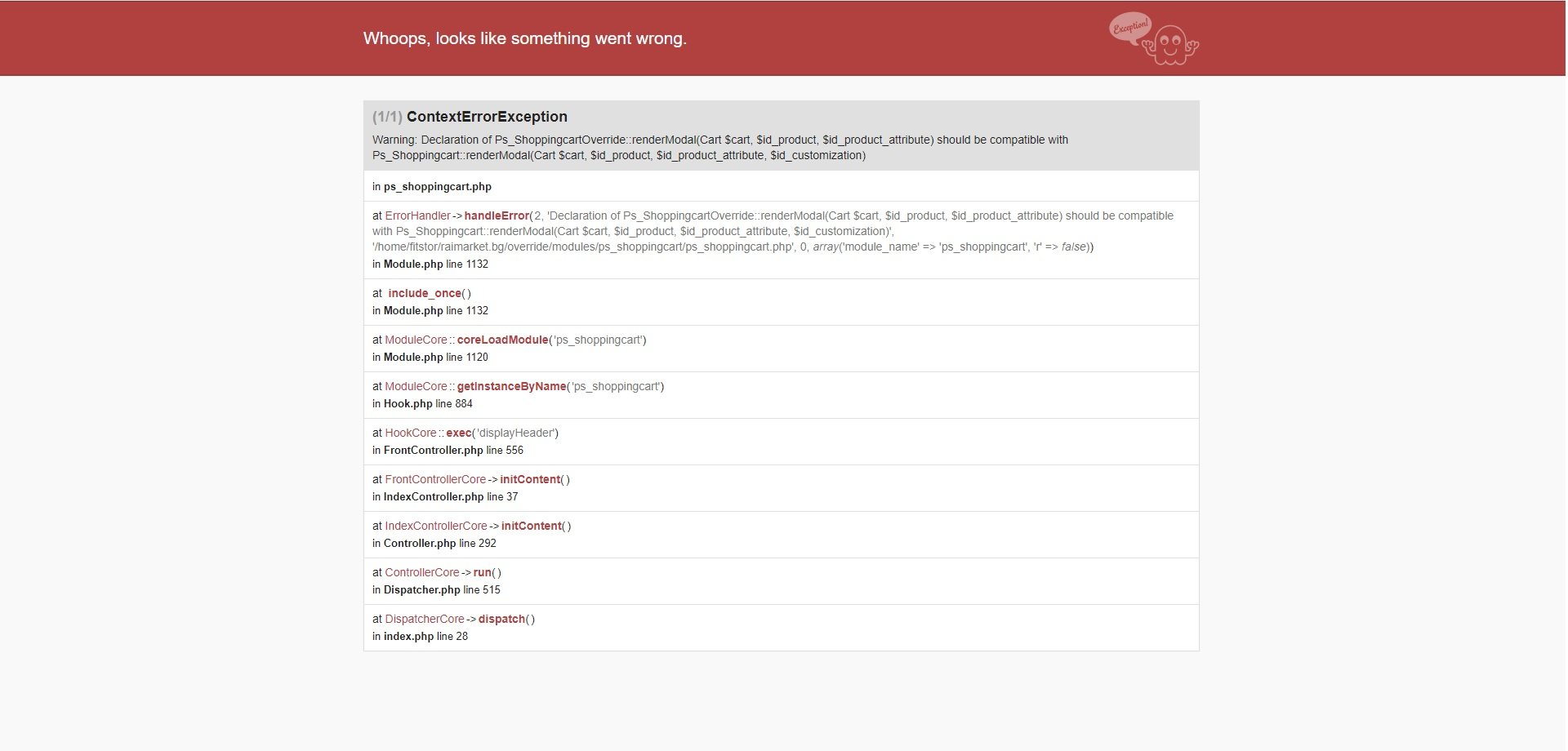

valch0 Posted May 1, 2020 Share Posted May 1, 2020 Hi guys! I am new to prestashop 1.7 and I got stuck here trying to configure some modules afer migrating. When I enter debug mode I get the following error after I migrated my shop on a new url. Also I get an error every time I try to activate or deactivate some modules without debug mode being turned on. Link to comment Share on other sites More sharing options...
idnovate.com Posted May 1, 2020 Share Posted May 1, 2020 (edited) Disable ps_shoppingcart module. Update ps_shoppingcart module with last release: https://github.com/PrestaShop/ps_shoppingcart/archive/v2.0.3.zip. Upload ZIP from the backoffice. Enable ps_shoppingcart module. Edited May 1, 2020 by idnovate.com (see edit history) Link to comment Share on other sites More sharing options...
valch0 Posted May 2, 2020 Author Share Posted May 2, 2020 I found the error in the override modules folder. The database structure in the PHP file wasn't the same. Anyway if anyone is wondering reinstalling only modules sometimes doesn't fix the problem. Link to comment Share on other sites More sharing options...
