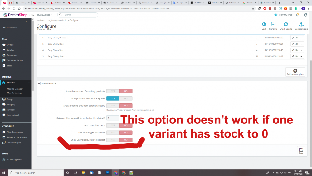

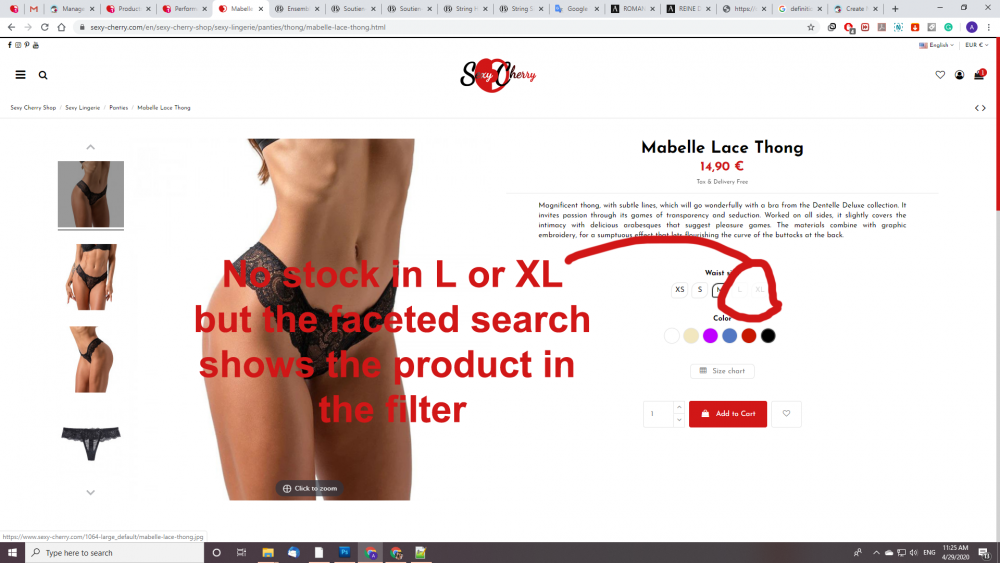

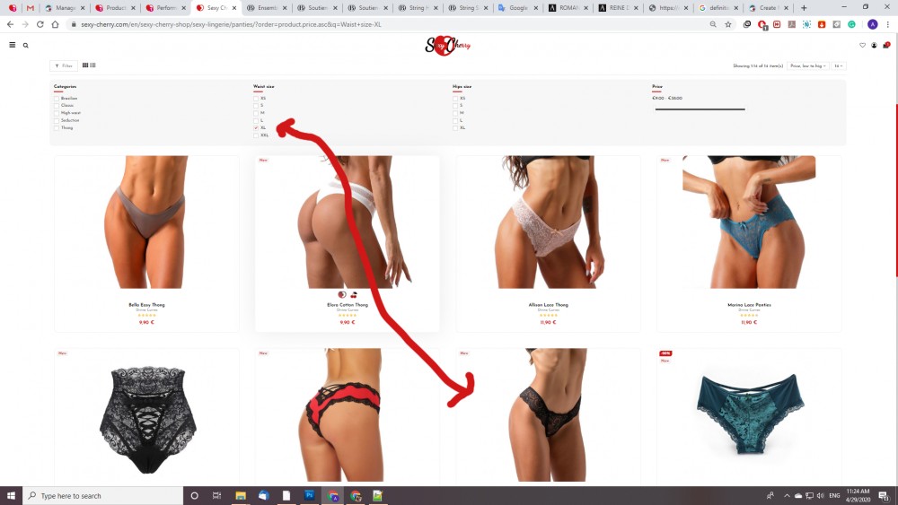

superskyman100 Posted April 29, 2020 Share Posted April 29, 2020 Hi, I already searched around this forum + google but i have no solution. - Presta 1.7.6.4 - Faceted search 3.5.0 Problem : faceted search doesn't filter attribute stock = 0 - have XXL size for product P1,P2,..., Pn - P1 have stock = 0 for XXL size - in catalog, if i use the filter attribute 'size XXL' the result shows P1..... while P1 doesn't have any stock in XXL..... - the filter shouldn't show the product P1 with size XXL cause there is no stock with this attribute Any fix ? Thanks Link to comment Share on other sites More sharing options...
