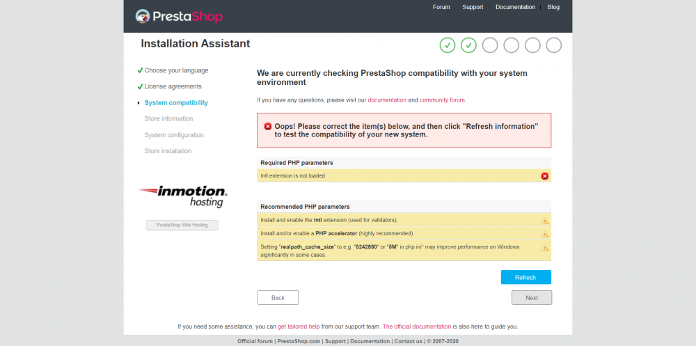

Stavros234 Posted April 28, 2020 Share Posted April 28, 2020 Dear friends, Have installed PrestaShop locally with XAMP, Have runned instalation but appeared the following error messages: 1)Install and enable the intl extension (used for validators). 2)Install and/or enable a PHP accelerator (highly recommended). 3)nstall and/or enable a PHP accelerator (highly recommended). Please if you could assist, Thank You, Stavros Link to comment Share on other sites More sharing options...
JBW Posted April 29, 2020 Share Posted April 29, 2020 You have to enable Intl extension and adjust the realpath_cache_size setting in your php.ini configuration file. Link to comment Share on other sites More sharing options...

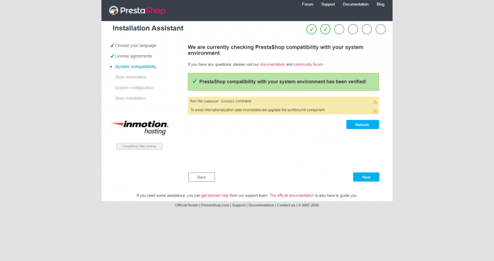

Stavros234 Posted April 29, 2020 Author Share Posted April 29, 2020 Thank You for assistance, Have enable intl, but appeard some other installation warnings. If you could mention what do. Thank You again, Link to comment Share on other sites More sharing options...
JBW Posted April 30, 2020 Share Posted April 30, 2020 Have you installed dev/GIT version? Then you need composer to install the dependencies... Or you install the zipped release packed containing everything And your intl seems to be wrong version - which XAMPP/PHP Version are you running? Link to comment Share on other sites More sharing options...

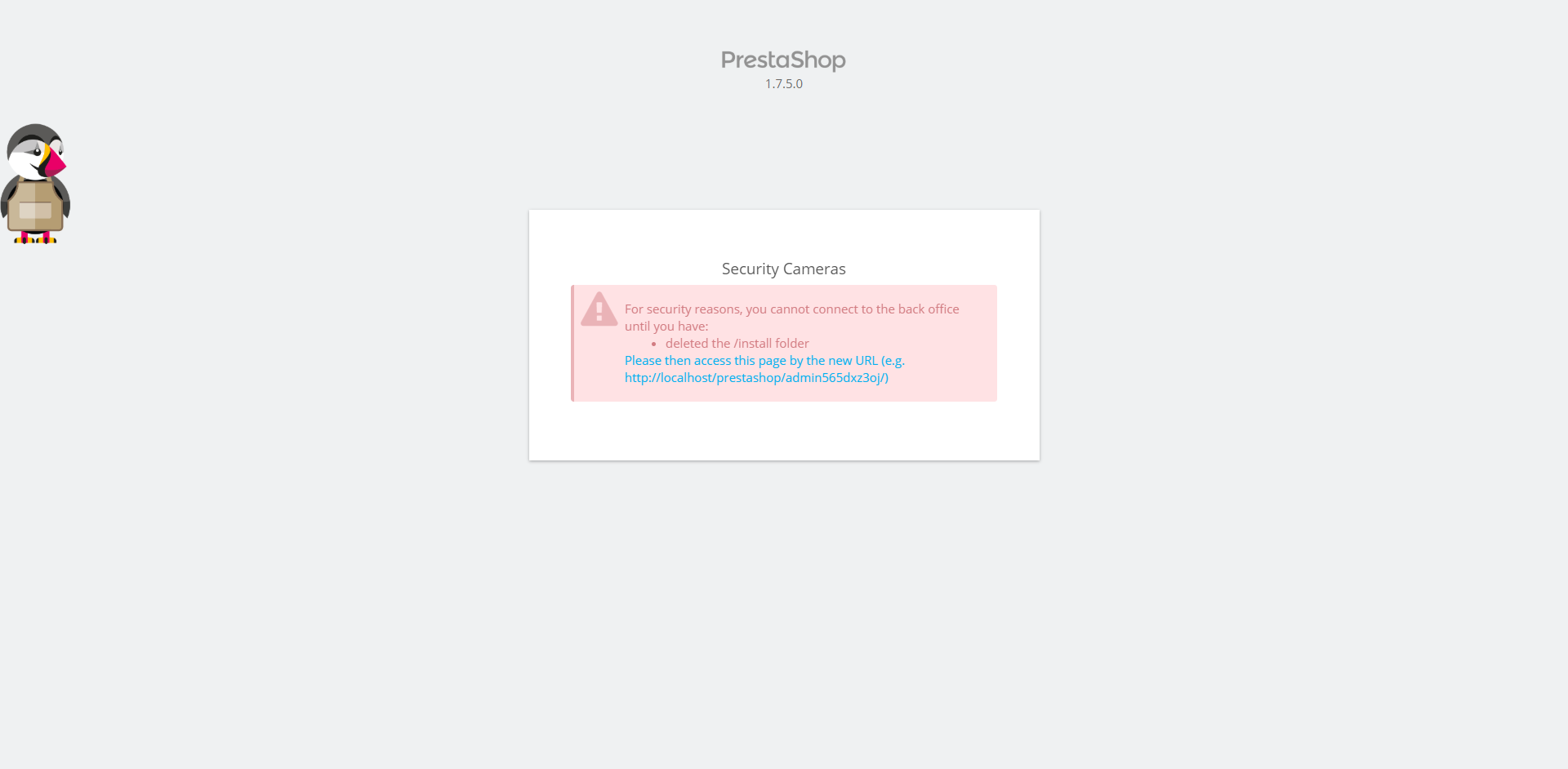

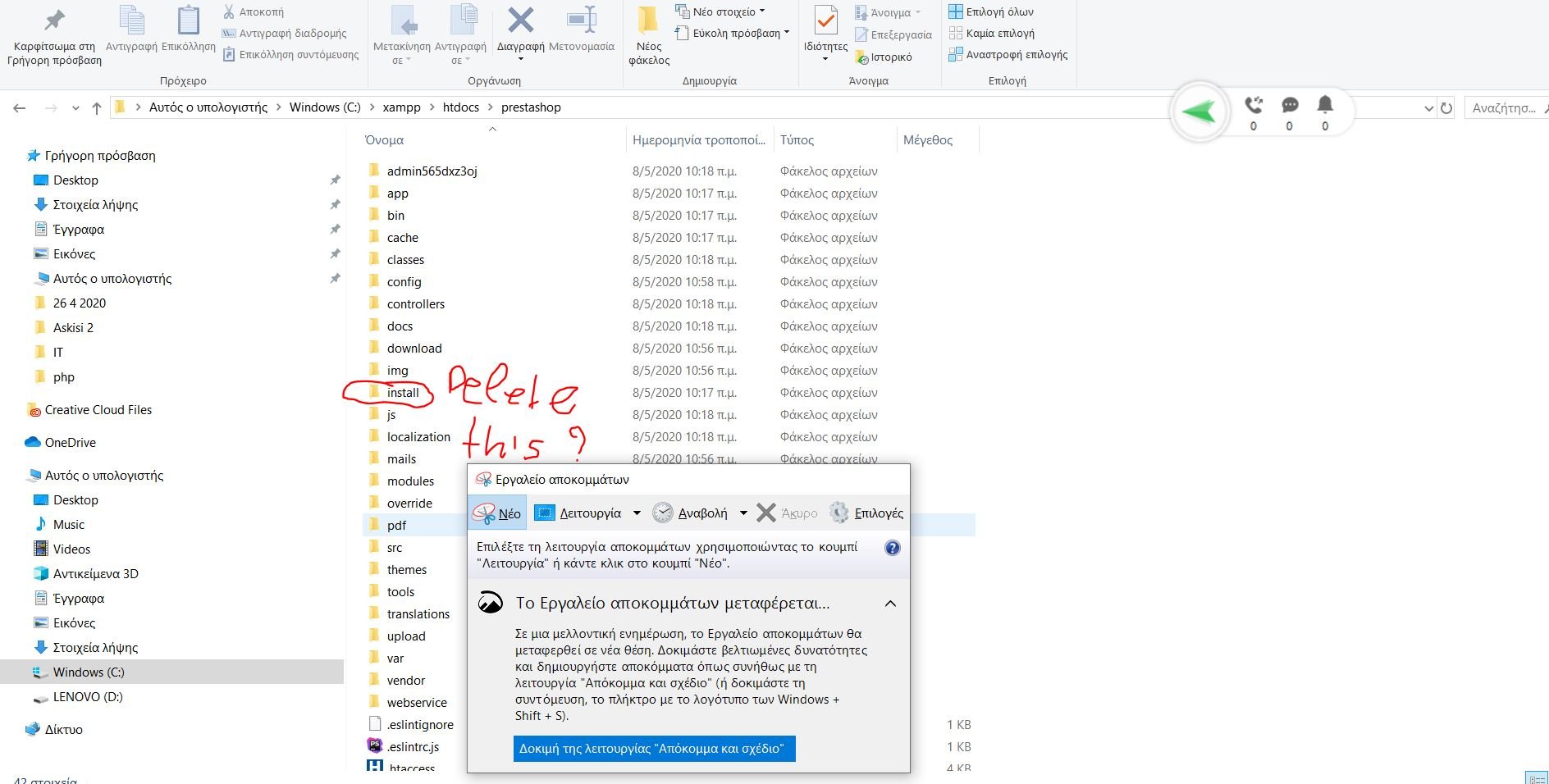

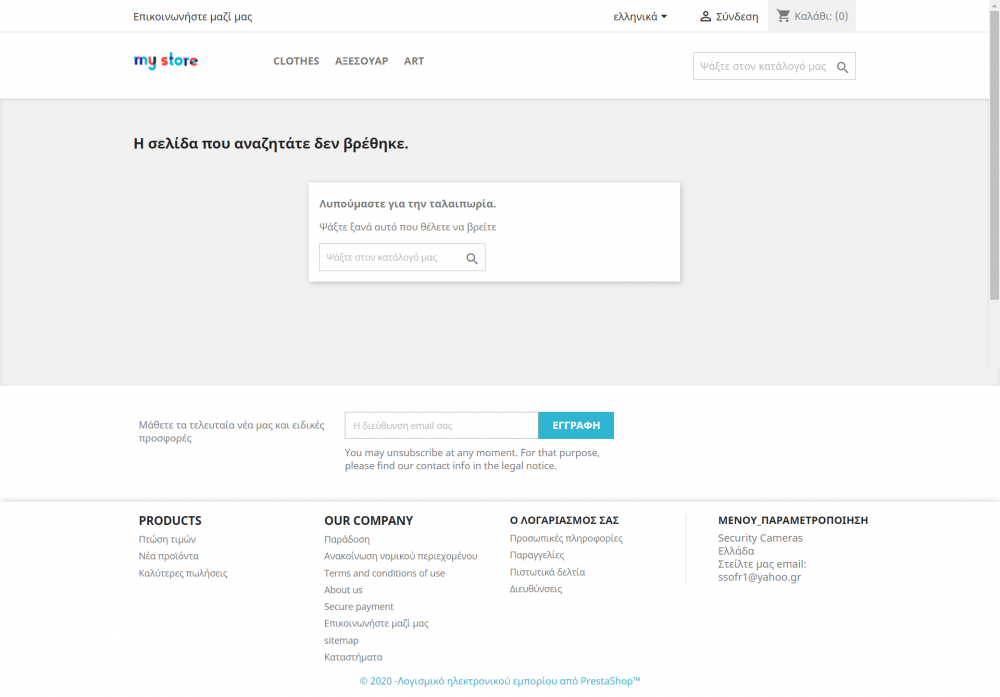

Stavros234 Posted May 8, 2020 Author Share Posted May 8, 2020 (edited) Thank You, Have installled succesfully PrestaShop, even have a warning messaga about Symfony . However when firstly clicked Manage my Store appear a page mentioning Delete Installarion Folder. It is a photo named Delete install folder.png After clicked again Manage my Store and in the 2nd time appearing a page mentioning "The page you are searching was not founded" It is a photo named Back_End 2nd loading.png The front end page appears fine. Need to delete install folder as shown in the photo? What other is needed to do? Thank You, Edited May 8, 2020 by Stavros234 (see edit history) Link to comment Share on other sites More sharing options...
JBW Posted May 8, 2020 Share Posted May 8, 2020 Yes delete the install folder Link to comment Share on other sites More sharing options...
