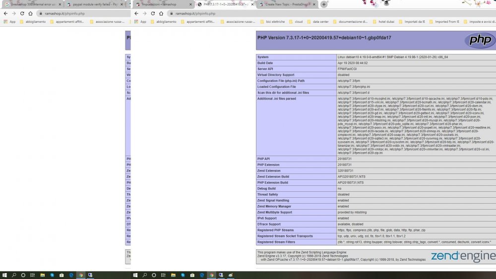

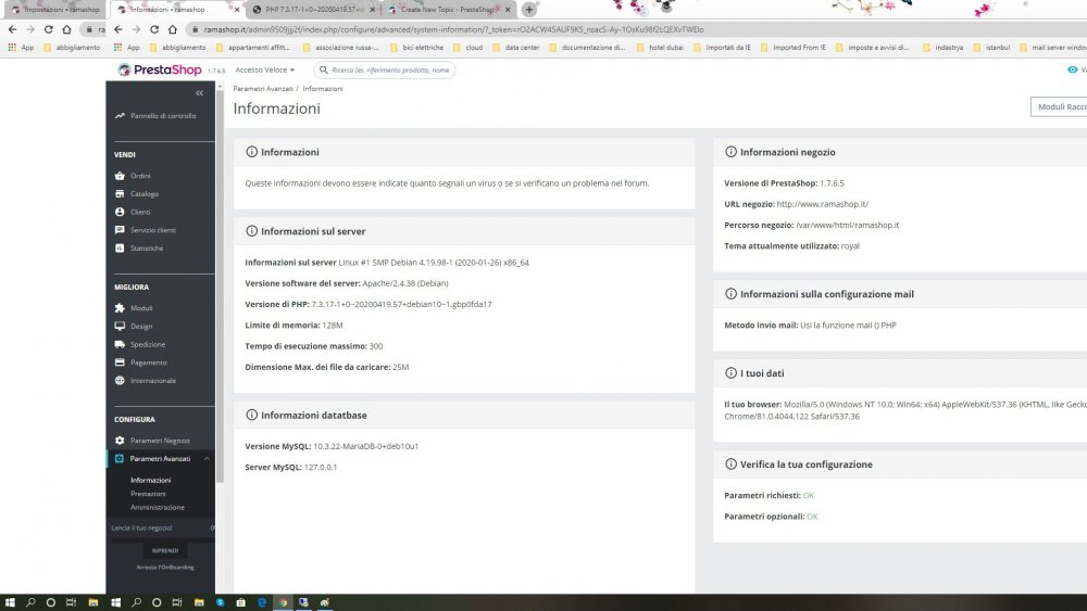

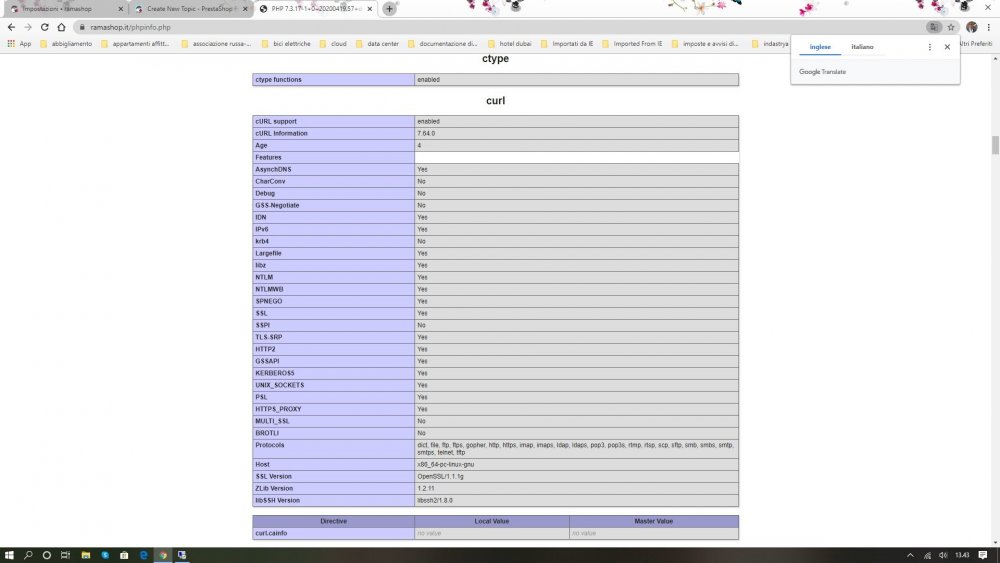

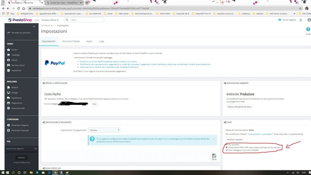

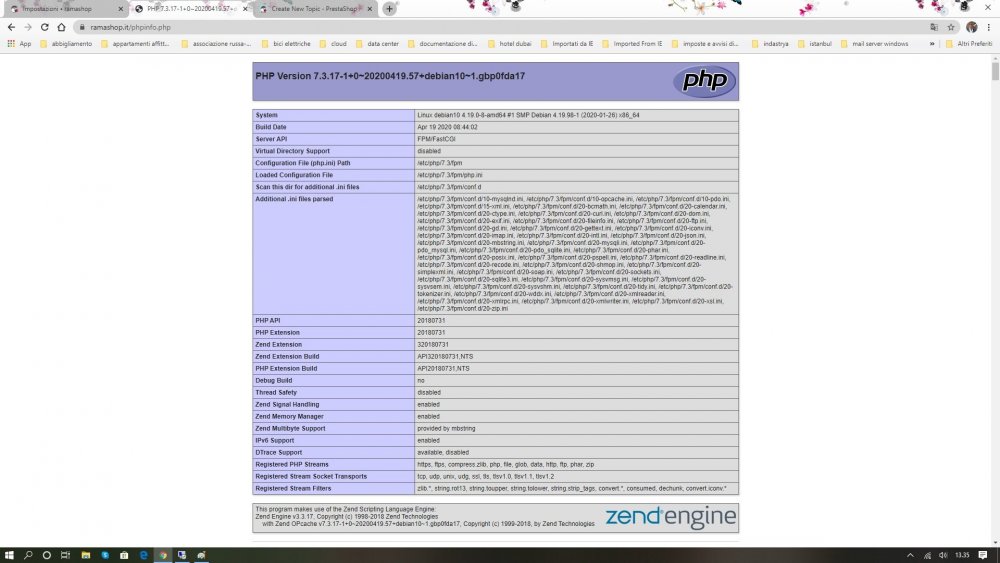

giuseppe ielo Posted April 23, 2020 Share Posted April 23, 2020 Buongiorno, ricevo questo errore ma l'estensione è attiva sul server. Non capisco perche! Allego immagini relative alla connessione, phpinfo e versione ultima di prestashop installata. Ho gia pulito cache ma non ottengo nulla Qualcuno puo aiutarmi. Grazie q Grazie Link to comment Share on other sites More sharing options...

PS.6thFNGR Posted April 26, 2020 Share Posted April 26, 2020 Just activate the Live mode! He can not check for cURL when in Test Mode! had the same issue, worked for me. Greets Link to comment Share on other sites More sharing options...
giuseppe ielo Posted April 28, 2020 Author Share Posted April 28, 2020 On 4/27/2020 at 12:26 AM, PS.6thFNGR said: Just activate the Live mode! He can not check for cURL when in Test Mode! had the same issue, worked for me. Greets i did. not work. Link to comment Share on other sites More sharing options...
PS.6thFNGR Posted May 1, 2020 Share Posted May 1, 2020 Im sorry for you, but its still the same for me. Whenever I go into Sandbox Mode, or disable the module, he claims he got no cURL. Whenever I just activate/enable everything and go to production mode - tada - cURL checkbox is marked. Link to comment Share on other sites More sharing options...
giuseppe ielo Posted May 3, 2020 Author Share Posted May 3, 2020 i tried this way, but still not work!! Link to comment Share on other sites More sharing options...
davidebovolenta Posted November 19, 2020 Share Posted November 19, 2020 (edited) On 5/3/2020 at 10:25 AM, giuseppe ielo said: i tried this way, but still not work!! Qualcuno ha trovato la soluzione a questo "problema"? Io ho lo stesso problema con hosting su register. cURL è attivo ma prestashop lo indica come mancante... ???? PS: son scemo... o quantomeno bollito: se hai il negozio in MANUTENZIONE non solo il cURL non funziona (e non viene visto) ma nemmeno i test con pagamenti con carta di credito funzionano. Edited November 19, 2020 by davidebovolenta (see edit history) 1 1 Link to comment Share on other sites More sharing options...
