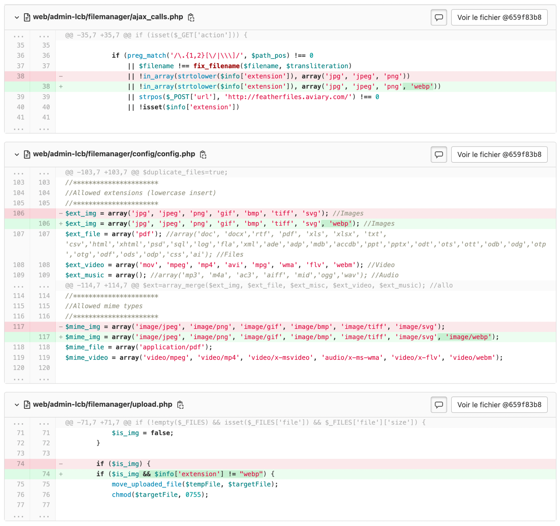

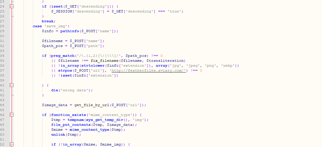

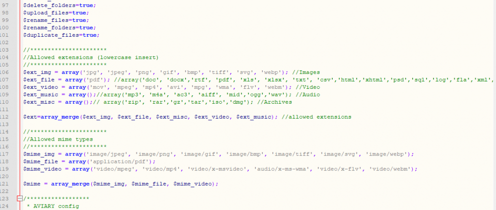

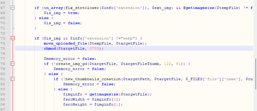

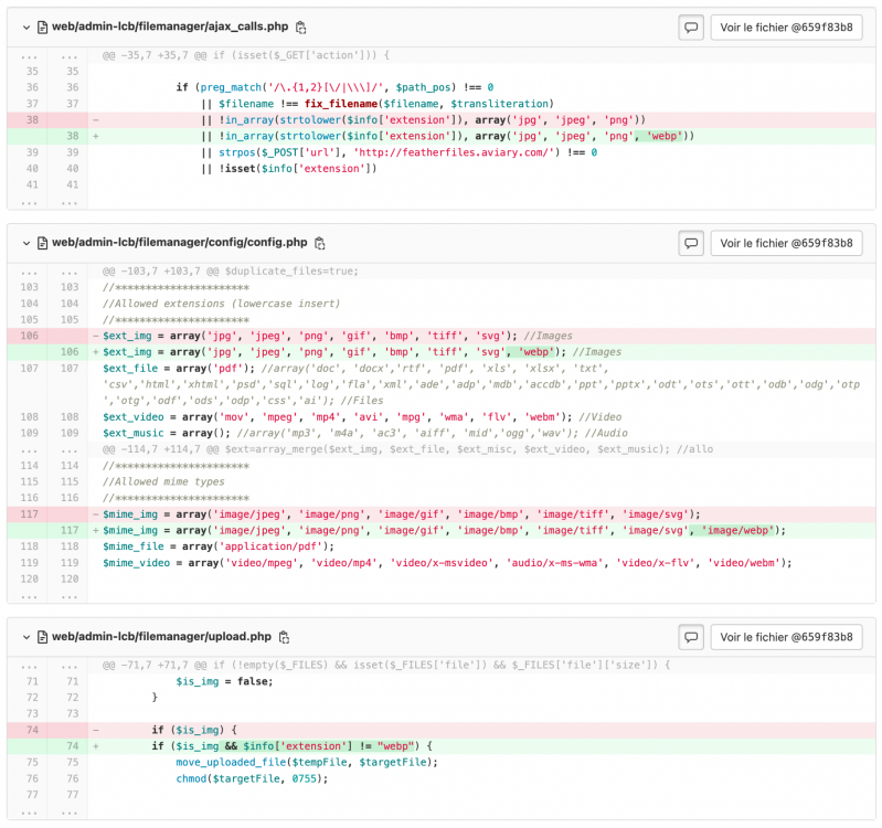

On 8/21/2022 at 2:41 PM, NicolasV said:
I think it's worth a try, especially since the solution I implemented is in production on a 1.7 (and working).
I tried your solution in version 1.7.8.7 but it doesn't work. I also tried clearing the cache but nothing. Do you have any suggestions?
Thanks in advance ;)
