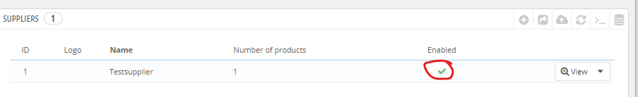

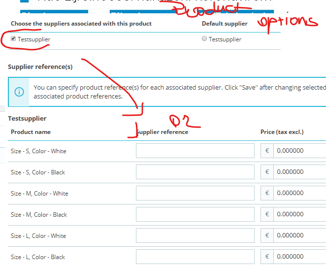

EvaF Posted April 20, 2020 Share Posted April 20, 2020 I am a little confused - why do not you complete suppliers(enabled) into products? and Link to comment Share on other sites More sharing options...
MichalT Posted April 20, 2020 Author Share Posted April 20, 2020 I was not thinking along these lines because from the outset I thought of using supplier id, which is an integer. What you suggest is supplier reference. But I tried it now and ps_product table in the database does not get updated with the data (column supplier_reference) therefore $product.id_supplier will not return any value if used in tpl file. Link to comment Share on other sites More sharing options...

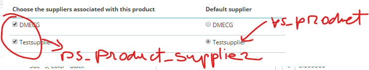

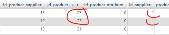

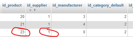

EvaF Posted April 20, 2020 Share Posted April 20, 2020 (edited) no, if you set suppliers in Product/Options, then default supplier is stored in the table ps_product and all selected suppliers are stored inps_product_supplier table Edited April 20, 2020 by EvaF (see edit history) Link to comment Share on other sites More sharing options...
MichalT Posted April 20, 2020 Author Share Posted April 20, 2020 Oh my... it works. I have not ticked off the default supplier option, only the "Choose the suppliers..." You have my gratitude. Thank you! Link to comment Share on other sites More sharing options...
