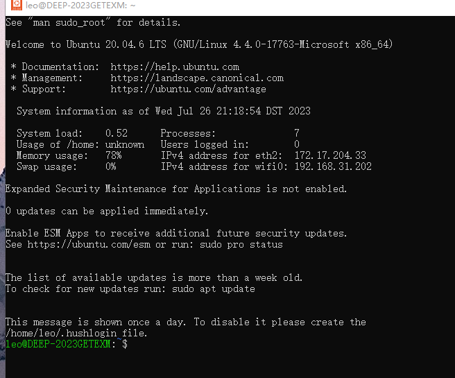

zhanyia23 Posted July 26, 2023 Share Posted July 26, 2023 12 hours ago, Yggdrasill said: Hi @zhanyia23, How did you install your PrestaShop? Run a `cp .env.dist .env` and change the PROJECT_NAME variable Then, you can copy PrestaShop files inside the `www` folder and run `docker-compose up -d` And if you are using macOS or Linux, you can use OrbStack : https://orbstack.dev/ Link to comment Share on other sites More sharing options...
zhanyia23 Posted July 26, 2023 Share Posted July 26, 2023 On 9/6/2020 at 6:12 PM, webspilka said: cool, with this config everything works dozens of times faster)) thank you Yggdrasill are you use the windows sys ! how do you set code Link to comment Share on other sites More sharing options...
Yggdrasill Posted July 26, 2023 Author Share Posted July 26, 2023 (edited) I've never used this repository for Windows Maybe it needs some modifications to work Edited July 26, 2023 by Yggdrasill (see edit history) Link to comment Share on other sites More sharing options...

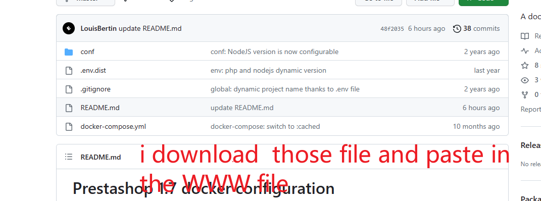

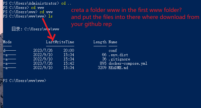

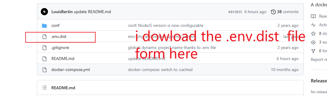

Yggdrasill Posted July 26, 2023 Author Share Posted July 26, 2023 You seems to have an issue with my Docker repository : - You have to clone everything from here : https://github.com/LouisBertin/prestashop1.7-docker-lamp - Then, select the PrestaShop version you need : https://prestashop.fr/versions/ - Extract the content in a `www` folder at the root of the files you get from here : https://github.com/LouisBertin/prestashop1.7-docker-lamp Link to comment Share on other sites More sharing options...

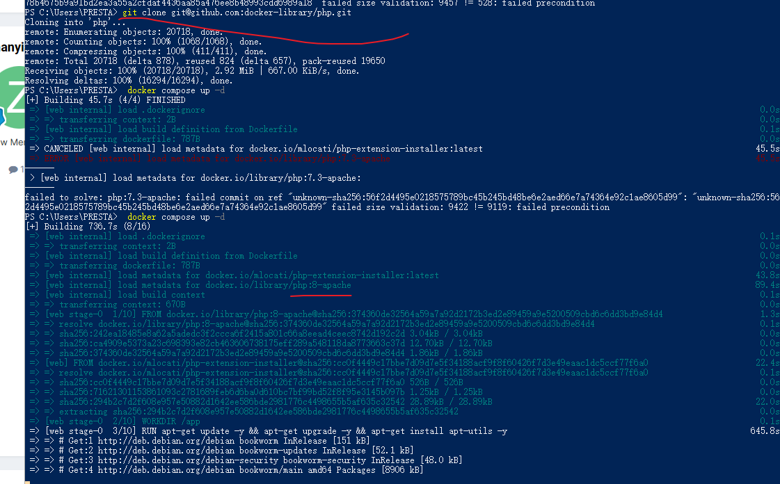

zhanyia23 Posted July 26, 2023 Share Posted July 26, 2023 4 minutes ago, Yggdrasill said: You seems to have an issue with my Docker repository : - You have to clone everything from here : https://github.com/LouisBertin/prestashop1.7-docker-lamp - Then, select the PrestaShop version you need : https://prestashop.fr/versions/ - Extract the content in a `www` folder at the root of the files you get from here : https://github.com/LouisBertin/prestashop1.7-docker-lamp i dont understand the www folder which is you see my picture i copy the prestashop file in the folder Link to comment Share on other sites More sharing options...
zhanyia23 Posted July 26, 2023 Share Posted July 26, 2023 13 minutes ago, Yggdrasill said: You seems to have an issue with my Docker repository : - You have to clone everything from here : https://github.com/LouisBertin/prestashop1.7-docker-lamp - Then, select the PrestaShop version you need : https://prestashop.fr/versions/ - Extract the content in a `www` folder at the root of the files you get from here : https://github.com/LouisBertin/prestashop1.7-docker-lamp is it right??? Link to comment Share on other sites More sharing options...

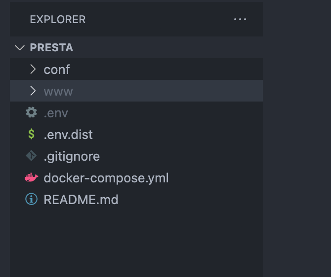

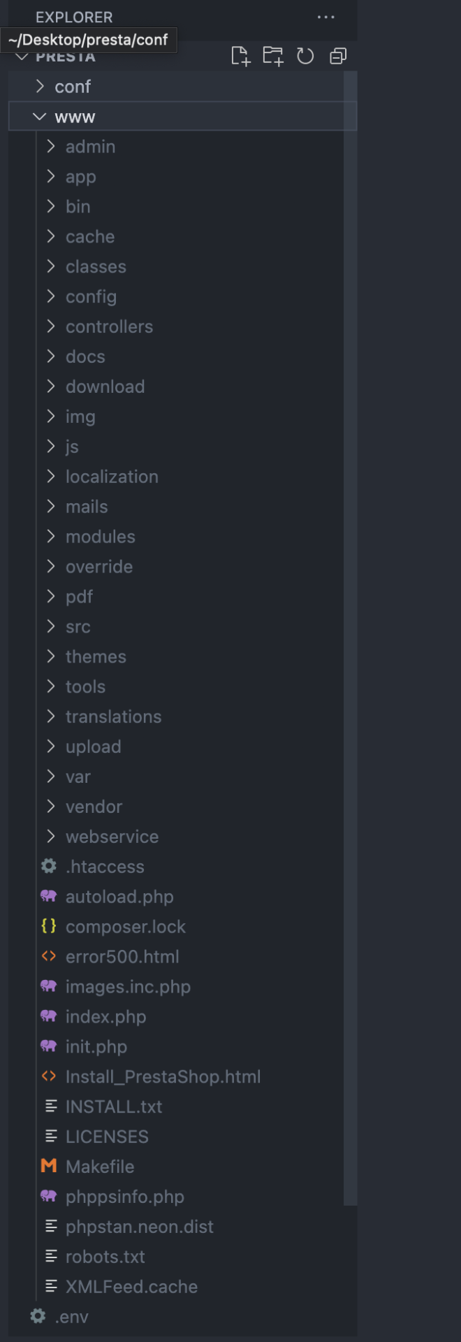

Yggdrasill Posted July 26, 2023 Author Share Posted July 26, 2023 On the first pic, you can see my root directory And all PrestShop files in the www directory Link to comment Share on other sites More sharing options...
zhanyia23 Posted July 26, 2023 Share Posted July 26, 2023 1 minute ago, Yggdrasill said: On the first pic, you can see my root directory And all PrestShop files in the www directory ok i m going to try ! Link to comment Share on other sites More sharing options...

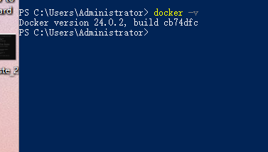

zhanyia23 Posted July 26, 2023 Share Posted July 26, 2023 10 minutes ago, Yggdrasill said: On the first pic, you can see my root directory And all PrestShop files in the www directory Link to comment Share on other sites More sharing options...
Yggdrasill Posted July 26, 2023 Author Share Posted July 26, 2023 (edited) You can keep the 12 version. This is why the project is run into docker containers. You can use a different NodeJS version of the one installed on your system And PrestaShop recommandations are to use the NodeJS 12 with the 1.7.X version Edited July 26, 2023 by Yggdrasill (see edit history) Link to comment Share on other sites More sharing options...
zhanyia23 Posted July 26, 2023 Share Posted July 26, 2023 5 minutes ago, Yggdrasill said: You can keep this version. This is why the project is run into docker containers. You can use a different NodeJS version of the one installed on your system the same old error about php oh my god Link to comment Share on other sites More sharing options...

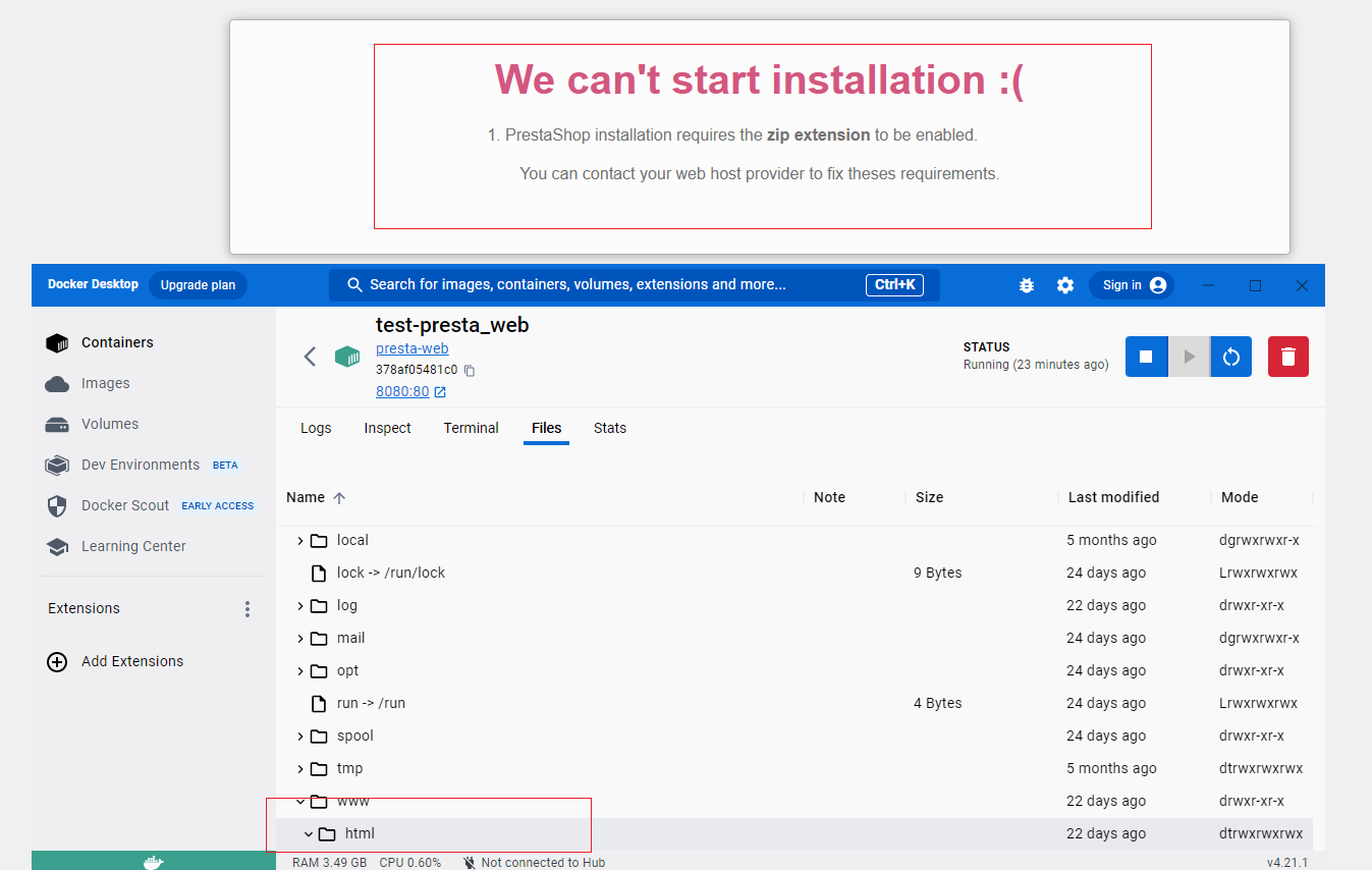

Yggdrasill Posted July 26, 2023 Author Share Posted July 26, 2023 You seem to have an error related to file copy before Link to comment Share on other sites More sharing options...

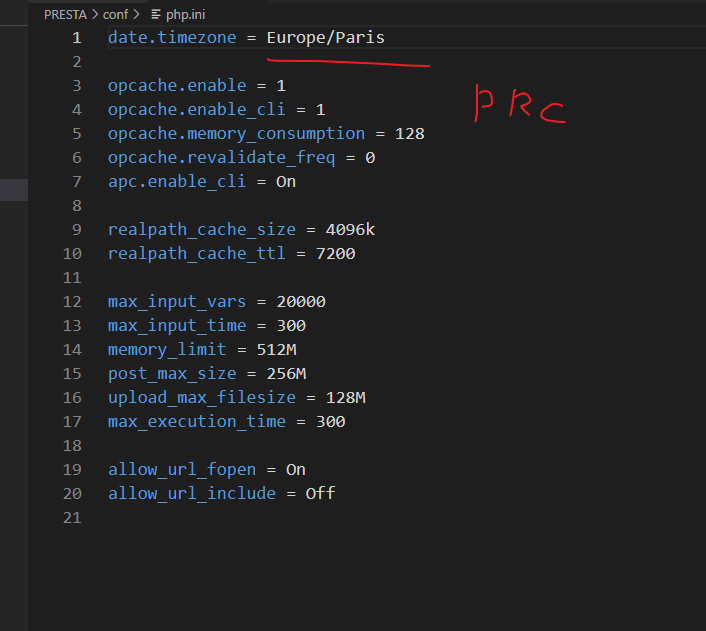

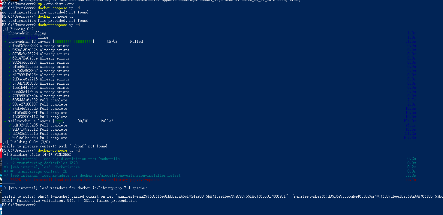

zhanyia23 Posted July 26, 2023 Share Posted July 26, 2023 5 minutes ago, Yggdrasill said: You seem to have an error related to file copy before i dont know where i did wrong maybe in here about php stuff Link to comment Share on other sites More sharing options...
Yggdrasill Posted July 26, 2023 Author Share Posted July 26, 2023 (edited) Yes its better to use UTC for the date.timezone I'll change it Which version of windows are you using ? And how did you install Docker ? Edited July 26, 2023 by Yggdrasill (see edit history) Link to comment Share on other sites More sharing options...

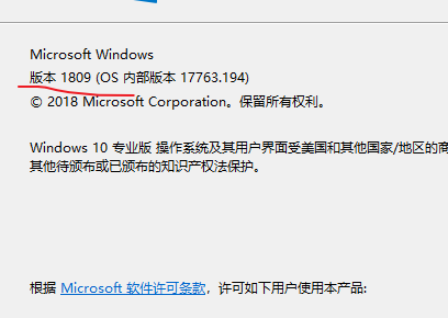

zhanyia23 Posted July 26, 2023 Share Posted July 26, 2023 7 minutes ago, Yggdrasill said: Yes its better to use UTC for the date.timezone I'll change it Which version of windows are you using ? And how did you install Docker ? i installed docker desktop version cause the version of windows is pretty low so i installed WSL 1 Link to comment Share on other sites More sharing options...

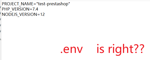

Yggdrasill Posted July 26, 2023 Author Share Posted July 26, 2023 (edited) Quite an old version but it has to work. Run `cp .env.dist .env` and replace the value for `PROJECT_NAME` Then : `docker-compose up -d --build`, to rebuild each containers Edited July 26, 2023 by Yggdrasill (see edit history) Link to comment Share on other sites More sharing options...

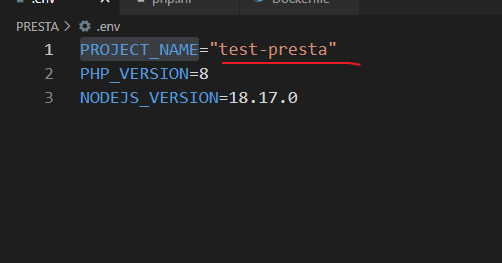

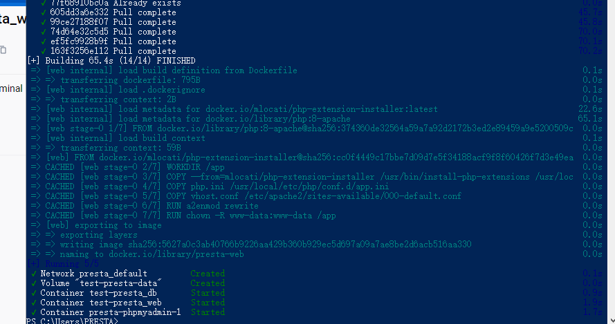

zhanyia23 Posted July 26, 2023 Share Posted July 26, 2023 3 minutes ago, Yggdrasill said: Quite an old version but it has to work. Run `cp .env.dist .env` and replace the value for `PROJECT_NAME` Then : `docker-compose up -d --build`, to rebuild each containers the PROJECT_NAME is from customize? Or any other name Link to comment Share on other sites More sharing options...

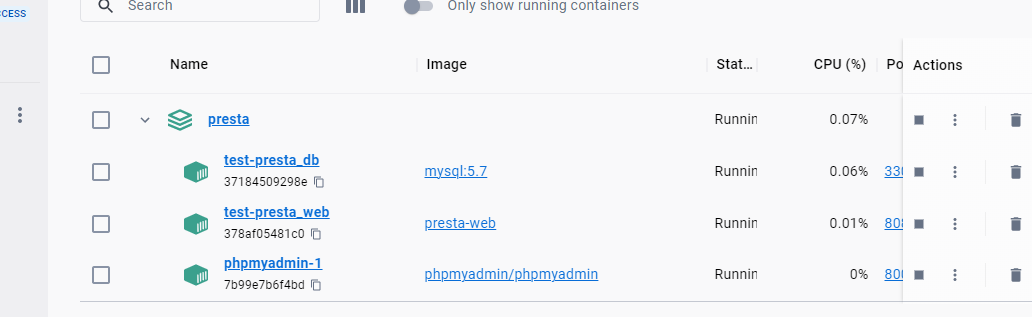

zhanyia23 Posted July 26, 2023 Share Posted July 26, 2023 (edited) 9 minutes ago, Yggdrasill said: Quite an old version but it has to work. Run `cp .env.dist .env` and replace the value for `PROJECT_NAME` Then : `docker-compose up -d --build`, to rebuild each containers just now i git a php rep 8 version it 's too long adn i m waiting it Edited July 26, 2023 by zhanyia23 (see edit history) Link to comment Share on other sites More sharing options...

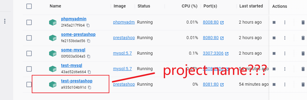

Yggdrasill Posted July 26, 2023 Author Share Posted July 26, 2023 Yes, test-presta is good But leave the original values for PHP_VERSION and NODEJS_VERSION. You'll get errors if you change them: PHP_VERSION=7.4 NODEJS_VERSION=12 Link to comment Share on other sites More sharing options...
zhanyia23 Posted July 26, 2023 Share Posted July 26, 2023 9 minutes ago, Yggdrasill said: Yes, test-presta is good But leave the original values for PHP_VERSION and NODEJS_VERSION. You'll get errors if you change them: PHP_VERSION=7.4 NODEJS_VERSION=12 Give up? cost 30min..... and dont know how long Link to comment Share on other sites More sharing options...
zhanyia23 Posted July 26, 2023 Share Posted July 26, 2023 16 minutes ago, Yggdrasill said: Yes, test-presta is good But leave the original values for PHP_VERSION and NODEJS_VERSION. You'll get errors if you change them: PHP_VERSION=7.4 NODEJS_VERSION=12 my gosh new error~~~ Link to comment Share on other sites More sharing options...
zhanyia23 Posted July 26, 2023 Share Posted July 26, 2023 1 hour ago, Yggdrasill said: Yes, test-presta is good But leave the original values for PHP_VERSION and NODEJS_VERSION. You'll get errors if you change them: PHP_VERSION=7.4 NODEJS_VERSION=12 I successfully installed with php8 PrestaShop installation requires the zip extension to be enabled. figure it out in the php.ini ??? but the html folder in the docker is null???? the local prestashop files are not mapped on docker ~~~~ Link to comment Share on other sites More sharing options...

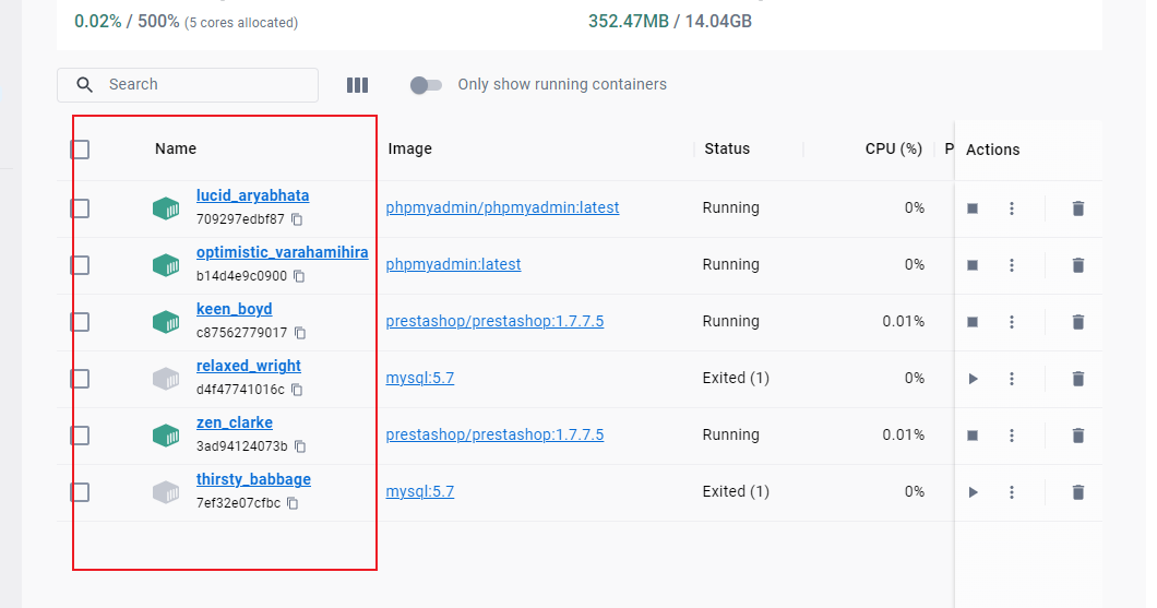

Yggdrasill Posted July 26, 2023 Author Share Posted July 26, 2023 (edited) I think you have to learn more about Docker because it works out of the box. Your issue seem related to Docker volumes Here is the result when I copy PrestaShop installation files into the `www` folder Edited July 26, 2023 by Yggdrasill (see edit history) Link to comment Share on other sites More sharing options...

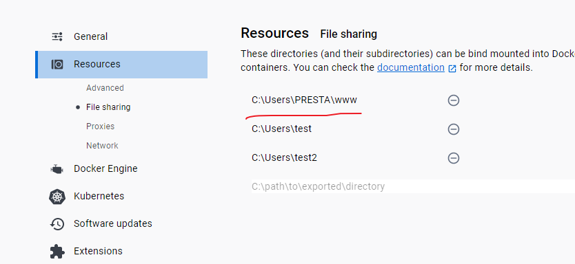

zhanyia23 Posted July 27, 2023 Share Posted July 27, 2023 11 hours ago, Yggdrasill said: I think you have to learn more about Docker because it works out of the box. Your issue seem related to Docker volumes Here is the result when I copy PrestaShop installation files into the `www` folder did you make the setting what could sharing file between the local to docker online Link to comment Share on other sites More sharing options...
Yggdrasill Posted July 27, 2023 Author Share Posted July 27, 2023 (edited) It's different on macOS. But I think you should add this path: C:\Users\PRESTA\ Be careful, I think you should have your username inside the path : Run the command `pwd` on Linux subsystem and `cd` on Windows to get your path Edited July 27, 2023 by Yggdrasill (see edit history) Link to comment Share on other sites More sharing options...
zhanyia23 Posted July 29, 2023 Share Posted July 29, 2023 On 7/27/2023 at 7:18 PM, Yggdrasill said: It's different on macOS. But I think you should add this path: C:\Users\PRESTA\ Be careful, I think you should have your username inside the path : Run the command `pwd` on Linux subsystem and `cd` on Windows to get your path thank you very much !!! with me slove these problem ~ I I have already used the vscode with the "remote ssh" plugin to conect service . actually,i have a macbook air 2015 but it pretty slowly. maybe I want to try set your code to my mac and look forward to a successful with docker compose~~ Link to comment Share on other sites More sharing options...
