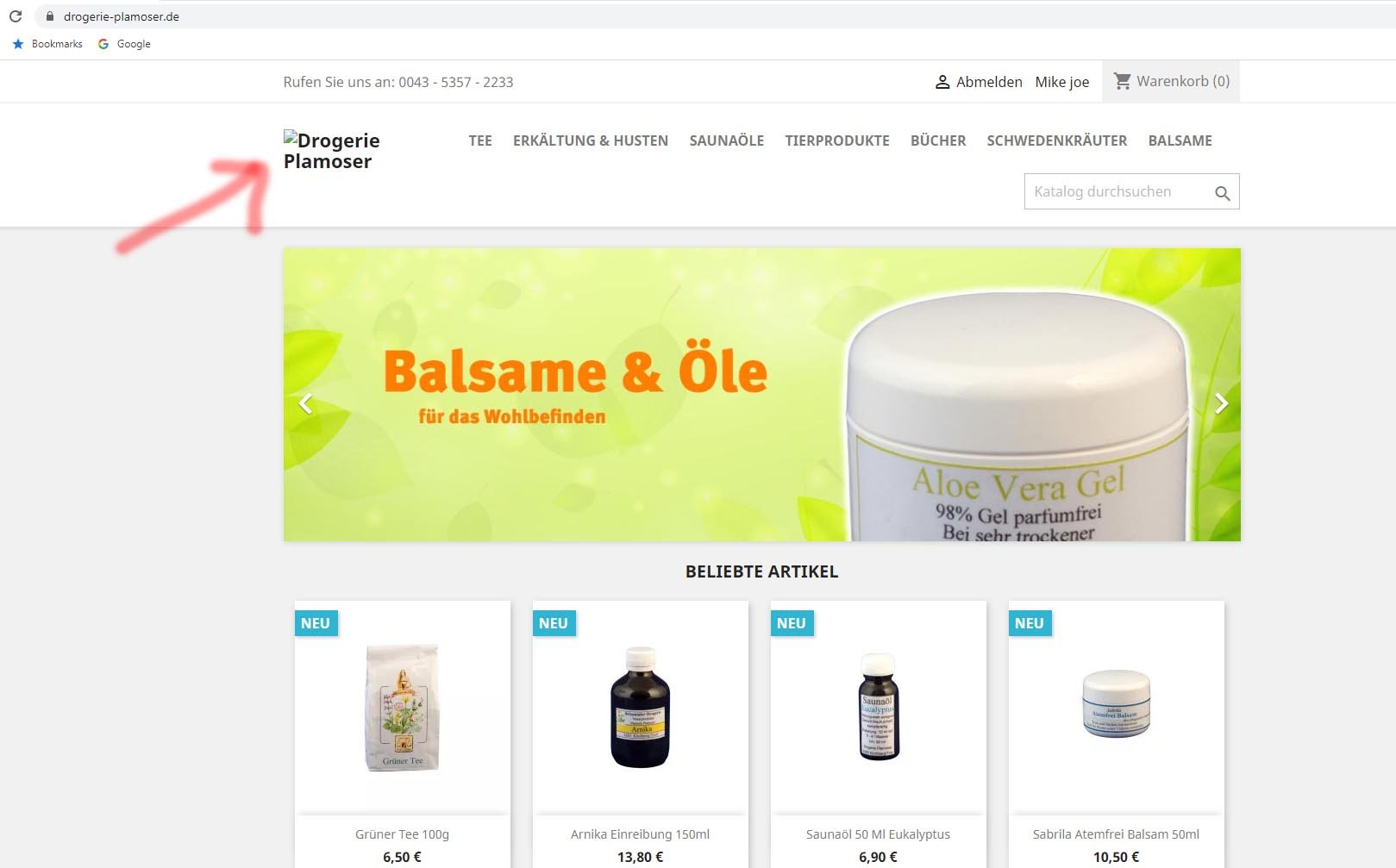

mikejoebstl Posted April 15, 2020 Share Posted April 15, 2020 hello, i have just installed and configured presta 1.7.6.3 with theme classic Version 1.0.0 i have uploaded a 22kb size PNG logo for header, email and invoice the upload is without issue, directly after upload, the frontend shows the logo, but when i go from HOME site to other page of my shop-site, then back to home, the logo disappered never come back on the webspace i see the logo.png in the folder /img Link to comment Share on other sites More sharing options...

JBW Posted April 15, 2020 Share Posted April 15, 2020 Maybe something wrong with the pagespeed module you are using - try to deactivate it and if this solves the issue. Btw. Why did you install this old version? It has a major security issue - customer data can be stolen - you should upgrade to 1.7.6.4! 7 hours ago, mikejoebstl said: presta 1.7.6.3 Link to comment Share on other sites More sharing options...

mikejoebstl Posted April 16, 2020 Author Share Posted April 16, 2020 10 hours ago, JBW said: Maybe something wrong with the pagespeed module you are using - try to deactivate it and if this solves the issue. i dont have any page speed modul installed ? Link to comment Share on other sites More sharing options...
JBW Posted April 16, 2020 Share Posted April 16, 2020 26 minutes ago, mikejoebstl said: i dont have any page speed modul installed ? Not a Prestashop, but a Webserver module, problably Apache Pagespeed Mod Link to comment Share on other sites More sharing options...
mikejoebstl Posted April 16, 2020 Author Share Posted April 16, 2020 1 hour ago, JBW said: Not a Prestashop, but a Webserver module, problably Apache Pagespeed Mod its deactivated, and its working !!! thank you Link to comment Share on other sites More sharing options...
