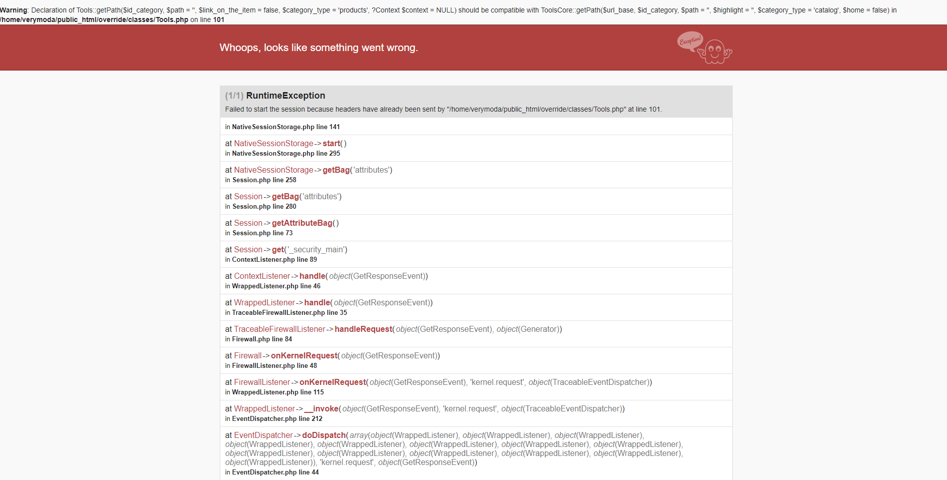

I am having issues accessing the module manager as well as the orders section of the PrestaShop, they result in 500 Errors.
After going into the debugger mode I get the following
I am updating from 1.5 to 1.7.6.4.

There is an override active causing the issue. You can (temporarily) deactivate it be renaming /overide/classes/Tools.php to /overide/classes/Tools.php.old - check the content of the file to see if any module installed it and contact the module developer to fix the issue (seem the module is not compatible with your version)
Thank you! Was able to comment this portion out and remove the module.
