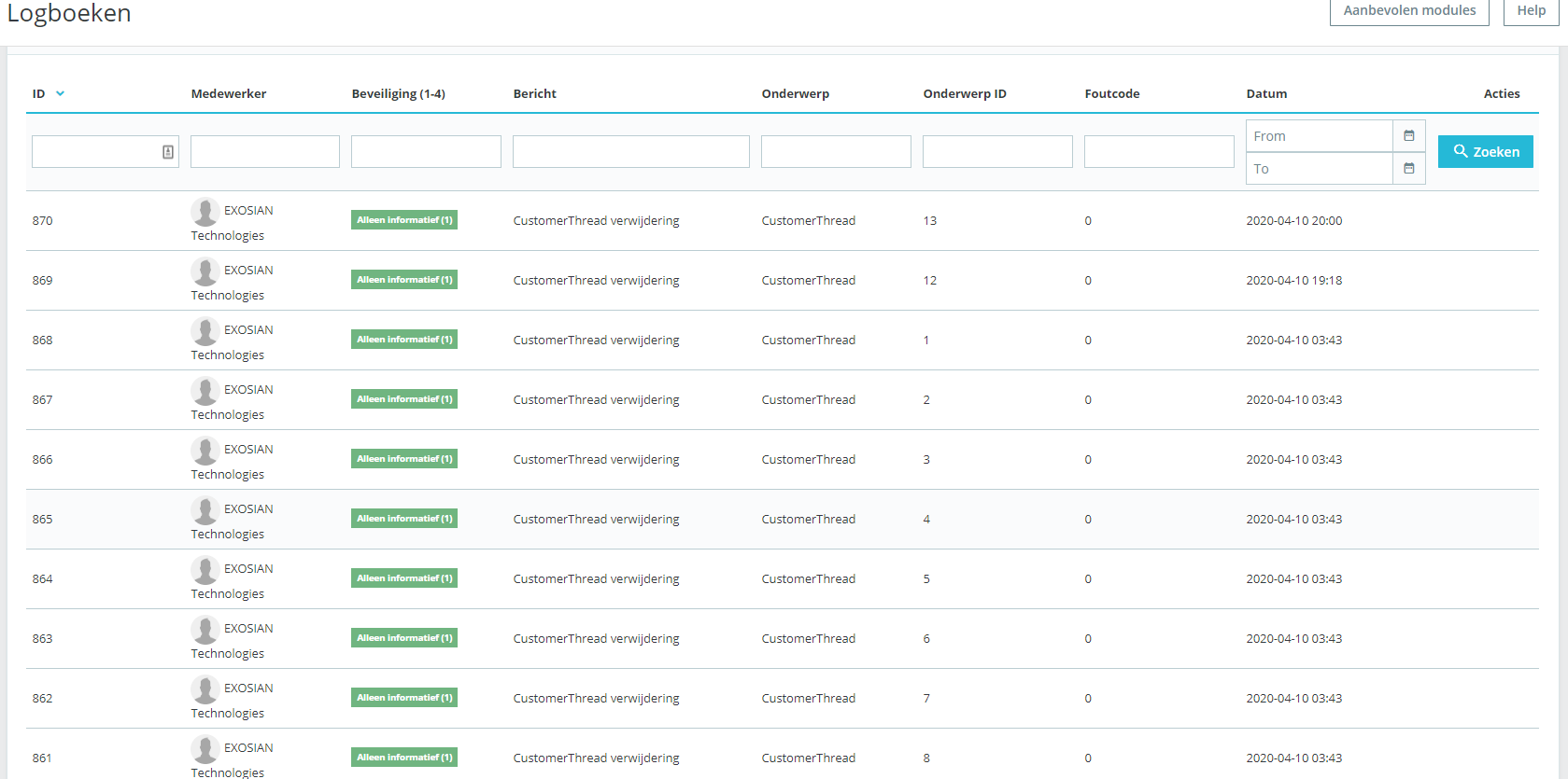

exosian Posted April 10, 2020 Author Share Posted April 10, 2020 I can only see lots of "CustomerThread removal". Can't click on them. Link to comment Share on other sites More sharing options...
Prescol Posted April 10, 2020 Share Posted April 10, 2020 With level 3? Link to comment Share on other sites More sharing options...

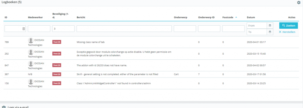

exosian Posted April 10, 2020 Author Share Posted April 10, 2020 Not sure what level is so I have attached a screenshot. On "Foutcode" (error code) everything is on "0". Link to comment Share on other sites More sharing options...
Prescol Posted April 10, 2020 Share Posted April 10, 2020 Just a little bit of the table there is a legend. The level we are looking for is the red one. Link to comment Share on other sites More sharing options...
exosian Posted April 10, 2020 Author Share Posted April 10, 2020 On 4/10/2020 at 6:45 PM, Prescol said: Just a little bit of the table there is a legend. The level we are looking for is the red one. Expand I've found only 5 errors. Nothing related to mail. Link to comment Share on other sites More sharing options...

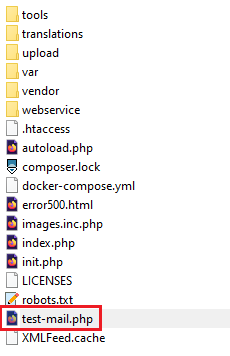

Guest Posted April 14, 2020 Share Posted April 14, 2020 Check if PHP mail function exists: Quote <?php if ( function_exists( 'mail' ) ) { echo 'mail() is available'; } else { echo 'mail() has been disabled'; } Expand Link to comment Share on other sites More sharing options...

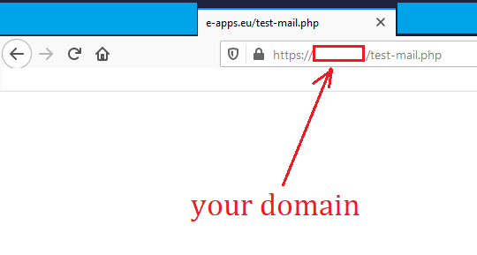

Guest Posted April 14, 2020 Share Posted April 14, 2020 (edited) Help for all who do not know if everything is properly set and enabled PHP mail () function on their webhost. 1. Save the attached test-mail.php file to the Prestashop main directory. Only registered and logged users can download the attachment. test-mail.phpFetching info... 2. Paste the address of the eshop and the file path into your browser. e.g: https://mydomain.com/test-mail.php 3. When everything is OK, you get the information as in the picture: 4. If there is an error somewhere, you will get an error message. You'll post this message here, but first read the thread to see if your problem is already resolved by chance. Edited April 14, 2020 by Guest (see edit history) Link to comment Share on other sites More sharing options...
finchy01 Posted April 14, 2020 Share Posted April 14, 2020 Thank you for this script. I get the following line printed. php function mail() is available and that is all - no errors are printed and there are no errors going to the console Link to comment Share on other sites More sharing options...

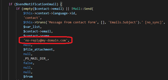

Roman Bittner Posted September 4, 2020 Share Posted September 4, 2020 After several hours I solved the problem - at least on my site. I have PS 1.7.6.7. I changed line 421 in /modules/contactform/contactform.php from: null, to: 'no-reply@my-domain.com', It changes the sender address from website address into another one. Of course, instead of 'no-reply@my-domain.com' use any valid email for your domain. It seems like if the website main email is the same as sender address, then the mail will not reach the mailbox, although no error is displayed or logged. Here is the fixed code within its context: Link to comment Share on other sites More sharing options...

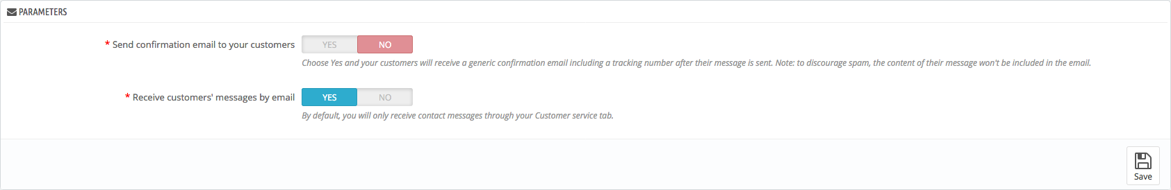

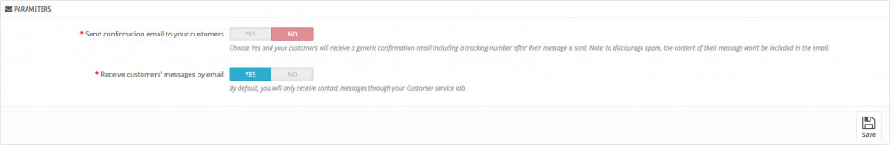

NetzCom Posted January 14, 2021 Share Posted January 14, 2021 First of all check Modules->Contact form->Configure , Receive customers' messages by email and choose yes. 1 Link to comment Share on other sites More sharing options...
Hassan.e Posted January 15, 2021 Share Posted January 15, 2021 Having the same issue and not yet resolved. The contactform module config both enabled. Link to comment Share on other sites More sharing options...

PPSA Posted February 10, 2023 Share Posted February 10, 2023 On 1/14/2021 at 9:08 AM, NetzCom said: First of all check Modules->Contact form->Configure , Receive customers' messages by email and choose yes. Expand My mails were working perfectly and an update must have disabled them Link to comment Share on other sites More sharing options...
