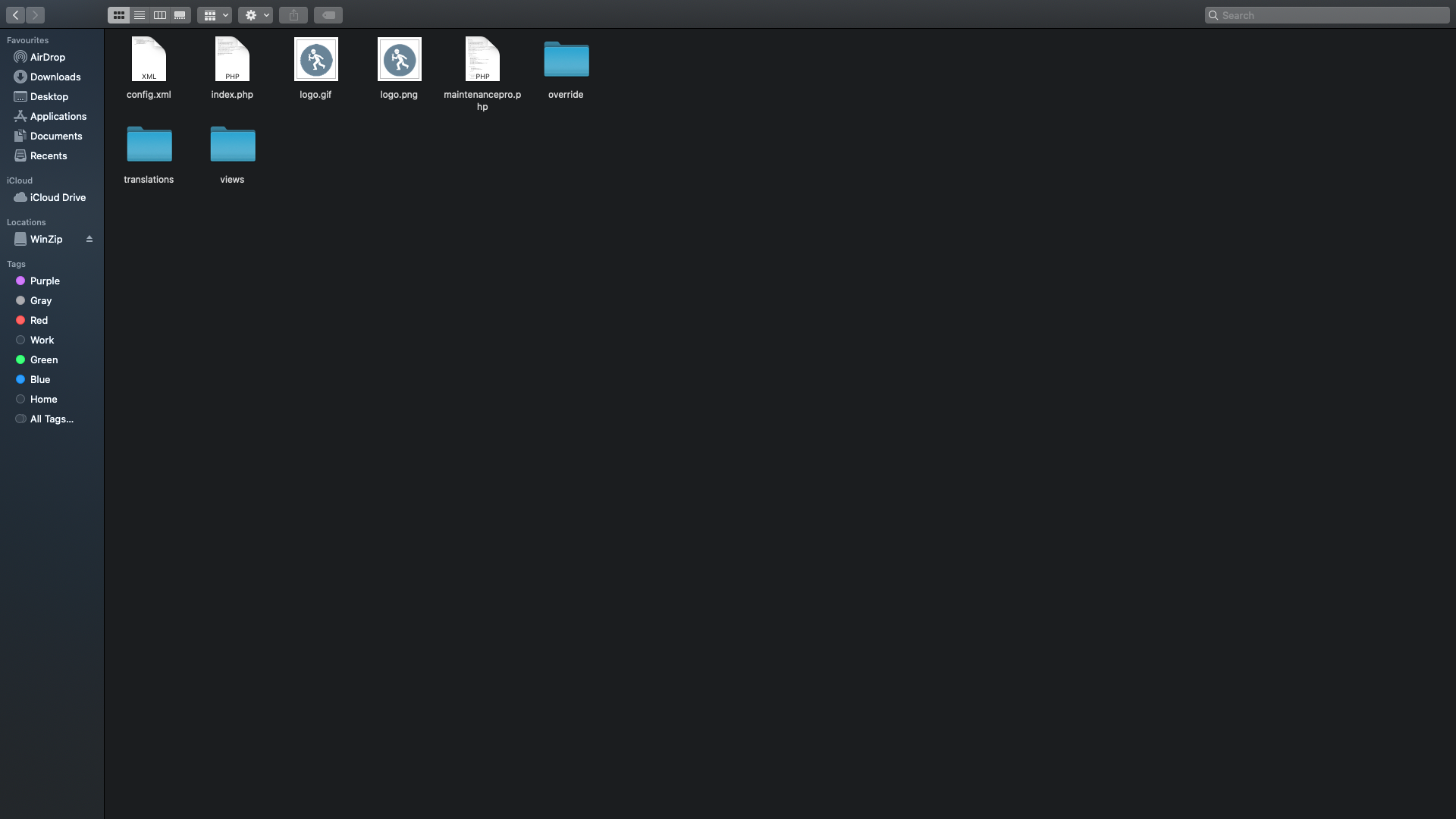

Thank you very much for your reply buddy. So the attached is what I'm working with.
OK so that on image is content of folder, which should be called "maintenancepro".
If you go up (back) from current screen you should see that folder.  Now you can compress
that folder to .zip file and upload as module into back office. Or alternative to copy that folder "maintenancepro"
into your modules folder so path from root looks modules /maintenancepro.
