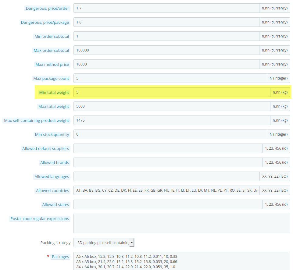

The 'Ship in 3D' -module lets you set minimum and maximum weight limit for a shipping method. In the attached screenshot the shipping method is only available if the shipment weight is between 5 and 500 kg. You can also set allowed countries, states and postal codes, so you can limit the free shipping to particular destinations. The module also offers many other additional shipping configuration settings not available otherwise.
For more info please see: https://addons.prestashop.com/en/shipping-carriers/48685-ship-in-3d.html
