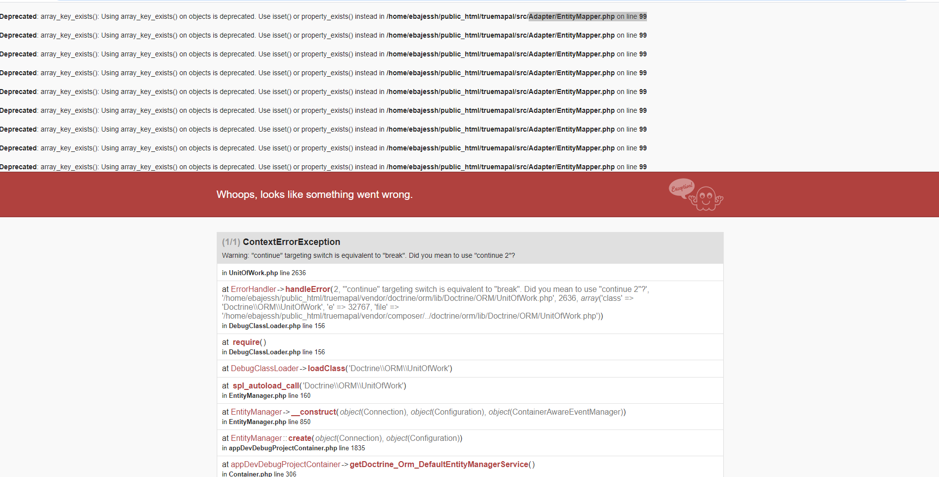

cematesh Posted February 28, 2020 Share Posted February 28, 2020 (edited) Deprecated: array_key_exists(): Using array_key_exists() on objects is deprecated. Use isset() or property_exists() instead in /home/hosting/webapps/outleto/src/Adapter/EntityMapper.php on line 99 and Unknown error on line 318 in file /home/hosting/webapps/outleto/classes/module/Module.php [8192] array_key_exists(): Using array_key_exists() on objects is deprecated. Use isset() or property_exists() instead After getting the debug mode, I cannot reach to performance page. I have noticed the problem when trying to translate some words on localization. The buttons were not clickable and the options were readable. So wanted to change to debug mode to see what's going on and the error is below.. PS. I am trying to upgrade my theme from 1.6 to 1.7 if it does help 😕 Any solution for that? Thanks in advance! Edited February 28, 2020 by cematesh (see edit history) Link to comment Share on other sites More sharing options...

[email protected] Posted July 2, 2020 Share Posted July 2, 2020 https://truemapal.com/admin123 I have and error when upgrade to 1.7.6.6 Link to comment Share on other sites More sharing options...
