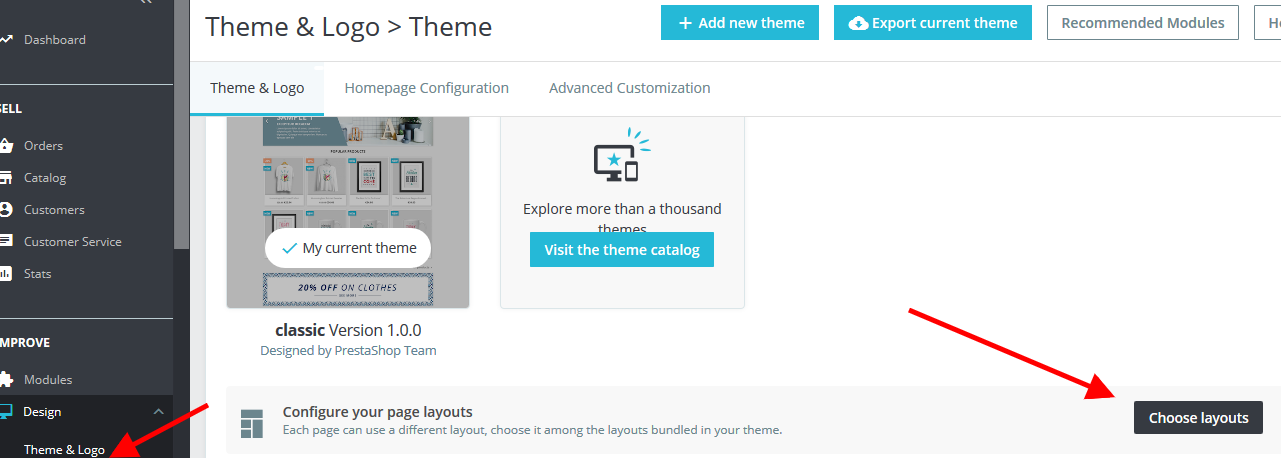

cahr Posted February 28, 2020 Share Posted February 28, 2020 How to make all products and categories as the home page? Just like on this page:https://hurtownia.heljos.info/ 1 Link to comment Share on other sites More sharing options...
Mr Rick Posted February 28, 2020 Share Posted February 28, 2020 You have to make the layout of home page 2 column left, see below when after clicking Choose layout select 2 column left layout for index page. 1 Link to comment Share on other sites More sharing options...
