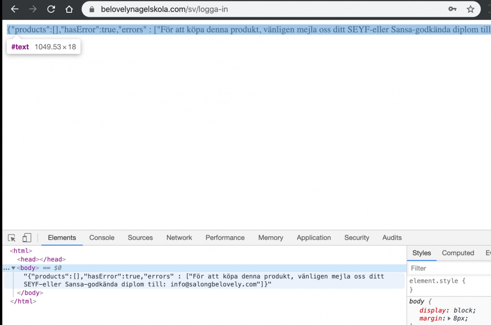

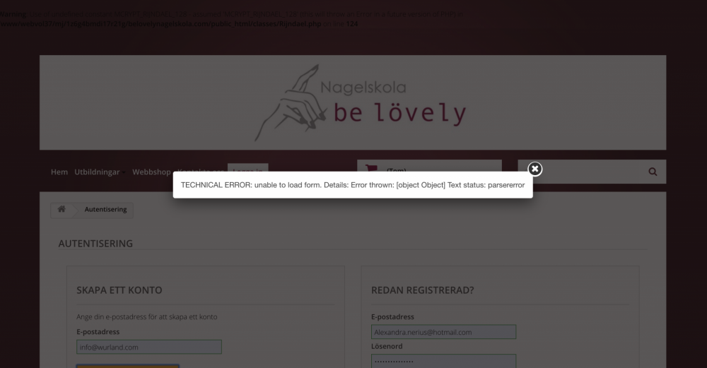

LudwigLindstrom Posted February 22, 2020 Share Posted February 22, 2020 Get this strange error when I sign up as a new customer as my shop. What have I done wrong and how can I fix it? The error attached is shown directly after I sign up as a new customer. The customer is created, so that works, but the error comes up. https://belovelynagelskola.com/ Thank you in advance! Link to comment Share on other sites More sharing options...

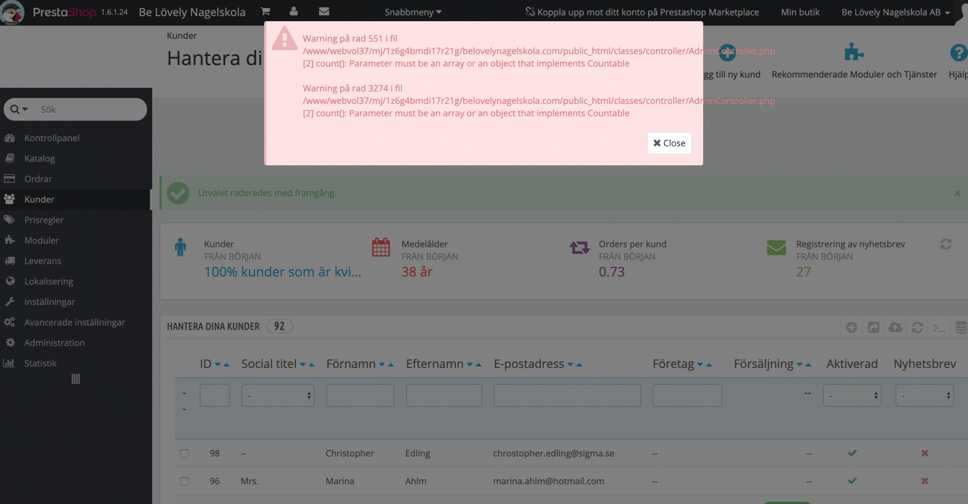

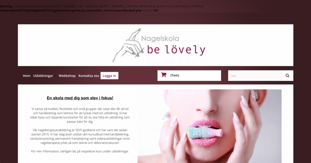

LudwigLindstrom Posted February 23, 2020 Author Share Posted February 23, 2020 46 minutes ago, ndiaga said: Hi, Here you just need to change the false to true. /* Debug only */ if (!defined('_PS_MODE_DEV_')) { define('_PS_MODE_DEV_', false); } //after change /* Debug only */ if (!defined('_PS_MODE_DEV_')) { define('_PS_MODE_DEV_', true); } Well ok, This gave me some errors. See below and attachments.Context: Running PHP 7.2 with the latest Prestashop 1.6.1.24This appear on the front page Warning: Use of undefined constant MCRYPT_RIJNDAEL_128 - assumed 'MCRYPT_RIJNDAEL_128' (this will throw an Error in a future version of PHP) in /www/webvol37/mj/1z6g4bmdi17r21g/belovelynagelskola.com/public_html/classes/Rijndael.php on line 124 Warning: Use of undefined constant MCRYPT_RIJNDAEL_128 - assumed 'MCRYPT_RIJNDAEL_128' (this will throw an Error in a future version of PHP) in /www/webvol37/mj/1z6g4bmdi17r21g/belovelynagelskola.com/public_html/classes/Rijndael.php on line 124 This appear when I log in to the admin Warning på rad 551 i fil /www/webvol37/mj/1z6g4bmdi17r21g/belovelynagelskola.com/public_html/classes/controller/AdminController.php [2] count(): Parameter must be an array or an object that implements Countable This error appears now when I try to sign up a new account TECHNICAL ERROR: unable to load form. Details: Error thrown: [object Object] Text status: parsererror --- Want you to know that I am very grateful for your help in this matter. Link to comment Share on other sites More sharing options...
LudwigLindstrom Posted February 23, 2020 Author Share Posted February 23, 2020 5 minutes ago, ndiaga said: Ok, I see . It seems that your PHP version is not compatible with the PrestaShop version you are using. Please refer to this topic : Hmm ok! The problem is that I can't downgrade to more than 7.2, on my web server, which I am running today. Or do I need to upgrade to PS 1.7 in order for everything to work? That's a big step what I can see. It's a complete new version. Link to comment Share on other sites More sharing options...
