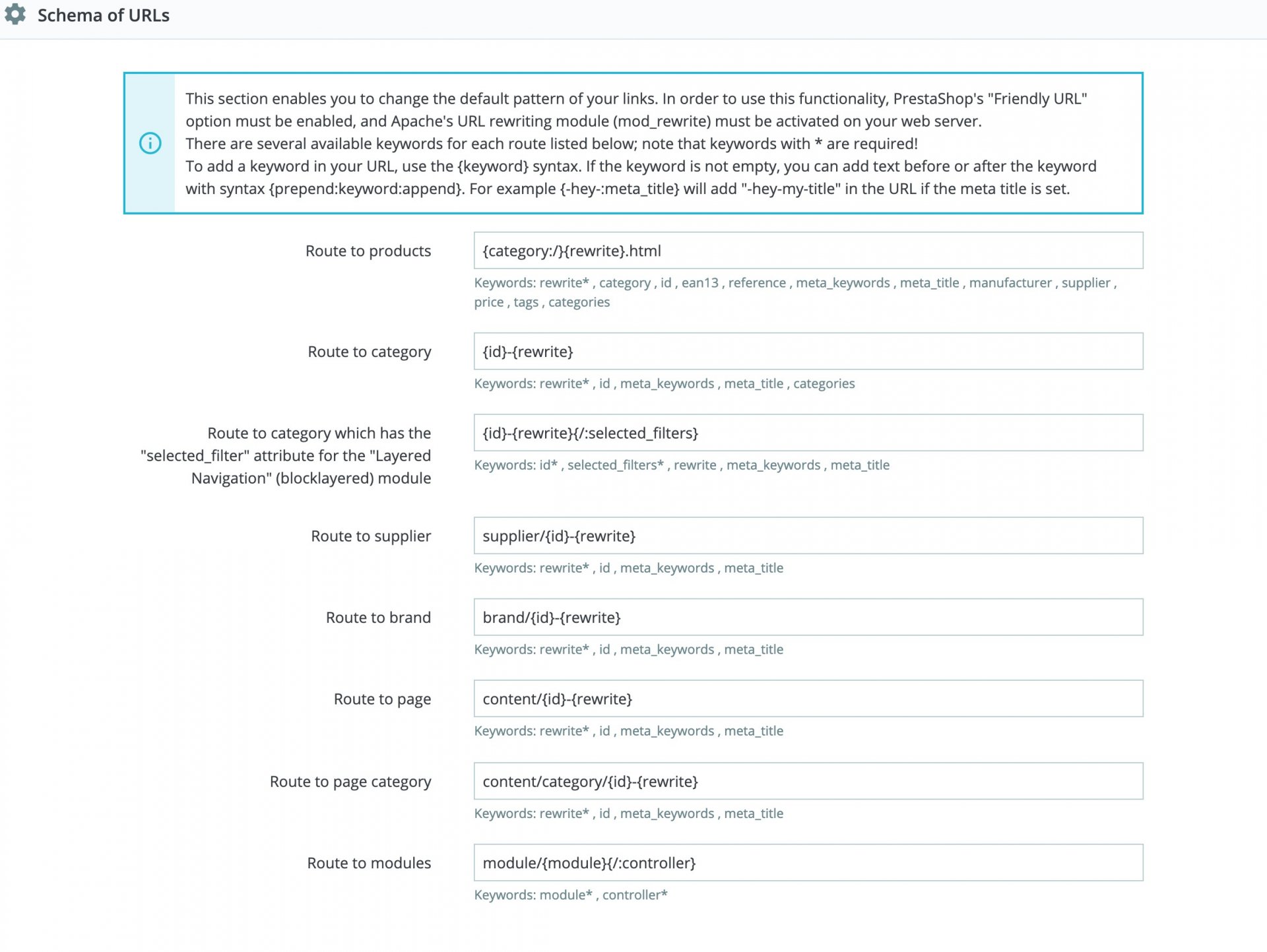

Mr Rick Posted February 25, 2020 Share Posted February 25, 2020 Hi Ana, Can you share the schema of urls with us, see below for example. https://nimb.ws/wmOfaN Link to comment Share on other sites More sharing options...

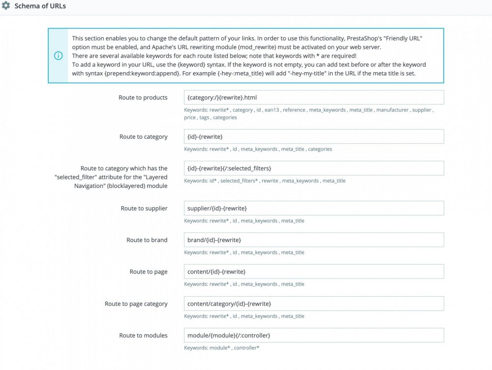

myhappyidea Posted February 25, 2020 Author Share Posted February 25, 2020 Sure! Link to comment Share on other sites More sharing options...
Mr Rick Posted February 25, 2020 Share Posted February 25, 2020 It looks like you are using a module to modify URLs or might be just a customization as default Prestashop doesn't allow product route without {id} parameter because its mandatory. See if you have an override in /override/classes/Dispatcher.php Link to comment Share on other sites More sharing options...
myhappyidea Posted February 27, 2020 Author Share Posted February 27, 2020 None, there isn't even Dispatcher.php in that folder Link to comment Share on other sites More sharing options...
Mr Rick Posted February 27, 2020 Share Posted February 27, 2020 You should put back the {id} parameter to get correct behavior. Link to comment Share on other sites More sharing options...
