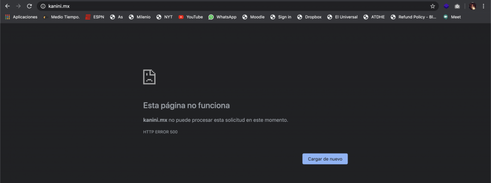

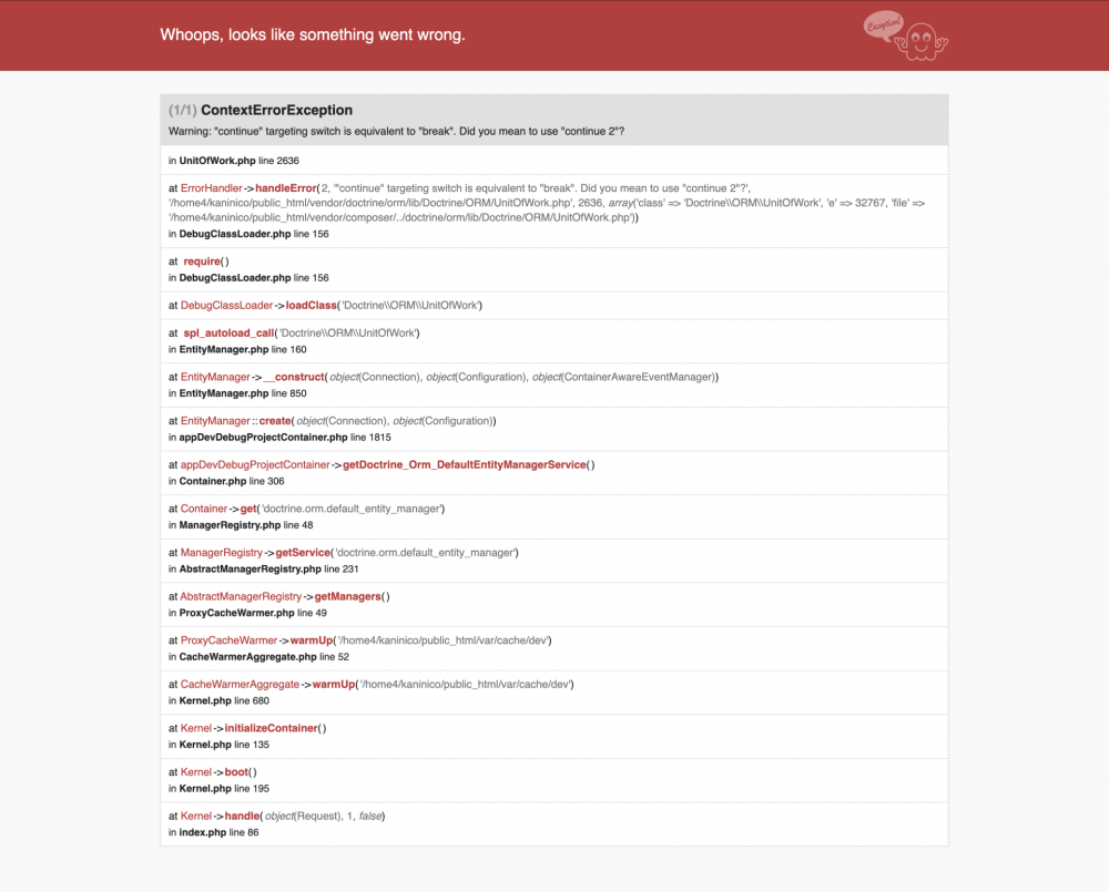

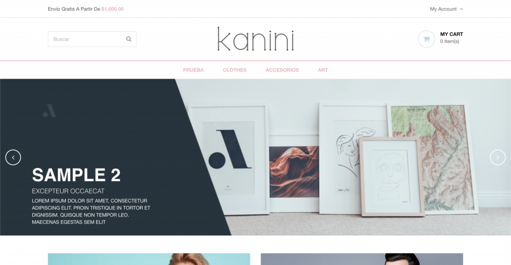

EliasHM Posted February 19, 2020 Share Posted February 19, 2020 Hey guys, I'm trying to migrate my shop from local to an external server, but i keep getting 500 error. I followed the subsequent tutorials in order to complete the process: 1.- https://www.prestashop.com/forums/topic/603281-ps-1706-how-to-transfer-ps-17-from-localhost-to-server/ (where I got step by step how to proceed) 2.- https://www.sunnytoo.com/8148/how-to-transfer-or-move-prestashop-1-7-site-to-new-server (Based on this tutorial i learned to change the old addresses to the new one on the db. 3.- https://hostadvice.com/how-to/how-to-migrate-a-prestashop-site-from-local-host-to-live-server/ (Finally on this one to change the “.htaccess”.) My localhost was on MAMP, just in order to create a reference if needed, but I still get 500 error. When i do the debug control, changing this line "define('_PS_MODE_DEV_', false)" for true in the config/defines.inc.php file, my website frontend seems to work just fine, missing some pictures, but the backend not. At this point really don't know what to do! Can anyone know a possible solution? Thanks guys Link to comment Share on other sites More sharing options...
JBW Posted February 19, 2020 Share Posted February 19, 2020 Whats your PHP Version? Please note the Prestashop is compatioble only up to 7.2 . Have you deleted /var/cache after/before coping files? Link to comment Share on other sites More sharing options...
EliasHM Posted February 19, 2020 Author Share Posted February 19, 2020 3 hours ago, JBW said: Whats your PHP Version? Please note the Prestashop is compatioble only up to 7.2 . Have you deleted /var/cache after/before coping files? Thanks JBW for the answer. My PHP version 7.3.14, now we have brought it down to 7.2.27 But still ain't working. No, I haven't deleted the var/cache folder. Should I delete the entire folder? Or the var/cache/dev || var/cache/prod || var/cache/.DS_store? Link to comment Share on other sites More sharing options...
JBW Posted February 19, 2020 Share Posted February 19, 2020 5 hours ago, EliasHM said: My PHP version 7.3.14, now we have brought it down to 7.2.27 It should have solved the error message, did it? 5 hours ago, EliasHM said: No, I haven't deleted the var/cache folder. Should I delete the entire folder? Or the var/cache/dev || var/cache/prod || var/cache/.DS_store? You can delete complete cache folder, it will be regenerated at next page call. To be on safe side you can rename it to cache_old first Link to comment Share on other sites More sharing options...
