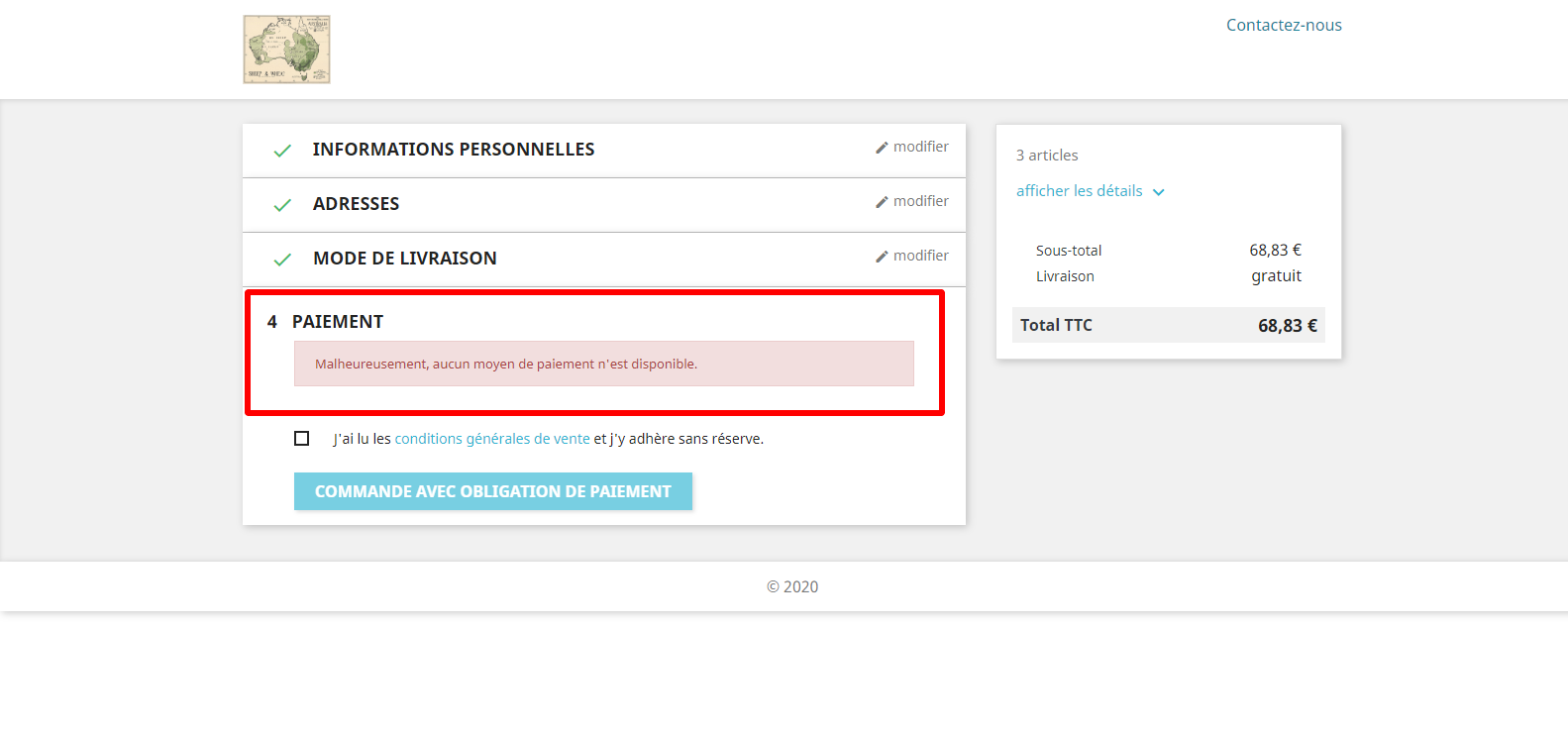

I have a site setup with three shops.  The first is in catalogue mode whilst the two subsites ready to go.

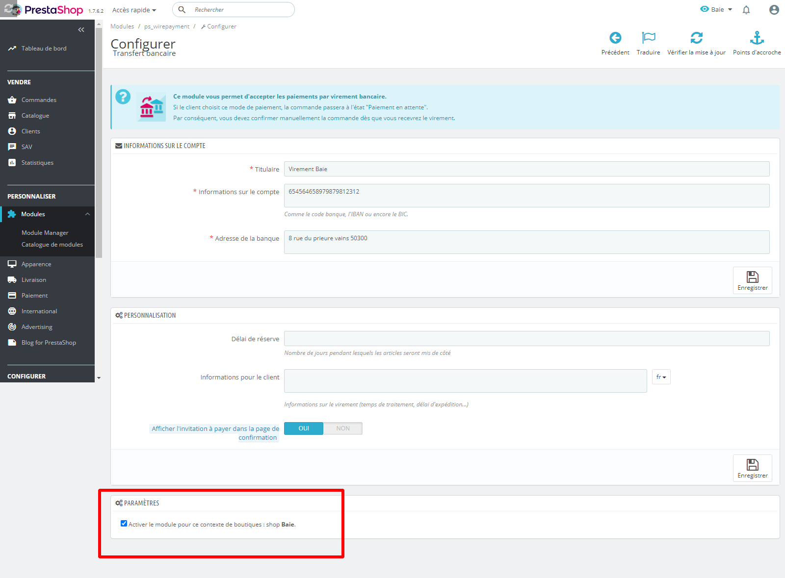

I have configured for all three (despite the first being catalogue) both the payment by check and the payment by transfer modules.  They all appear (whilst in the admin for each shop) under the list of active payment modules.  Each one has different informations for their configuration and each one ihas the box checked under parameters to be assigned to that particular shop (see image module manager).

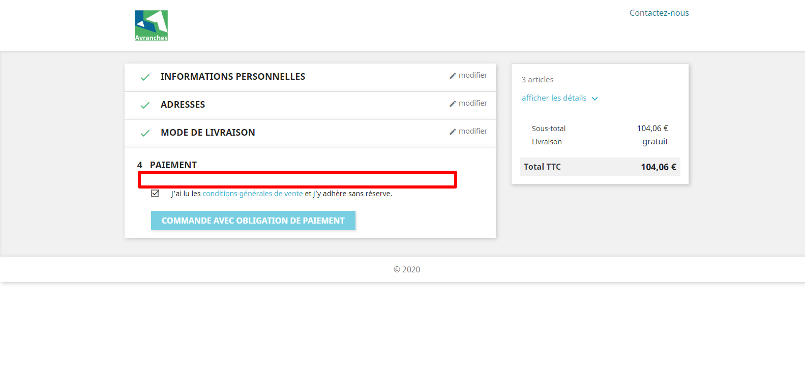

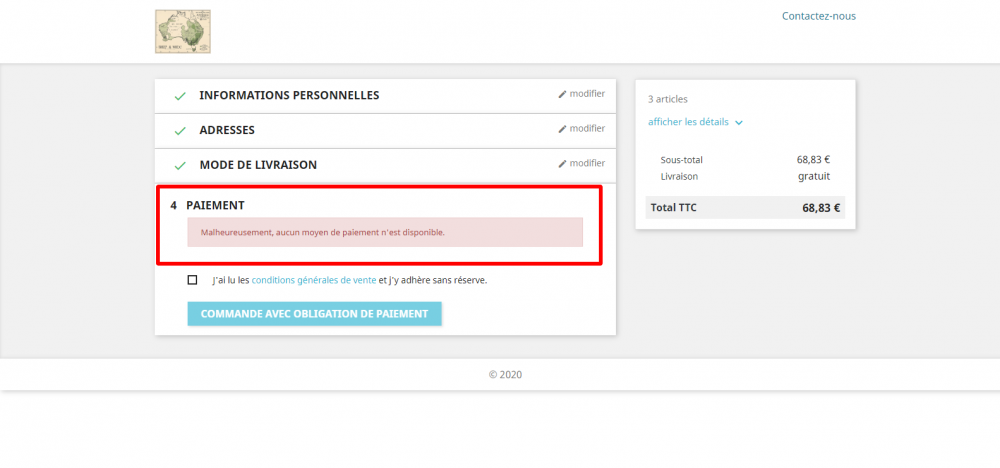

On the front end, upon going through the process of checkout,  eerything is fine on both shops until payment whereby on one I get a "sorry no payment options are available" error message (image2)  and on the other shop no options, no error message and no possibility of advancing (image3).   All the shops have SSL active although I doubt this should have an impact given the nature of the payment options.
Any help in defining why this is happening would be greatly appreciated....

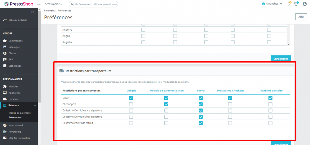

Ok so this has just been self solved......
What hadn't been adjusted was the preferences of the payment modules and their restrictions by transporter per shop.
if this can eventually help anyone here is a screenshot :
