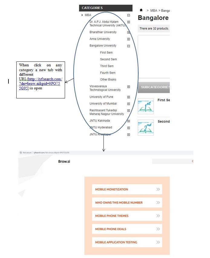

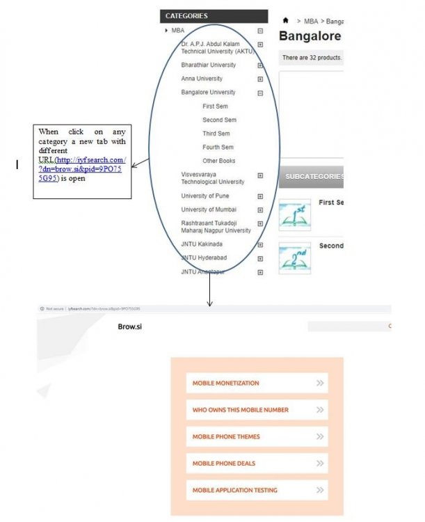

Pravesh Singh Posted February 14, 2020 Share Posted February 14, 2020 Hi, My website URL is tppl.org.in. when i clicked on any of the category then it open a new tab also with different URL (http://iyfsearch.com/?dn=brow.si&pid=9PO755G95). Mostly this will happen when a category is clicked first. Please help. Link to comment Share on other sites More sharing options...

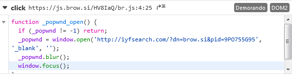

Luis C Posted February 14, 2020 Share Posted February 14, 2020 You should check your Prestashop installation for any suspicious module, because there IS an external js file capturing clicks from the DOM and opening a new window with that specific URL (Looks like an affiliate link) If you haven't installed such a module you should perform a backup ASAP, and probably get a freshly installed Prestashop running. (Also, if you haven't installed a module with that behaviour I'd advise you to check access logs, change passwords and even ask your service provider for help if needed) If you downloaded a theme / module / or even a prestahop copy from a suspicious website, that code might have already been there from the beginning. Link to comment Share on other sites More sharing options...
