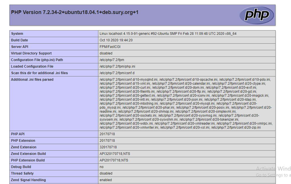

Guest Posted October 14, 2020 Share Posted October 14, 2020 It was 7.3, if i remember it right. Following T400 instructions it was solved. Are you absolutely sure about your version? Have you tried a phpinfo? Link to comment Share on other sites More sharing options...
Shwetab55 Posted October 14, 2020 Share Posted October 14, 2020 Yes, I'm sure, also checked in the phpinfo. Link to comment Share on other sites More sharing options...

Shwetab55 Posted October 15, 2020 Share Posted October 15, 2020 I'm already using php 7.2 I think server configuration is fine. Server information Linux #92-Ubuntu SMP Fri Feb 28 11:09:48 UTC 2020 x86_64 Server software version: Apache/2.4.29 (Ubuntu) PHP version: 7.2.34-2+ubuntu18.04.1+deb.sury.org+1 MySQL version: 5.7.29-0ubuntu0.18.04.1-log Link to comment Share on other sites More sharing options...
